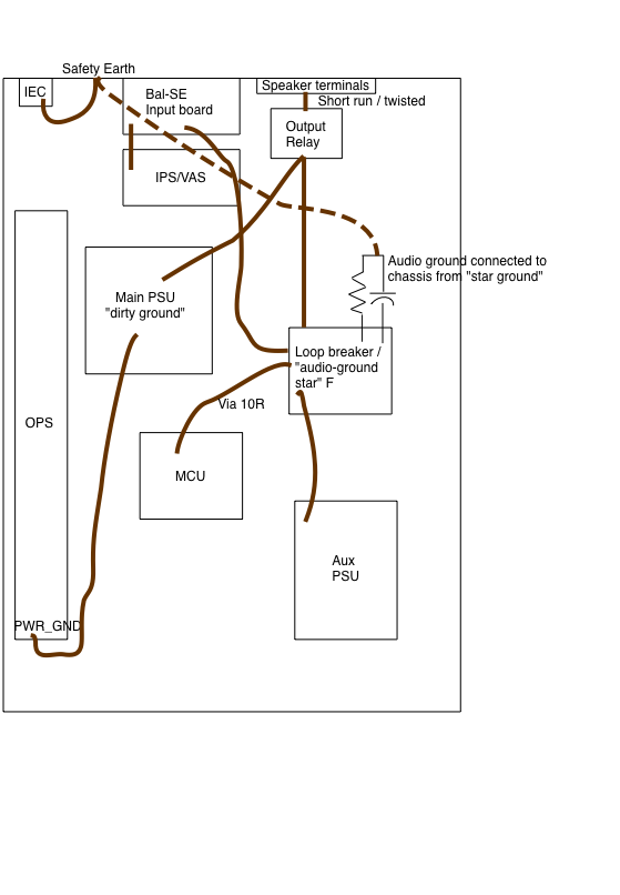

If the amplifier is on a different PCB than the power supply, there should be more than one "ground" wires between the amp PCB and the star ground. Have a look at Figure 45 (page 41) of the Akitika GT-101 assembly manual. It's a well thought out star-on-star arrangement. GT-101 is also a single-supply amplifier: VCC and GND but no VEE. Don't let that distract you.
If I recall correctly, this is the "ground" wiring of my SA2014 amp build (one channel) - designed by diyAudio member astx.
OPS is separate board from IPS/VAS. OPS bypassing etc to "PWR_GND" and returned to Main PSU. Bal-SE conversion board signal and ground ("signal ground") connected to IPS/VAS board via coax. Thick wire from this Signal GND on Bal-SE converter board to (dual channel) "silent ground / loop breaker board".
Speaker return comes to output relay board "ground". Output relay board "ground" connected to silent ground / loop breaker board and to Main PSU (PWR_GND) where main currents flow.
Housekeeping MCU connected to silent ground / loop breaker board via 10R (actually 2 wires via 22R for two channels - one to left silent GND and other to right silent GND). Aux PSU GND to loop breaker board as well. (I have often thought the latter should be via 10R for isolation.)
Silent ground / loop breaker connects to chassis via 10R/0.1uF RC network.
(One thing I debated with Toni/astx is that the signal ground connection to chassis is via the loop breaker / silent ground board. I understood that self recommends that this connection be done directly at the input connector / board.)

maybe useful to this thread:
yes a "star", by itself, is exactly a "too simple" idea
hierarchical grounding, "dirty"/"clean" branch separation are important ideas too
and like DF says - CT to reservoir cap junction is "dirty" - has rectified charging current pulsing in the wire, creating nasty nonlinear Vdrop in its R,L
the mains xfmr secondary is floating, the isolation should be taken advantage of by letting it be an "open" end of the dirty current branch
at the very least the location of the "star" point can be chosen for better or worse performance - and worse would be the xfmr CT

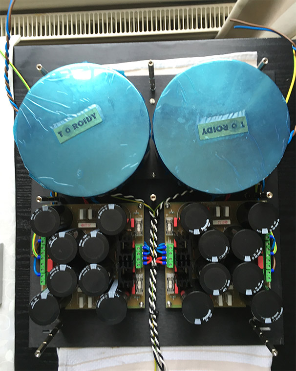

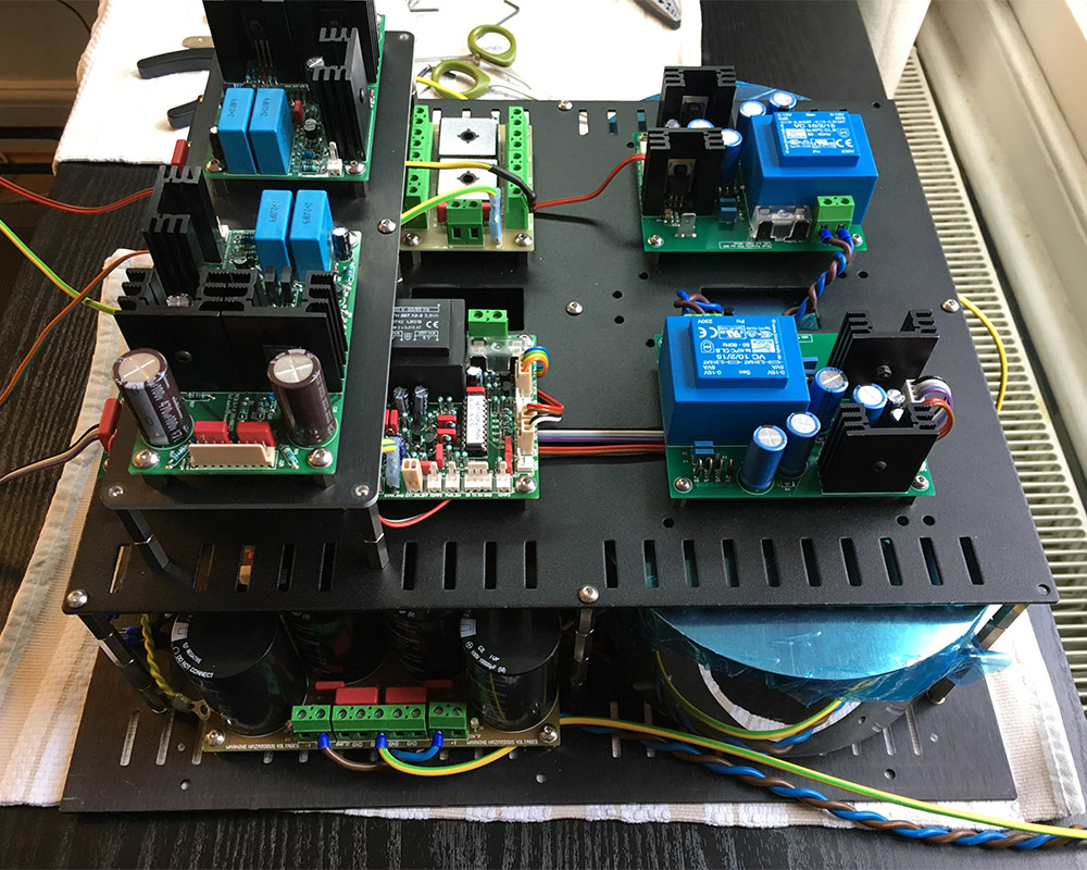

Ok understood. The idea behind my tinkering is to look at a relatively versatile supply that can supply a single channel's +ve and -ve rails at full rated power continuously or, if needed but not preferred, supply more than one channel. When I implemented astx's SA2014 200W 8R/400 4R amplifier I used his supply boards (and BoM), one supply for each channel (a dual mono block implementation within one enclosure). (I have attached a couple of pics of the early build stages.) His supply design uses 4 diodes to produce both +ve and -ve rails, i.e. in similar fashion to your RingNot PSU. With my question I was trying to get a sense as to whether people felt the extra four diodes were worth the space and hassle.

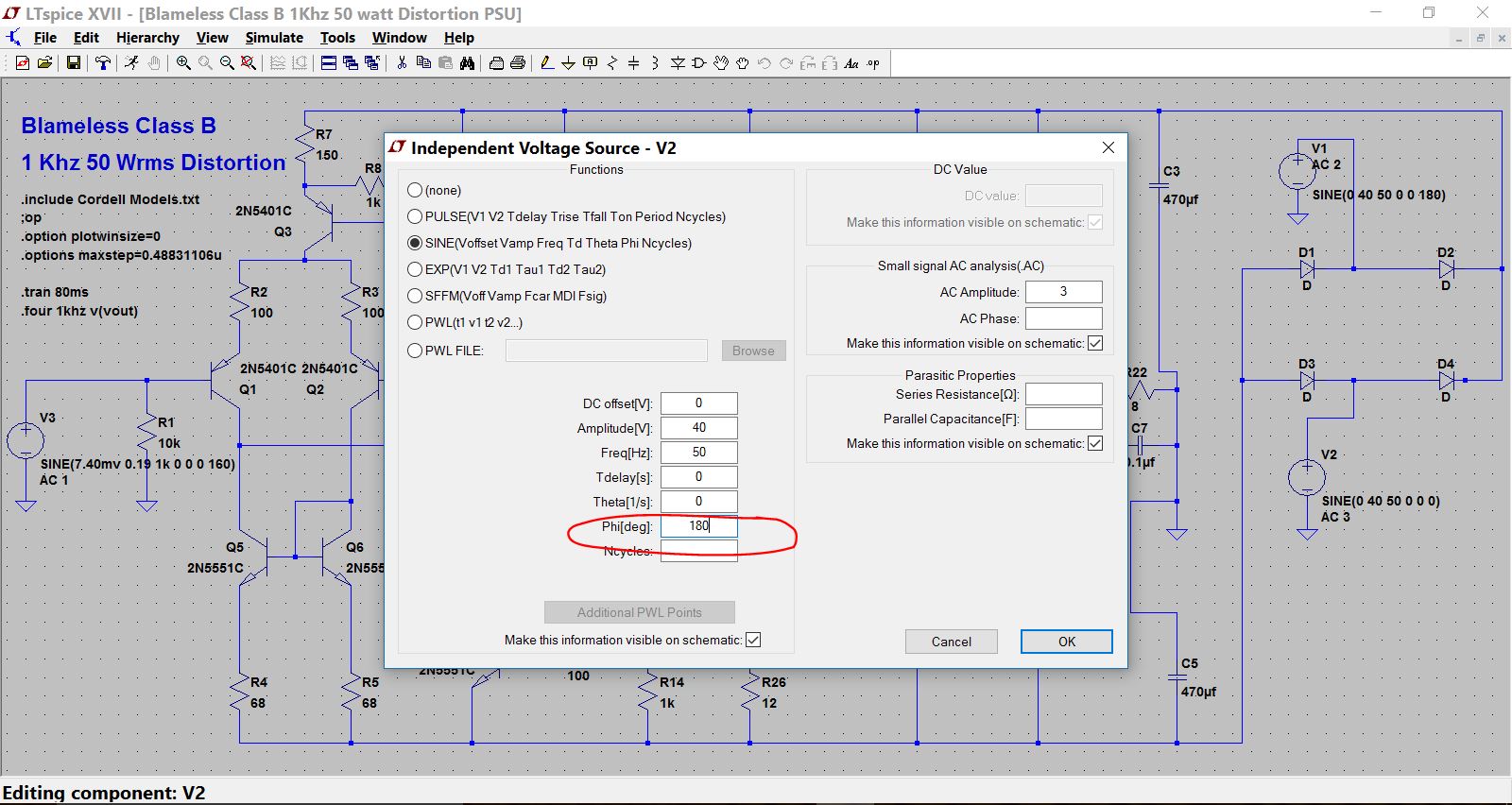

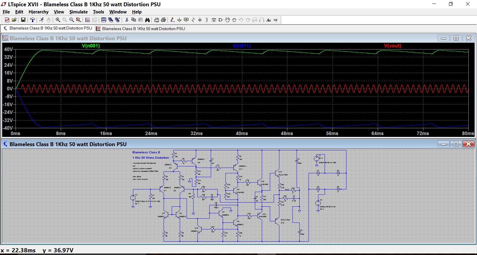

Beware - there is a problem wih Mooly's simulation
Have a look at this I cobbled together. Proper PSU (you would add any series resistance needed) and very small reservoir caps.
After a long time ...
The connection between the negative voltage source and rectifier bridge is incorrect. This is what is causing the large transient at the start of the simulation and poor performance.

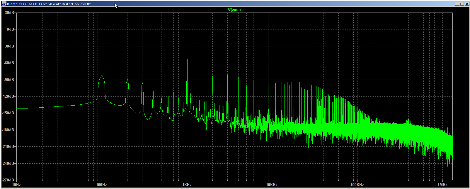

I modified the simulation to model a 160VA, 9% regulation 2x25V transformer and fixed the connection to the rectifiers. The results look much better.
See the attachments for spice screen and FFT when operating at 50W.

> incorrect
Took a while to see what you meant.
I see the two "transformer windings" are IN-phase. (A CT winding, the two ends are normally out-of-phase.) Yes, this works as two half-wave rectifiers, which is clearly not what Mooly was thinking.
........... which is clearly not what Mooly was thinking.
Maybe Mooly wasn't thinking clearly 😉 It was just thrown together.
Tibouchina is correct. If you look at the ripple in a real dual rail supply then both halves mirror each other. I should have added a '180 degree' option to either of the voltage sources. Apologies for that.

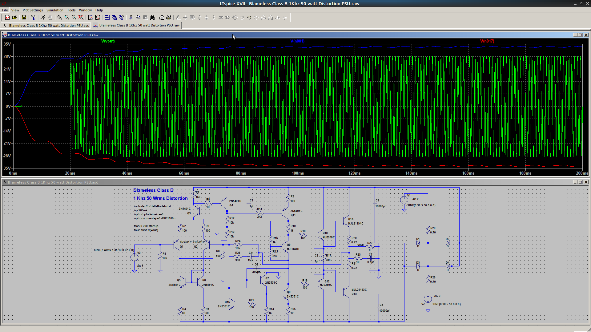

It's a good idea
The basic idea is good (I tend to complicate things too much). It can be used to check the drop in rail voltages under load. The FFT shows a 100 Hz hum component about 110 dB down on 1 KHz tone at 50 W output.
I'm using the model with an Elliot P3A amp. It seems to match reality quite well. Have some more transformers coming in from local manufacturer Tortech. Want to do some measurements and improve the spice transformer model I plan to use.
One interesting thing to look for is a 100 Hz modulation of output audio when amp is clipping. I assume that wouldn't sound very good.

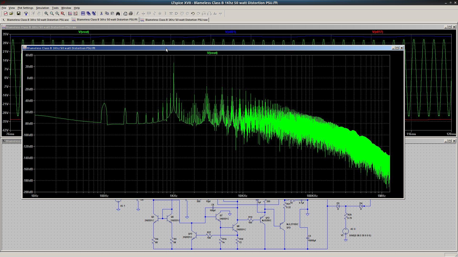

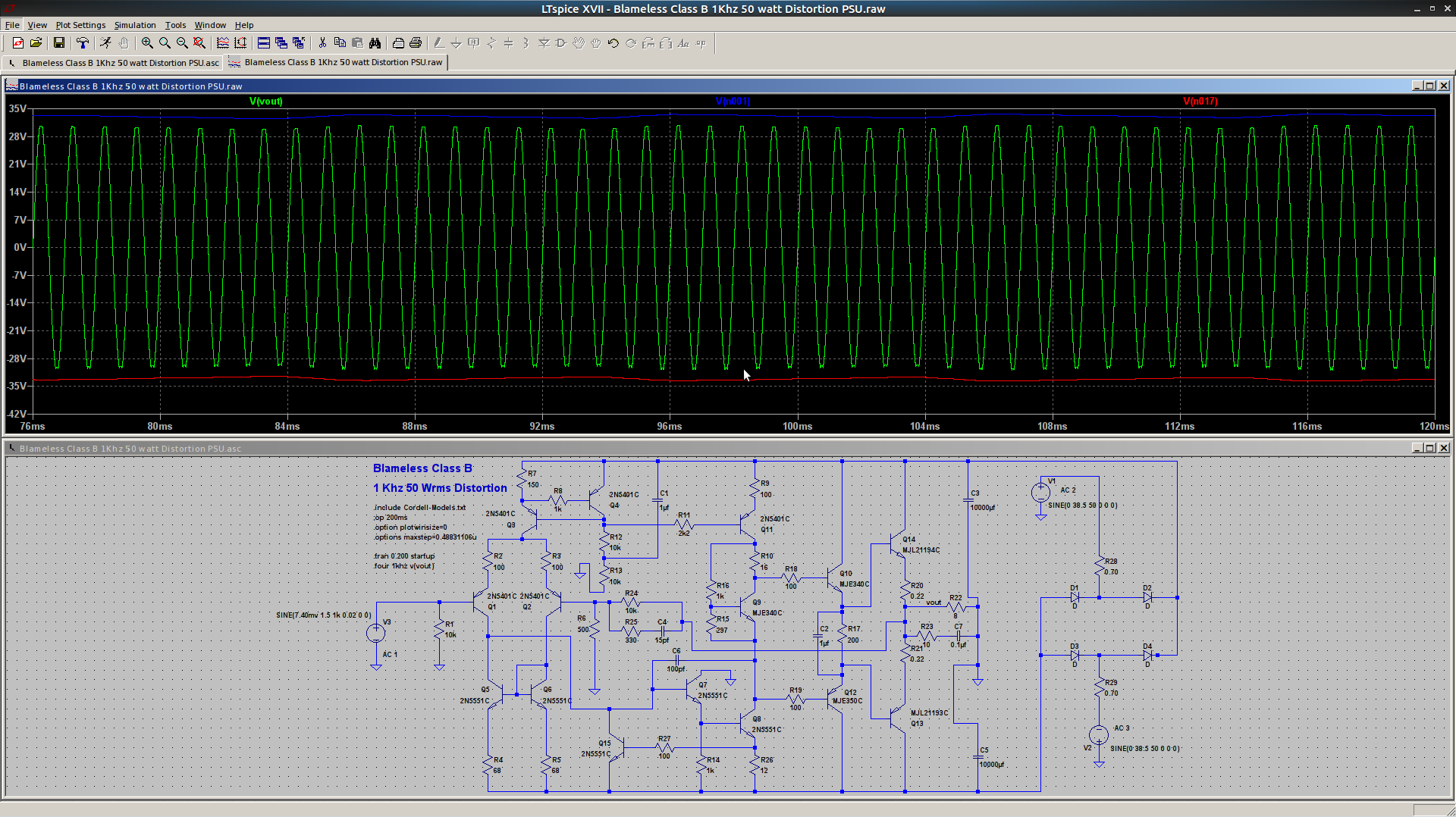

Amplifier clipping behaviour with Mooly's PSU Model
Try attaching your pictures directly. They just show as page not found 🙂
Well hopefully this will work.
When the amplifier is driven into clipping, the output waveform is amplitude modulated with a 100 Hz signal. This comes from the ripple on the rails. See the attached spice simulation results.
The FFT shows the 100 Hz ripple on the output has increased significantly and there are many intermodulation products. Does this mean the clipping will sound worse than if a regulated power supply was used? Don't know! Guess I'll have to do some real listening tests.
Another another concern is what happens when two amplifiers are attached to a common unregulated supply? There must be an interaction between the amplifiers.
