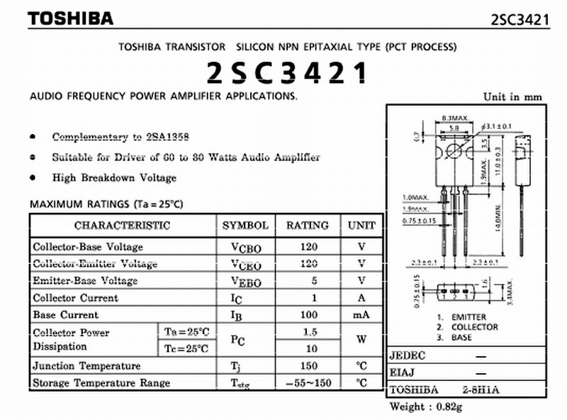

Reichelt has them both, the 2sa1358 and 2sc3421.
Mike
Yes - they have a minimum order and this is not very good but I think that it will be o.k.
thanks for the info - and best regards

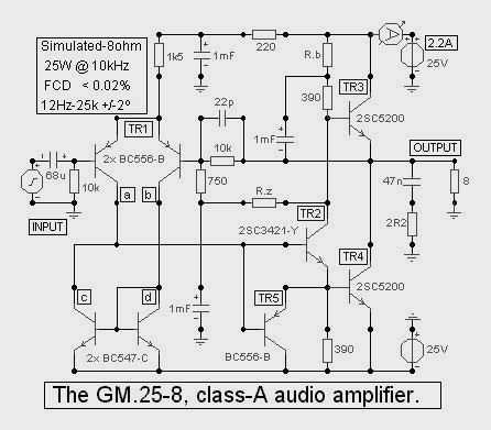

Friends are sending messages asking for 25W GEM
Here is the link:
http://www.diyaudio.com/forums/showthread.php?postid=467170#post467170
The schematic is attached.

This one has not so good speed, but can do a reasonable work as drivers and output.
If you decide to use this one, i suggest you to assemble at least three units in parallell, having 2,2 ohms stop resistor to each base and 0.33 ohms resistors to each emitter.
This way, you will produce a nice power transistor, and having around 150 of gain, 18 amperes for 3 units, and around 200 watts heat dissipation.
The problem is that will work fine till 3 Megahertz, but, when using it to low voltage output amplifiers, the slew rate will not create too much problem...as to go from zero to 20 volts will not delay too much.
The advantage is the price and because is easy to find.
Have to consider the increase of capacitances when parallelling those units.
I made one 25W GEM with those transistors and result very nice, i tried also AKSA with them, and worked nice too.
So good as Sankens?...NO NO NO!
But you will buy three for a dollar...very interesting 200 watts for a dollar!

I have to tell you that i have no inductors in my speaker crossover. (maybe a little easier to drive)
I will go for your GM amplifier with +-30v on rails.
I want to use these transistors if you think the result will be good because i already have these parts: MJ15003-4 MJE181-182 MPSA06-56. If you think as the designer of this amp. that they will not do the job, i will try to have the ones on the schematic.
Is there values to change because of the lower voltage?
If i use these TO-3, i will have 2.5 to 5 centimeter of wiring between the heatsinks and the board: is this a problem?
I see that the input is a low 600 ohm approx. with input filtering.
Can i go up with input resistor and omit the 2x100 ohm resistors and the 2x220pf caps? I feed the amp directly with the cd player because it have vol control but 600 ohm will be a little low.(must fit a buffer)
The big electrolytic cap is really necessary? (only asking:who am i to criticize your design) because it is difficult to have this part very good.

Hi Carlos,
Yes indeed I will appear as soon as possible. Smiling too!
Hi Dragon2,
Sorry for delay, I needed a clear 'thinking' head to answer your questions.
I cannot understand why you should have any problem with high efficiency speakers.
As long as they can take the output there should not be any worries.
The later version of the JLH had direct coupling. This improved the phase response and the cone damping at low frequencies. The original could sound softer in the bass because of the capacitors, though you might not be able to measure much of a difference in sine amplitude at output. The 'softer' bass can appear to make the mid-range sound smoother, but the overall sound, whilst easier on the ear, is not actually correct.
No inductors. That can be fine. Maybe just a series C to the upper driver for it to take over when the lower one rolls off.
My suggestion about using transistors is to try them because you have nothing to lose.
The circuit should operate well with really old transistor types, just as long as your VAS and drivers are much faster (higher transition frequency) than the outputs.
The 5cm distance I suggest is between VAS, Zobel and output device/wiring.
I am not sure what length of wire Carlos has to his output devices but he has success with wires that are not short, though he does take them out sideways and keeps them away from the input stage.
I would not suggest changing the input resistors and capacitors. Try it as it is first. The Cs are to help filter out digital noise and RF.
What is the output impedance of your CD player ?
If it has a volume control is it not already buffered ?
It is likely to have enough voltage output for you to put a resistor of say another 680 ohms between player and amplifier to reduce player loading.
Big capacitor ? I presume you mean the feedback capacitor. The big value here contributes to amplifier stability when input frequencies are lower than those we can hear; and modern CD recordings do go lower than the frequencies we can hear, so we do not want any phase distortion intrusion upon the bass we do hear.
(Re Electronics World. I have notes for intended Parts 7 + 8, but they did not make the agreed donation to charity so I am not writing any more for them. I will send in a final letter though.
This amplifier came from findings in that writing, and further optimisation might not be impossible, like choice of capacitor manufacturer and aspects like that, but apart from this thread, I cannot presently do more!)
Cheers .......... Graham.

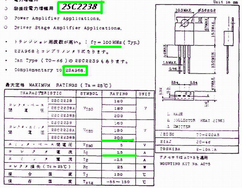

Regarding transistor subs; how about mjl3281/1302 for the outputs? The one possible issue is that the output cap. is about double that of 2sc3281/2sa1943. If I build it I think I can get the spec'd transistors, just curious.

I will build the GM amp with the transistors numbers i have and i will give you a feedback (it will take a moment...)
The big cap value is the feedback cap and i have had the idea to replace it by a wire to have better bass. What do you think on that? (needless to explain that i will have to adjust the dc offset if you think a can do that)
My speaker system is adjusted just like you have guessed: a big woofer direct coupled to the amp and when the level go down, the midrange come on and so for the tweeter.
I use very good drivers. (I think...)
My CD layer use the usual output buffer ( I have replaced the original IC for an AD826)
The vol control is in the digital circuit. Yamaha CDX1110U
I think that 600 ohm will be a little low. It will need a buffer.
