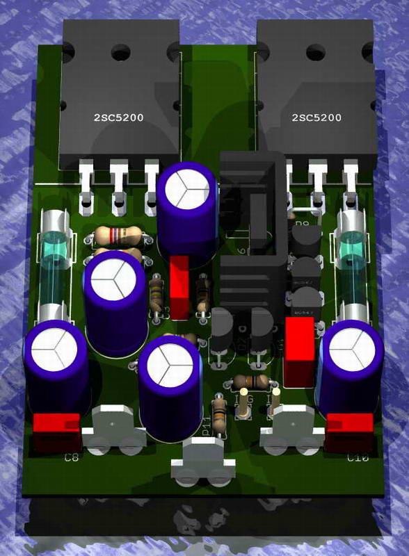

Here is, an artistic view, from the board designed by Greg Ekstine
See the beautifull work he done.
This circuit is the 25W Graham, already published design, the one that was also published in a famous Electronics Magazine.
ahahahaha!...those metalic supply posts, the flat pins are Aksa design!

Hi Carlos,
Yes, Greg's pcb has excellent potential.
It has a central star earth right at the input transistors, and if the VAS, output wiring and Zobel components are kept away from the input, it would be a good basis for the development of a GEM pcb.
I would not be up to doing that myself. The last pcb I made was a batch for sub-miniature TENS units about 15 years ago. Been using stripboard since then.

Thank you for the feedback Graham. Much appreciated and informative.
I was trying to produce a single PCB so that a variety of readers could try the design out. However I understand why this would compromise the end product and therefore I will change the layout as suggested.
Regarding the second input connector is it connected directly to the first or does it have it's own input filter? A great idea by the way.
If anyone has any other requirements please advise soon.

You could work backwards from the terminal pins of Greg's illustrated pcb.
