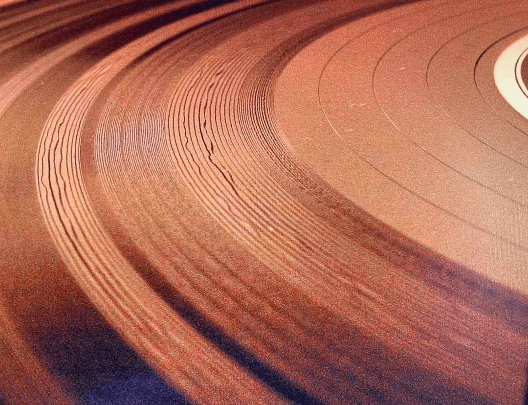

I have an organ LP which has 3 'test tracks' as a filler: 8Hz (64' pipe), 12Hz & 16Hz (32' pipe).
The 16Hz is first - then it segues into the 12Hz ... and then the 8Hz. When the 16Hz track is playing ... I can actually hear something from the subs. 😵 But when the 12Hz & 8Hz tracks go on ... I can see the cantilever wiggling violently from side to side - but no sound comes from the spkrs!

I see it more as what happens, the lower you go in frequency. Normal LPs do not have much below 16Hz - maybe even 20Hz - recorded in the grooves.
There is the odd exception. The (in)famous Telarc 1812, where the cannon shots can throw cartridges clean out of the groove. I don't know the spectrum of those shots, and it may be that it is simply extreme amplitude.
