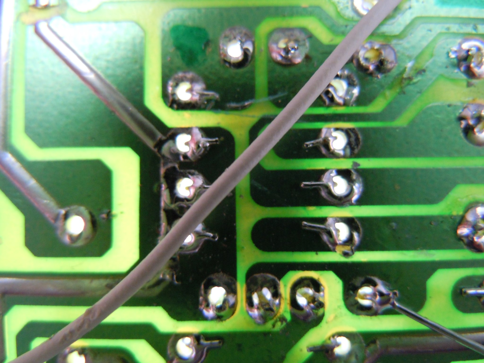

With these old devices, the mass is often chased over the housing. I would check this and modify it if necessary.
The circuit board needs to be re-soldered. These solder joints are usually oversized and also with dubious solder. Do not solder the cables to the solder pins - remove them and connect the wires directly to the circuit board.

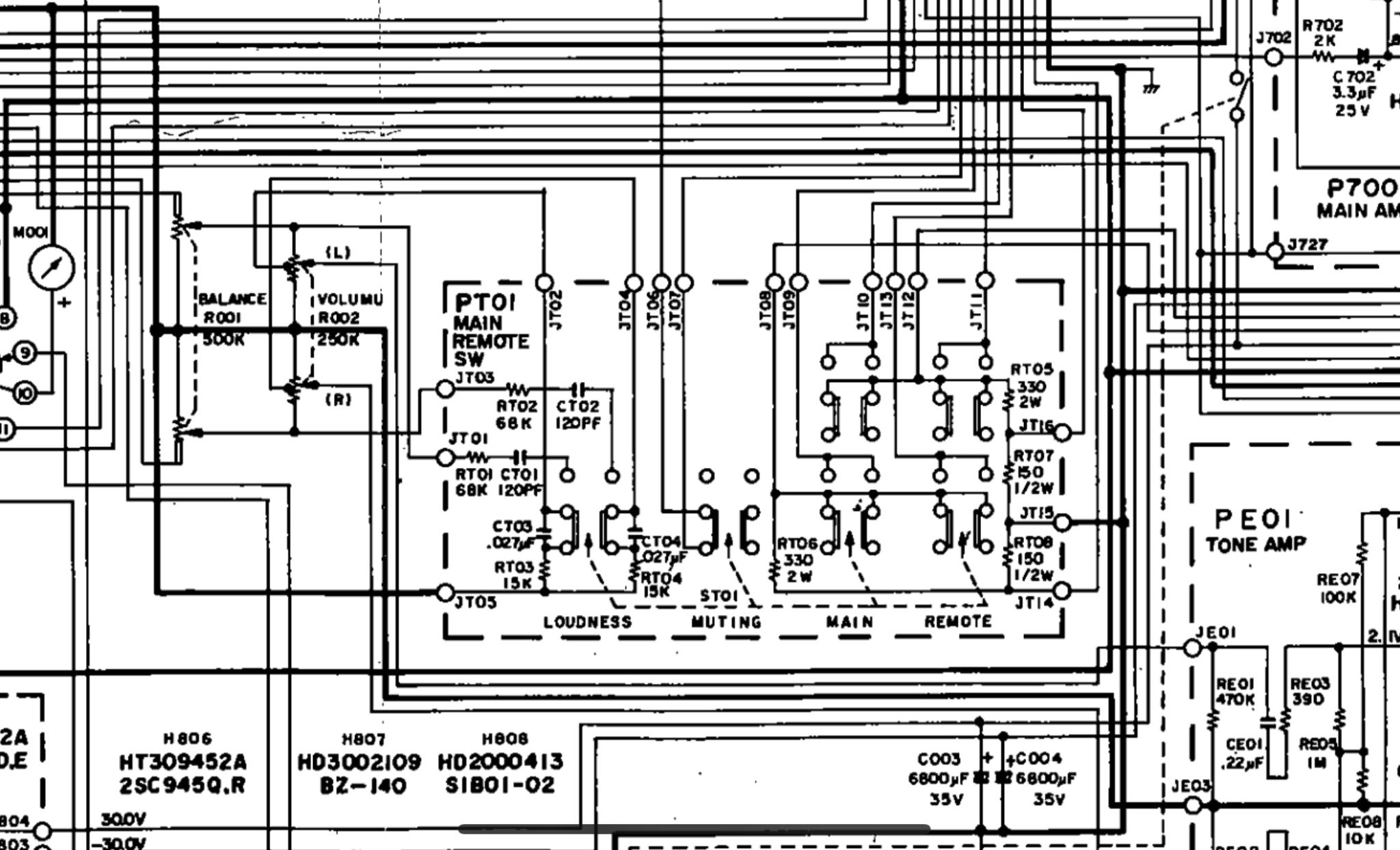

After the signal exits the the phono preamp it makes its way to the selector switch and then switching for the tape monitors
Then makes its way over to the balance and volume pot where the loudness and muting controls are also. The balance being a 500 kohm pot and the volume 250 kohm for each channel.
From the volume it makes its way to the tone board.
Hopefully this gives a better idea of what the load is.

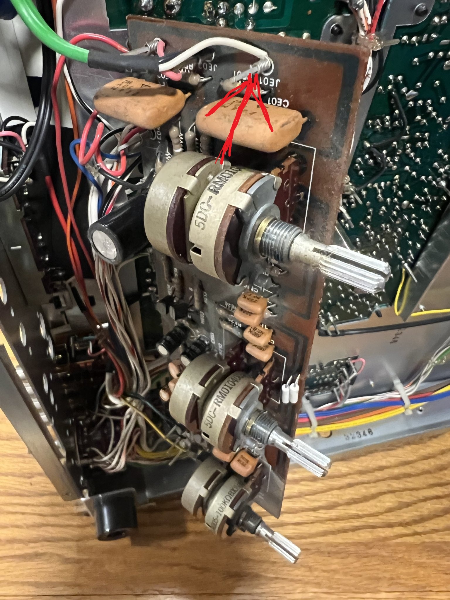

The tone control board will get the same treatment. The input capacitors are these 0.22 uF films, likely polyester or mylar, would there be any benefit to adjusting their size? The schematic is just above.

The greatest sonic gains are not achieved by replacing capacitors but by completely re-soldering and removing many small unnecessary transitions, such as solder connections.
The capacitor values are correct, they can stay. Other capacitors make sense. But I would only choose them after reworking.
Other parts, as diodes, psu caps... then.
I would also completely omit the "preamplifiers". Completely unnecessary sound brakes.
I took a look at the power amplifier (service manual). But I only got a very blurred image. The power amplifier is not bad at all. It has R701/C701 and R702/C702 at its inputs. From the potentiometer just somewhere on it;-)
Phono > input selection > potentiometer > power amplifier. Just try it out. It will sound much cleaner in any case;-)

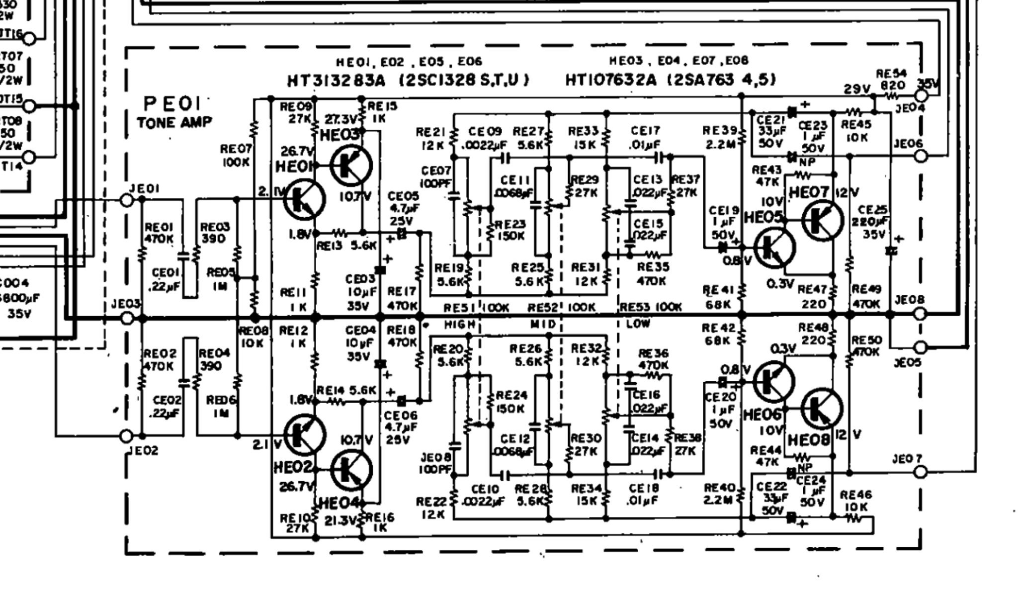

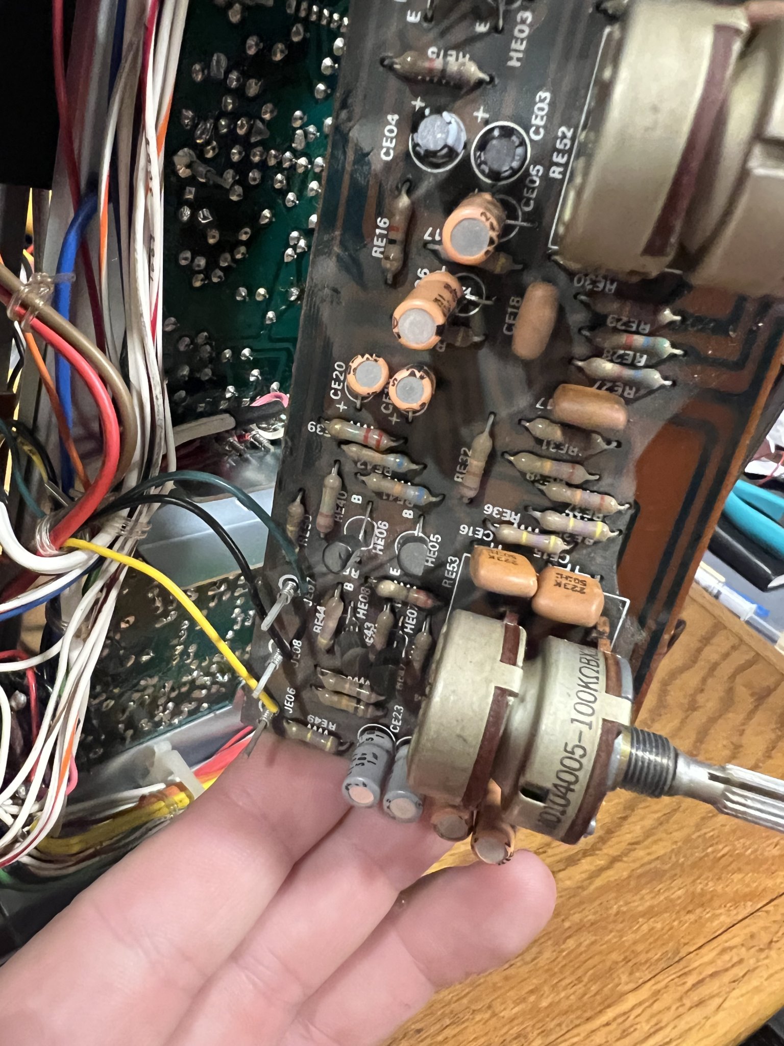

Another question I have is about the capacitors that the signal sees. I have read that ideally you want nonpolar capacitors where the signal goes through that capacitor, coupling capacitors. So for example, in this tone control circuit.
The input coupling capacitors are bipolar, but then the signal goes through CE05 and CE06 which are polar 4.7uF, CE19 and CE20 are polar 1 uF, CE21 and CE22 are polar 3.3 uF, then again at CE23 and CE24 they use bipolar 1 uF caps. If they have them for 23 and 24 why didn’t they use them at 19 and 20 as it’s the same value? Technically couldn’t all of these be bipolar if I wanted to replace them with bipolar is there a reason not to use bipolar in these positions?
They did use the good quality orange capacitors that are supposed to be low leakage that they generally use in the signal path of the amplifiers, just wondering if there’s any reason not to go bipolar. I could fill all of these positions with Nichicon UES.
Dan
The use of bipolars as couplers can also result from history. In terms of sound, there are good and bad ones. Just pay attention to the polarity so that the polar capacitor is installed with the appropriate voltage drop.
