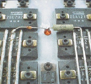

beppe61 said:
remember an amp where the output stage had separate supply and acted as unity gain buffer with the driver stage powered by an independent power supply.
Example:
the Audiolabor Stark monoblocks from the first half of the 80s, around 200 watts/8 continuous from 3 pairs of Sanken 2SA12/SC29 RETs.
The separate powersupplies for driver and output stage was not done for independant biasing purposes however, but to cancel out intermodulation between the two.
Like some circuits floating around overhere the Stark output stage did not have voltage nfb, to cancel out additional distortion due to back emf. (no output stage nfb lead to a distortion figure in the 0.2-0.4% range)
See picture: separate capacitors and transformer windings, the 2 blue caps are for the driver stage.
If you like watching output stages, the one of the Stark=>
Look Ma, silver hookup cable in 1982 !!
(the little golden washers under the bolts are great for torqueing, i can post a pic of one if desired)
Scuse the pic quality, my picture resizing software is acting up again.
jacco vermeulen said:
Example:
Like some circuits floating around overhere the Stark output stage did not have voltage nfb, to cancel out additional distortion due to back emf. (no output stage nfb lead to a distortion figure in the 0.2-0.4% range).
Very remarkable amp indeed.
Thank you for the pictures. Very interesting.
I feel it is a great sounding amp.
