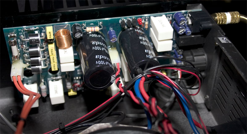

All right Mr. Mike.
So I have to act on the bias trimmer in order to get 25mV across RE. I could always try while monitoring carefully the temperature on the heatsinks.
What are LATP transistors ?
Anyway I do not think is my case.
I am attaching a view of the interiors when the REs can be seen.
Thank you very much again.
Kind regards,
beppe

Beppe, regarding the size of the heatsink and the "complexity" of your amp... Don't touch it...
Did you see any trimpot for bias ?
Beppe, the REs mentioned by Ilimnz are if the transistor is made of several smaller transistors, in this case these are needed to share current among these.
Mike
Actually looking inside I can see 3 pots.
I have to disassemble the amp to expose them.
I am so resolute to try the up-biasing that I could have my amp serviced by a lab I trust completely.
I am pretty sure the present bias is very very low.
I can leave the amp on 24/24 and the heatsink remain completely cold, like the sound actually.
If I had the actual schematic, that is unobtainable, I would try myself.
beppe
