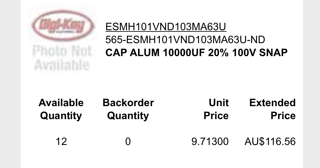

edit: Wow, your Digi-Key price is sure better than mine -- $18,27 USD ea @quantity 10! Is your dollar that much stronger these days?!

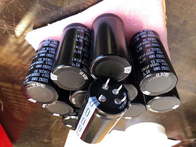

I got the cheapest part from digikey. AU$10/pop and they had them in stock. ESMH101VND103MA63U
565-ESMH101VND103MA63U-ND
CAP ALUM 10000UF 20% 100V SNAP
A most reliable brand. Its their proven SMH line, the 100V DC has 125V surge spec. Its the four pin version code though. Two extra pins for stability.
"Use the blank terminals for mechanical support only. The blank terminals must not be connected to a solder trace on the PC board, but be electrically isolated from the negative or positive terminal."

Audusd=.78 so yours is quite a bit stronger. Probably other factors at work. Who knows where the pricing comes from. There must be stupid margins on the parts to warrant stock management across millions of SKUs.
There seems also to be a long waiting period for many items like 30+ weeks in many cases. First time shopping for caps so may be normal or it may be yet another Covid supply chain issue?

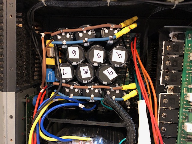

The new caps arrived today. Order date was 27/May. Today is 31/May. They came from USA to Melbourne, Australia. And postage was not charged extra. And we are in lockdown. And these were the cheapest caps that fit the specification. And they were well packed.
Let's just say Digikey will continue to have my business!

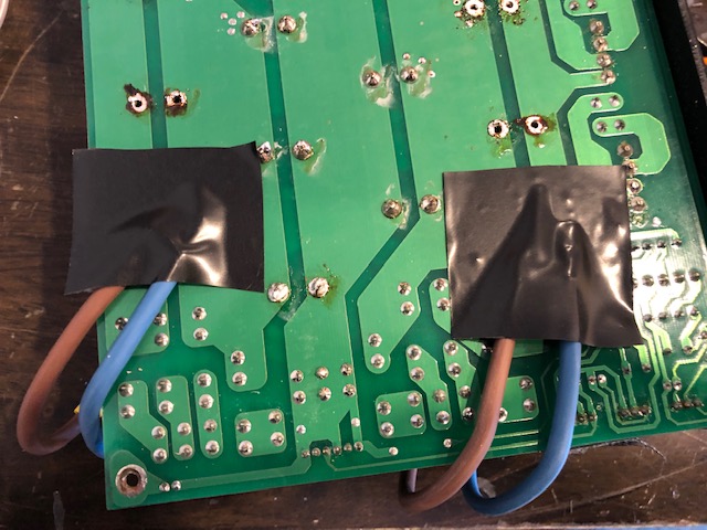

Fly in the ointment is that I didn't check the specifications carefully enough and the pin spacing doesn't fit the board. My mistake. So I had to rig up external rails, as you can see. I used some spare wire that runs the 30 amp pool chlorinator, so should be OK.
To troubleshoot the problem I simply replaced the stuffed caps with the new ones. And bingo! The 'clip' LED is now off.
Some pictures as requested.
I might just replace the "still OK" caps as well and drill holes to fit the new caps on the board proper, but for now I'm chuffed that the fix seems to have done the trick.

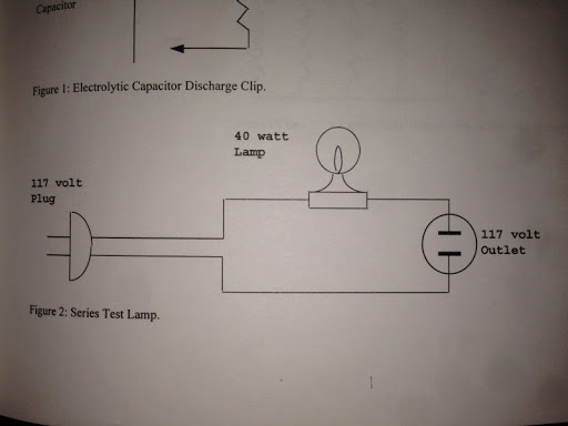

This is the basic diagram, you have to put lamps (one or more in series) that are less than the power (Watts) of general consumption of the amplifier, look at the back of the equipment, where the power cable penetrates. As soon as you turn on the amplifier, the lamps turn ON BRIEFLY AND THEN STAY OFF IF ALL IS OK.

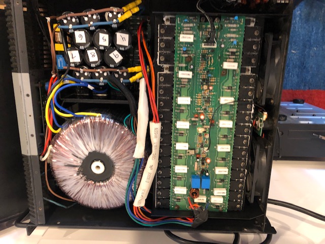

Perhaps to wrap up, I thoroughly cleaned all parts and replaced the old fans as they had developed a rattle with a couple noktua units I had lying around from a past PC build. No the amp is near silent.
I remeasured dc volts and got 162.7, 71, -71.3, -163.2. This looks ok to me. I also measured dc offset and got ch a: 0.035; ch b: 0.005, bridged 0.027. That’s with nothing connected and gain to minimum.
I’ve not yet had a chance to put the amp in its designated spot and connect peripherals but I think there won’t be any surprises. Oh, resting idle power consumption measured at the GPO is 40w. On power up the wattmeter goes up to 500w very briefly though.
No bump through the speakers when turning on to off.
I’m happy with the result and thank you all for the ideas and stimulating discussion.
