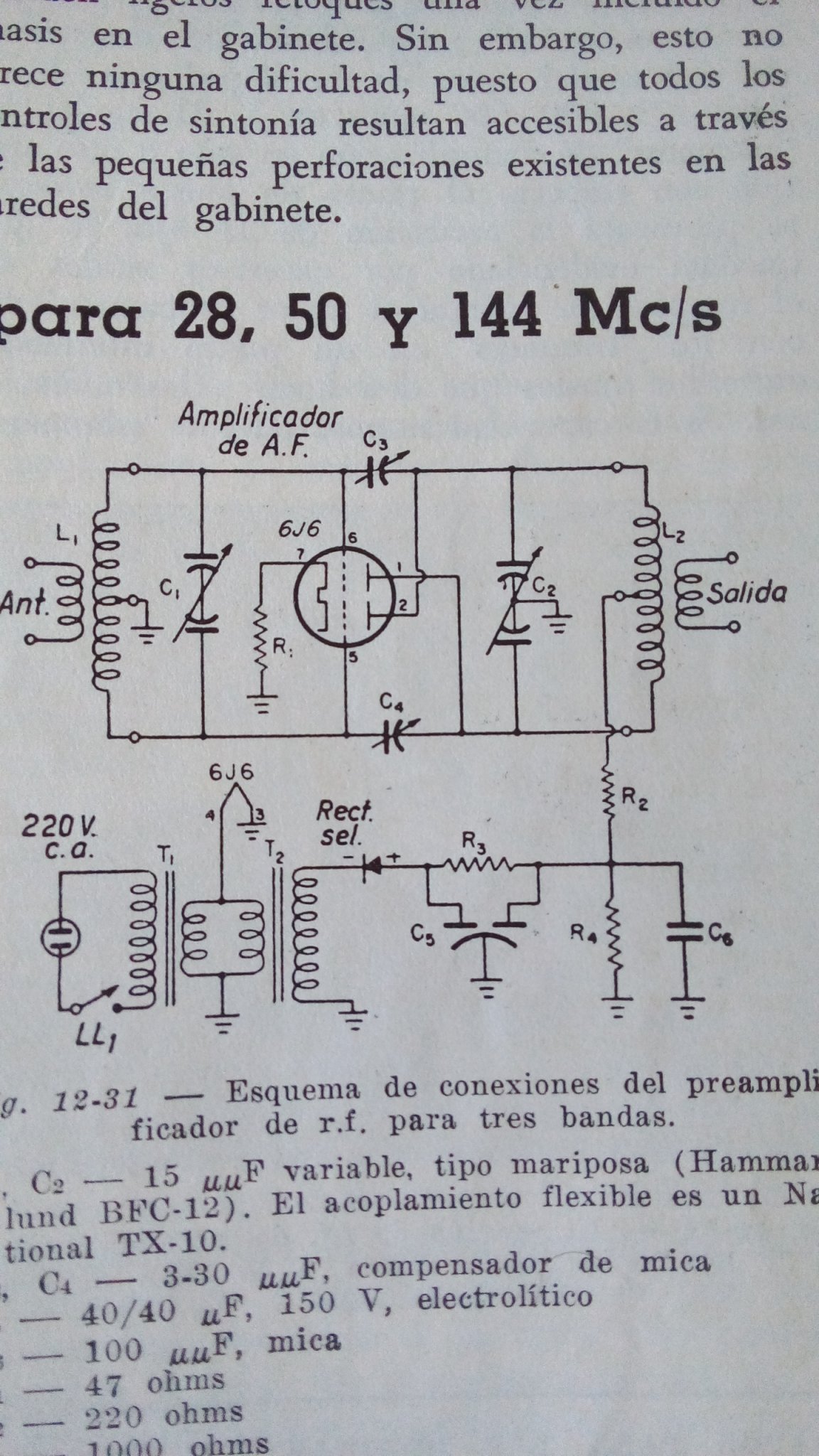

Or the transformer is really bad designed/built. The idea of using a transformer to increase heater voltages for low current stages or for bias has been in use from decades ago. Here is one taken from a ARRL Handbook 1954 in Spanish.
