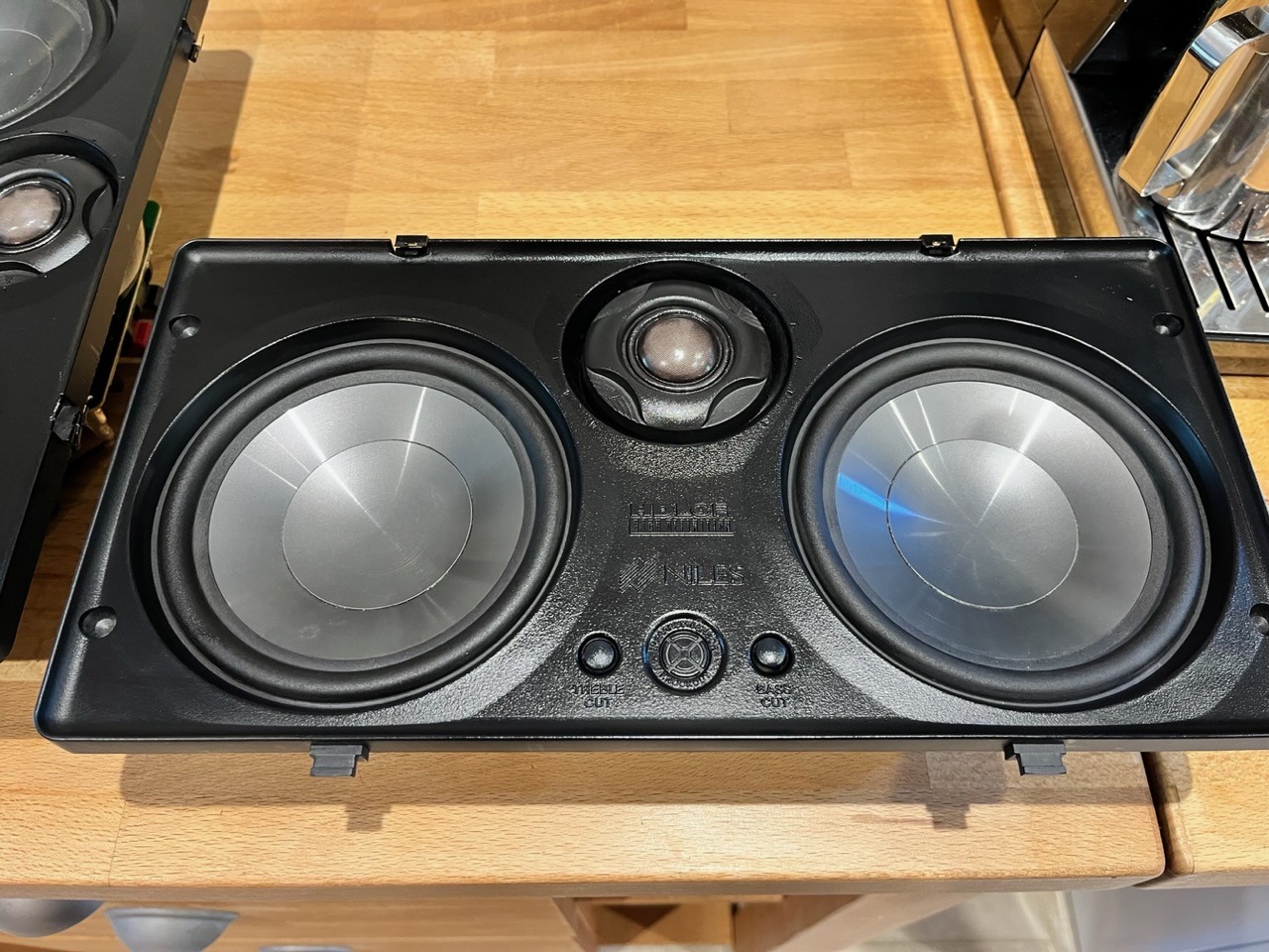

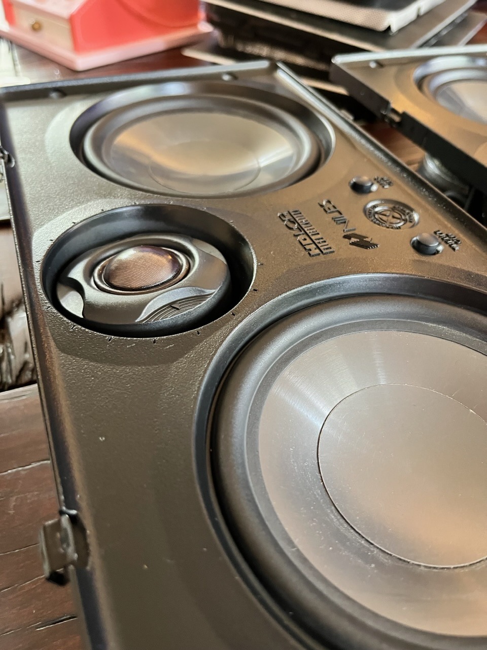

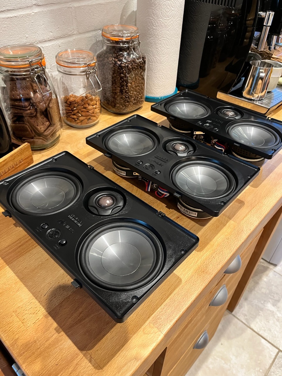

I have some Niles HDLCR in wall speakers that I will never use as they’re intended but I wondered would they make decent hifi speakers if I were to fit them into some cabinets? If so how would I calculate the size of box needed ?
Use what they said in the manual for the in wall volume : i.e. always very low volume because it is in wall, no ?
It is not only about volume box but front wall size as well. When on a wall the loudspeaker has the equivalent of a huge front baffle you will not have anymore when boxed. So unluckilly it needs filter value changes.

About those front baffles : use them as the user manual advice : the drivers are certainly made with Thiel and Small spec for very small volume load. So use the same and put them the closest distance from the front wall, better close on it or in between books on a shelf on a books wall shelves to have the same as an infinite front baffle load (the wall).
Reactions: TheFinisher
I'd think it a shame not to have a larger frontage to the box since this adds a baffle step. It wouldn't have to be deep. Ie: more attention to the outside of the box than the inside, which can be equalised. The crossover would also already be tuned that way.
However really you can put it in any reasonable box you like and there's a way to adjust the performance.

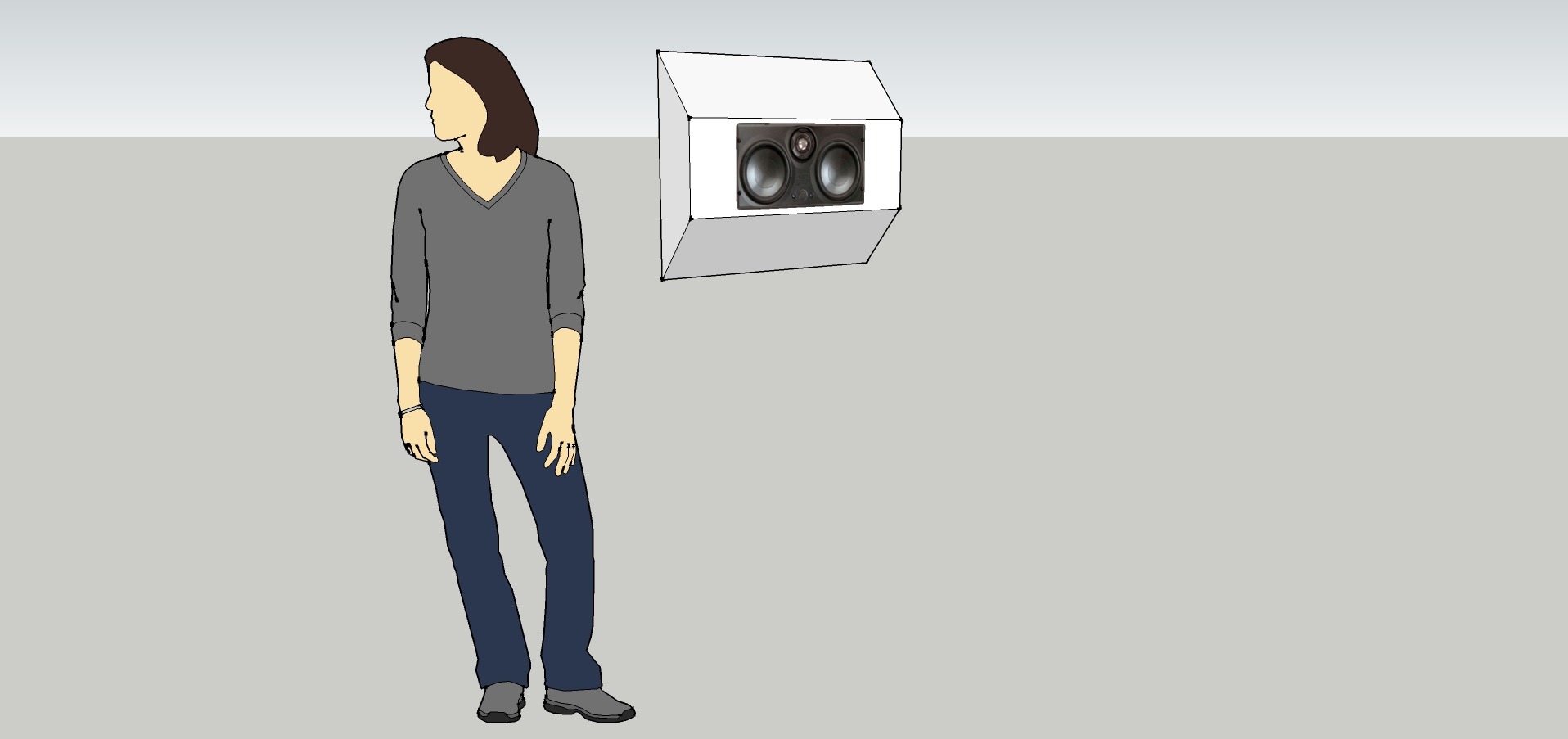

Trick is in wall, would be shallow
Same thing free standing.
If entertainment center/ TV is flat to the wall already.
Sitting at ear level on a stand , flat / flush against wall.
The wall still behaves like a large baffle.
Likewise mounted in a shallow box, then mounted on the wall.
Same thing just no wall holes.

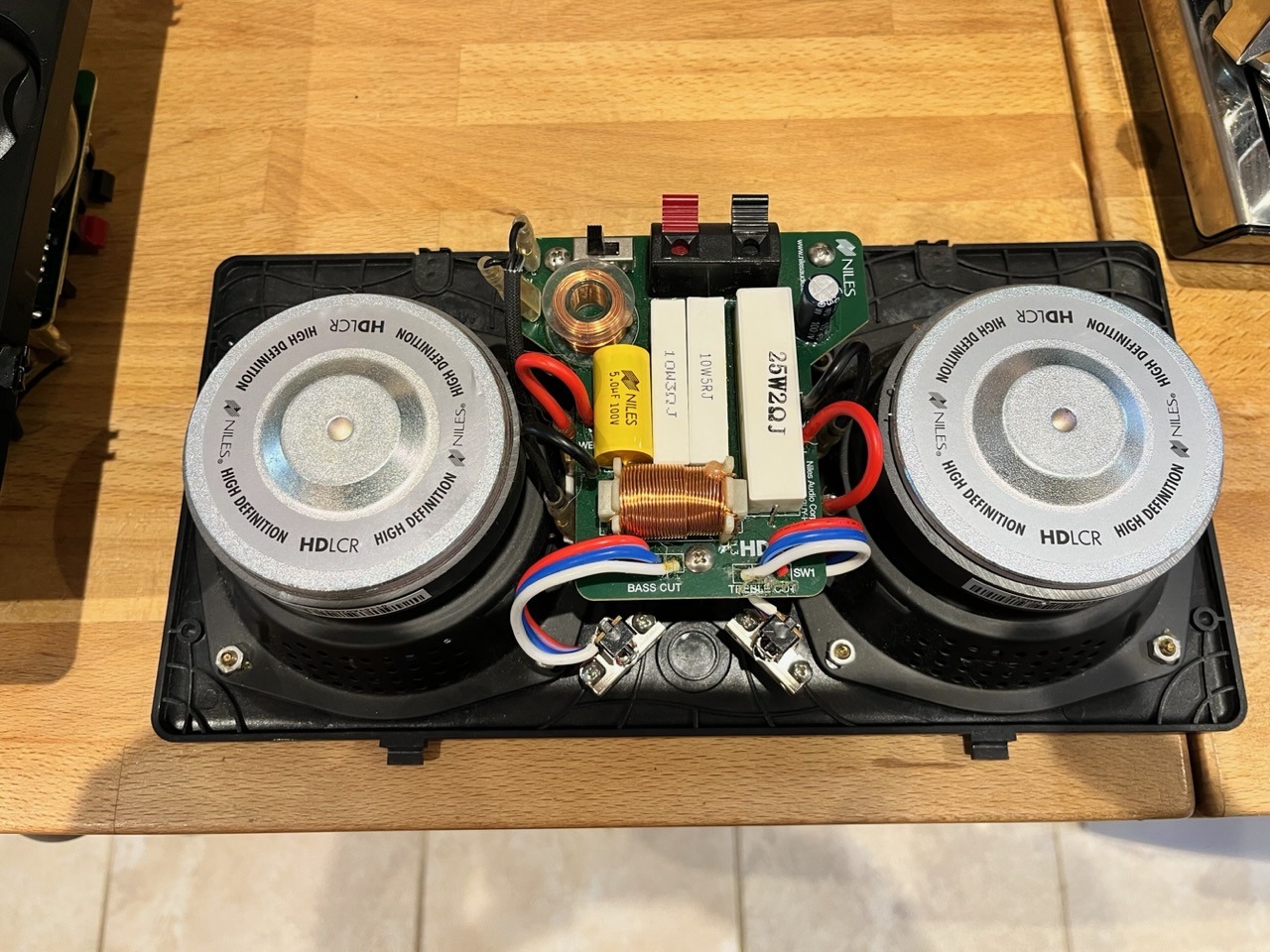

Normally you would mod a bit LP filter to decrease the midrange spl and HF padding by changing resistors. Cabinet volume gets calculated as with any other drive unit project. You evaluate bassmid T/S parameters by measuring impedance, using formulae or a dedicated program like ARTA and such and by feeding a cabinet simulator, the LF response is known.
I would give it a shot, even without any x/o mods. A LP inductor is easily modded by adding a certain number of magnet wire turns to increase its mH value. Two 8 ohm units in parallel form a 4 ohm nominal load and 1-1.2mH is a typical value that would work well in a cabinet placed in free space, unlike this crossover designed for in-wall.

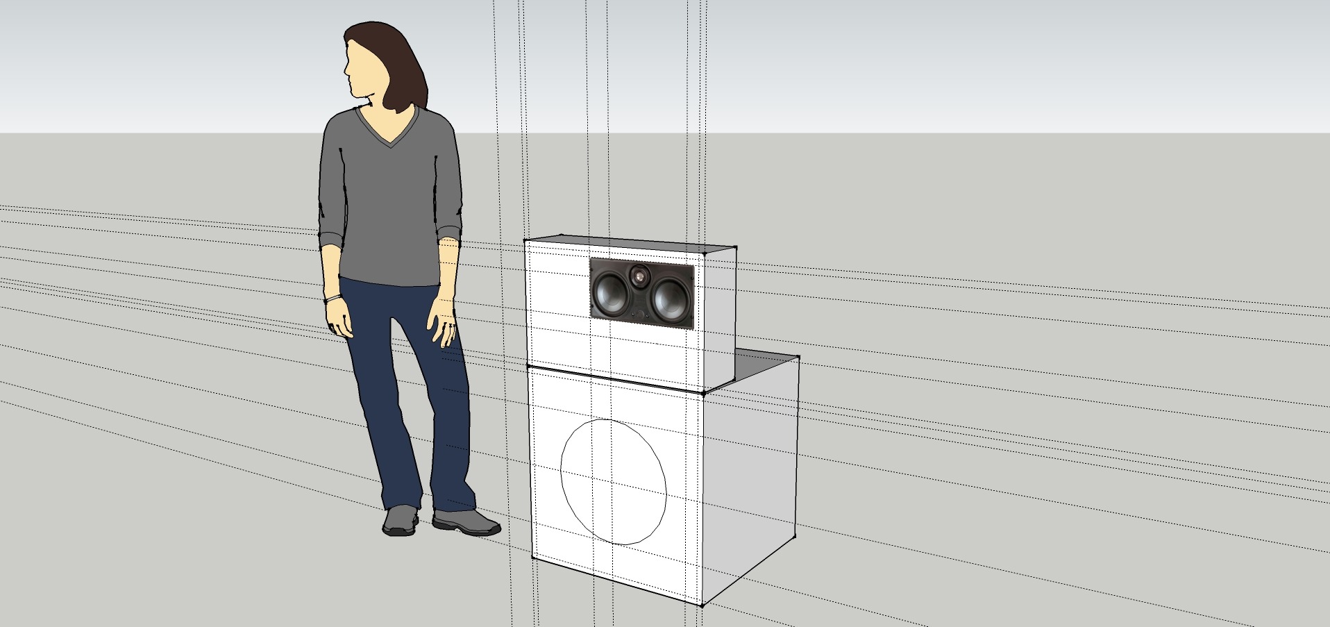

Yep, something simple sealed
40 to 60 liters
Floor standing or shallow wall mount
Or sell.
Try refine something basic that works.

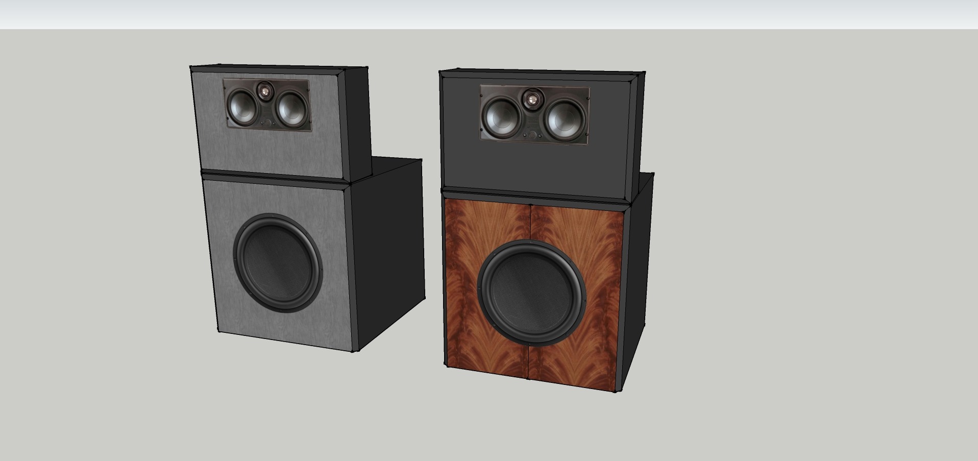

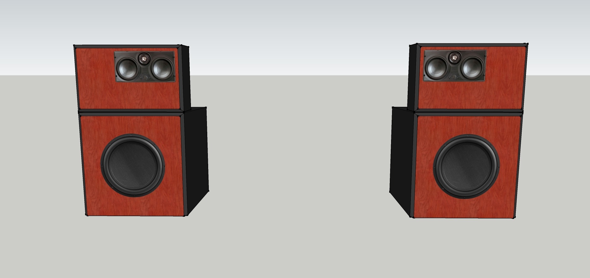

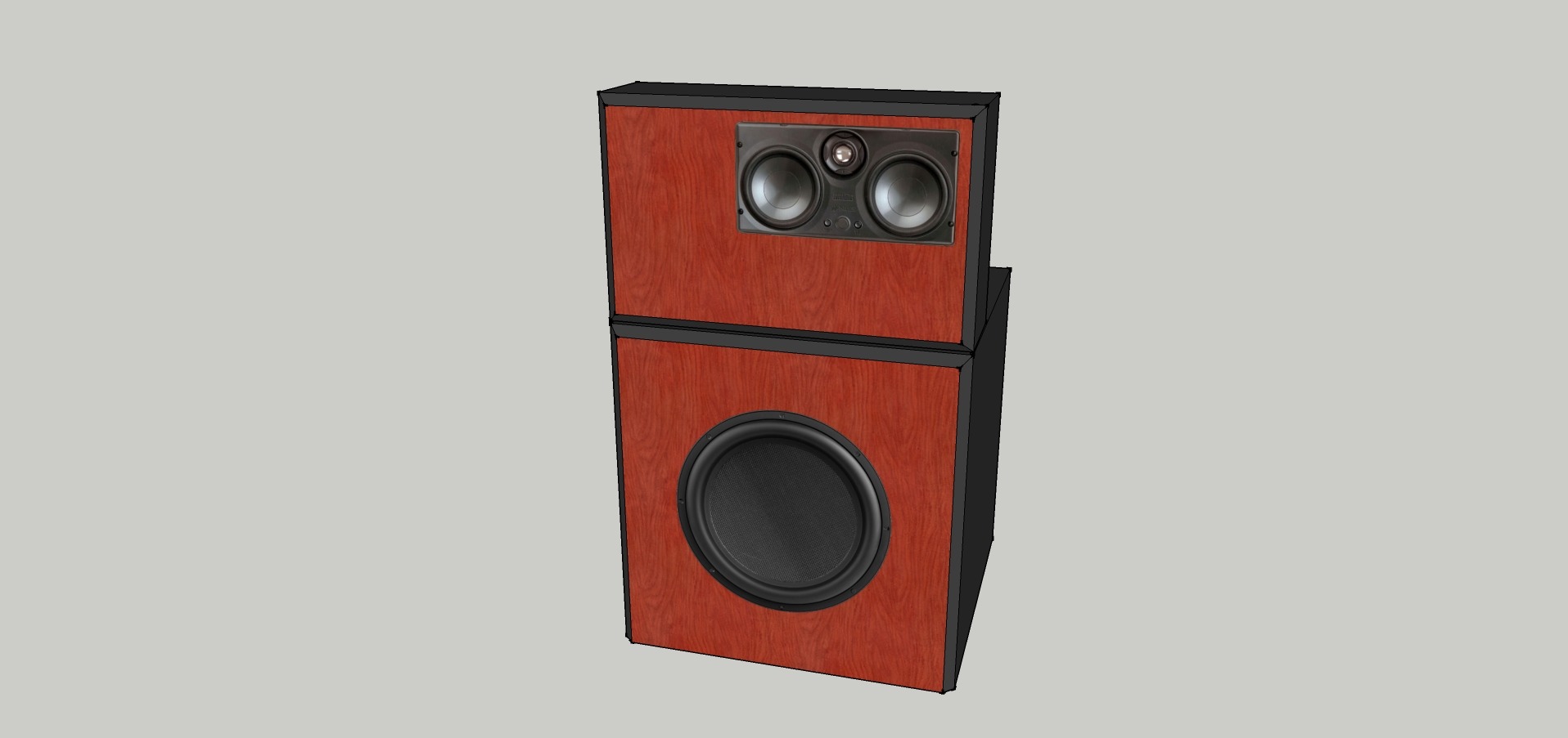

I played around with it
toss in sealed 15" active 2way 200 ish Hz crossover
