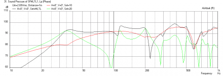

Are you really stuck on the 11x12 in footprint which includes 0.75 in thick boards? I am running into Vb issues and could use a little more volume. Can 13.5 x 13.25 in footprint work? It will help flatten response significantly.
Here is the SPL vs Freq for a 12 in wide x 5.5 in deep (internal dims) channel with a single fold for a 58.5 in long transmission line (30 in tall cabinet with 0.75 in thick walls). Vent is 1.75 in deep x 12 in wide x 14 in long internal shelf vent parallel to walls. Mount driver at 25 in above the floor (0.44x from the closed end). The speaker should be placed as close to a back wall as possible to enhance the bass. A 250 Hz XO point would be ideal rather than 300 Hz.
SPL vs Freq

You don't say it, but it looks like you ARE running sims for the 8" silver flute, rather than the 6.5", and that is what I was wanting for the freestanding, though I do also apologize for getting carried away with new ideas.
And yes, I expected that It would get bigger, although it might be better looking if it was deeper in the room, rather than wider.
It is interesting that it does not go deeper than your sim for the 6.5", so if high output is not a big concern, maybe a 6'5" version is still the best as a sub up to 100hz.
The 250hz x-over would probably work out, though the little fOSTEX FF85WK fullrange is only rated for 5 watts, and is only 86.5 db efficient, so over-all power handling could be an issue. Might work better with another fullrange, like the Fostex FE103, which should play a little louder and lower, and is also very detailed sounding.

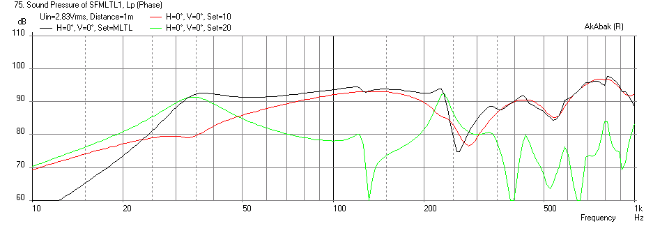

Forgot to say it was the 8 on Silver Flute. The bass extension will need a bigger box to Ho deeper. Just switching to a larger driver also requires a box Vb commensurate with different TS params. A passive 2 way XO is a good option with this setup.
xrk971
Would a longer line go lower?
More volume (increase cross sectional area - the length is already sufficient for a MLTL) will help to bring the tuning down lower.

Oh OK. Looking again at the built in project, it seems like the 8” would not be the best choice in the 18.5 x 89 x 3.5” left hand cavity. The cross sectional area would work well (18.5x3.5=64.75sq in), but other aspects would not.
8" freestanding design:
The total deal breaker would be the distance from the end (0.44x from the closed end), which would not fit my in-wall situation.
So it seems like the 6.5" is the best bet for the two in-wall cavities that we have discussed. As you pointed out the 6.5” is a good fit for depth and is a good fit for driver position. It should fit my spec (19" to center) for distance from the end(which is the ceiling in this case), because 19" is very close to the 1/3 length, form the closed end, that you spec'd.

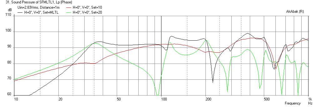

It also sounds likely that a 6.5" in the left side 18.5x3.5x89" 85 liter cavity may go lower than it does in the 35 liter cavity, because the CSA could be greater. Hope you will find time for that sim. I know that many folks find AKABAK hard to learn, so I am thankful that you find some time for this. Thanks so much for the work. I have seen that you have a hand in a few threads at a time. Your help is much appreciated.
This is adjustable to a certain extent. 0.44x is one of the optimal positions, where would you like it? I picked that location so that the driver is located at the top of the 30 in tall cabinet.

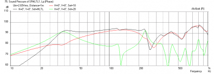

Here is a possible design that is 65 in tall x 18.5 in wide x 3.5 in deep with a 1.75 in x 18.5 in wide x 12 in long slot vent exiting out near the ceiling (or floor). The driver is located at 0.55x (37.5 in) from the closed end.
