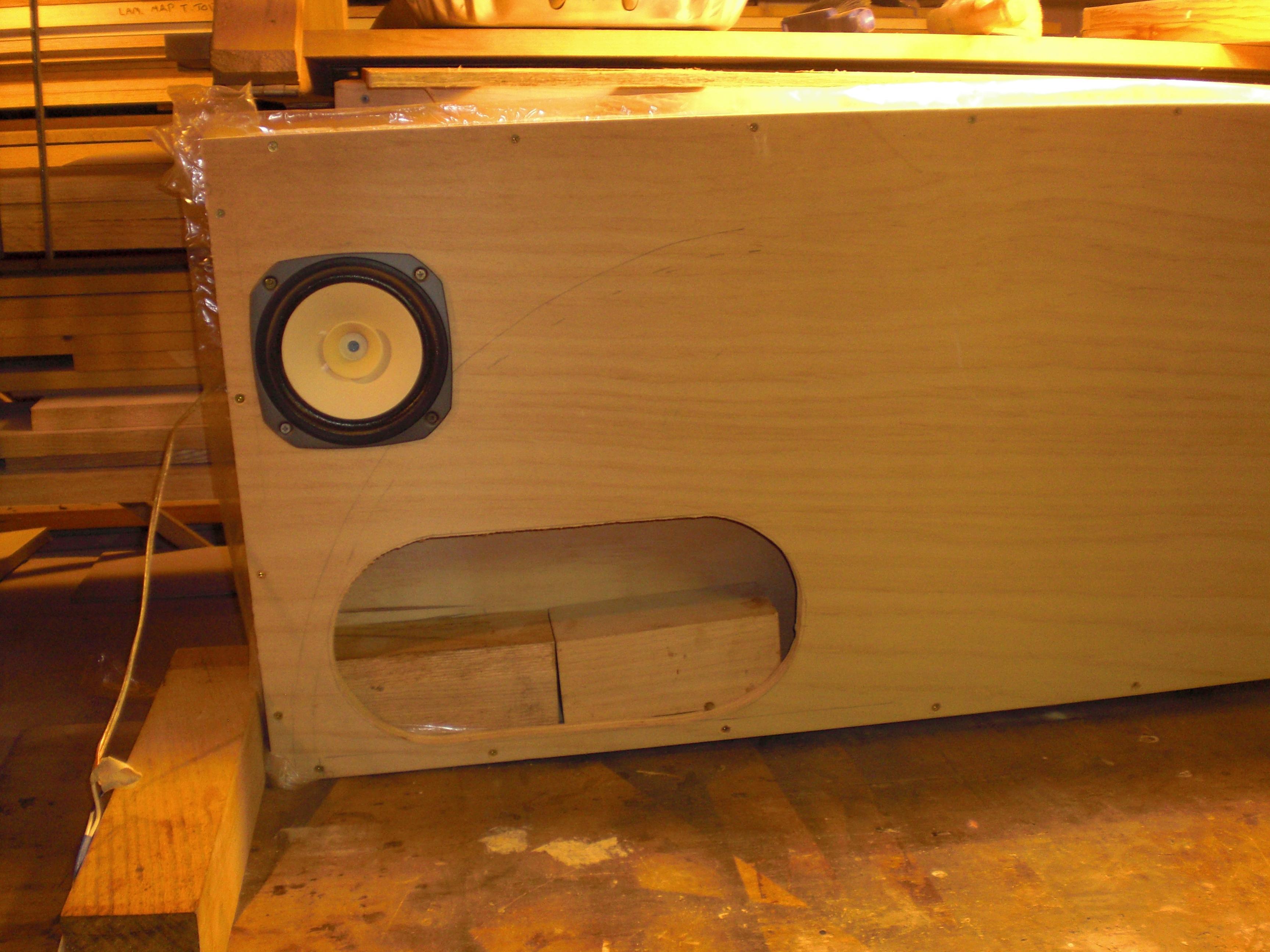

I tested a partly completed horn on the bench- without the front screwed down and laying on it's back. Made the mouth about 115 sq in.(about twice as big as the largest, closest section of the horn). Best bass seemed to be with about half of that mouth covered(so that what was left open was about the size of the inner passage near the mouth). Maybe it was more resonant, but in a way that seemed pleasing to me. Still going to need the walls nearby to bring the bass level up with the midrange and highs. Quality of bass is musical, less "pushed" or "mechanical" seeming than when coming from a big, powerful woofer. Resonant, I think, but in a different way than a big woofer in a BR cabinet. I wonder if the "waves" that come off a horn powered by a small driver are somehow different from those coming off a big woofer? I understand that a cone driver is typically about 1 percent efficient in coupling it's energy to the room air, and horns are much more efficient in that respect. Maybe we can somehow feel some of the pressure from a big woofer cone, but not hear it as sound. Or does the other, non audible energy, the 99%, just become heat?

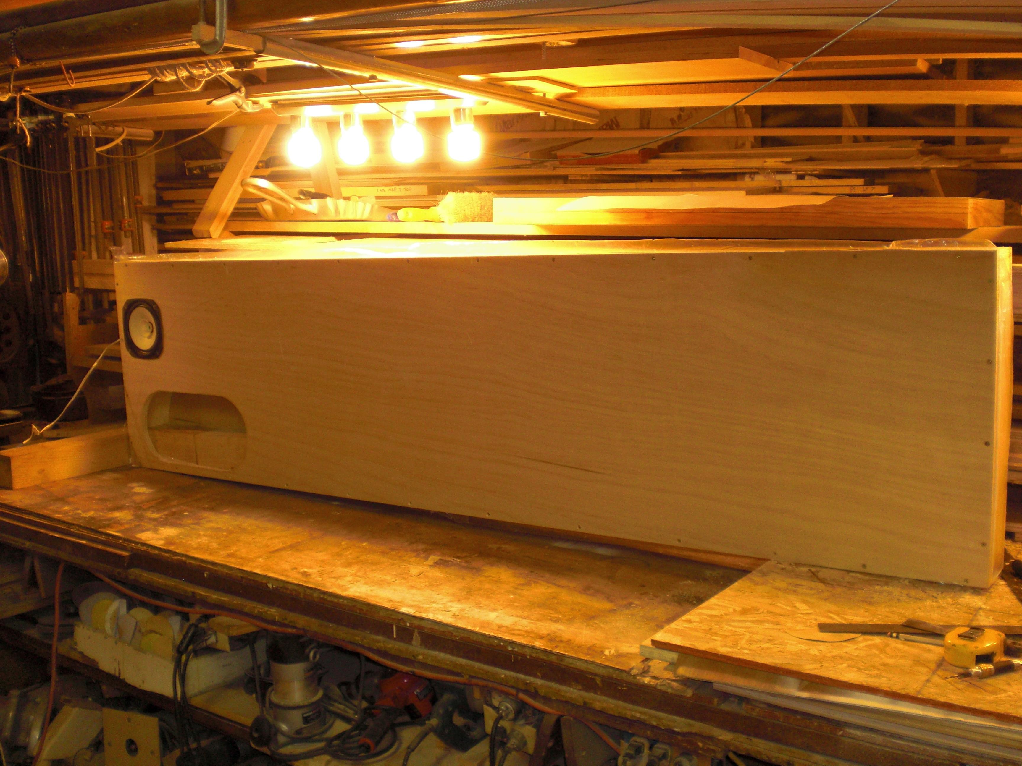

The speaker that I just built is the left channel, and will install horizontally in the wall above a set of wardrobe cabinets (that, strangely enough, will also extend into the wall cavity-to save room space) . The right channel will be in the wall vertically, like I suppose that most in the wall horns would end up being(this one going behind a bookshelf, up to 68” from the floor, like the wardrobes). A lot of design time has been consumed just getting the two driver/mouth combinations to look the same from the room, and to interact with their horns similarly enough. When I figure out how to scan in drawings, I will show all this for those who are interested.

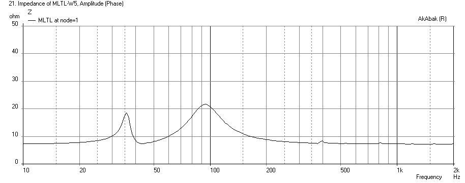

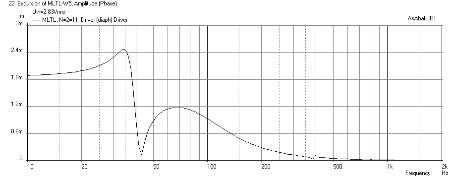

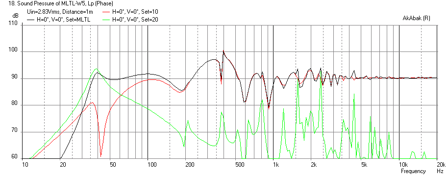

In-Wall MLTL as Alternative to BLH
Using the constraint of 16 inch spacing between 2x4 studs in standard drywall interiors, I designed the following speaker that can be installed during the installation of framing, before drywall goes on. A 2x4 is really 1.75 in x 3.5 in. Thus the natural cavity in between walls in the US are 3.5 in deep x 14.25 in wide (internally). I decided to go with a TB W5-1611SAF as it has a moderate Qts that will allow deeper bass extension for a MLTL, and it has a nice smooth response with just enough sensitivity to match the bass from a MLTL port.
I actually used the Accidental MLTL technique to size the speaker prior to tweaking it in AkAbak. The AMLTL method assuming a length of 40 inches gave me a vent dia of 2 in x 3 in long. The driver will be mounted at 17 in from the closed end and the port will be 6 inches from the "bottom". In this case, I will flip the speaker upside down and put the port near the ceiling and the driver at about 32 in from the top of the ceiling. The following are the results of the simulation and they look pretty good: 40 Hz bass extension and 90 dB sensitivity. The impedance is pretty smooth and the cone excursion is well controlled.
So, if you are remodeling a room and have exposed joists/beams, tack some cross bars to make a cavity and seal with silicone. Silicone the drywall panels when they are installed for an airtight cavity that you prewire and stuff some polyfill or fiberglass in the top 2/3rds of the line. After drywall is done, cut out the driver hole and vent hole. Install drivers and enjoy! It will sound better than any store-bought ceiling or wall speaker. 🙂

I thought about a BIB too, you will need to select a driver with correct Qts and Vas to get CSA to match 14.5 in x 3.5 in available in duct. Probably a low Qts driver.

That sounds like a great idea for a great sounding solution that does not involve all of the tweaking that can be involved with a horn. Naturally it would be great if someone would build a MLTL like you have designed and test it, then others could go ahead with confidence with the easy stud-bay enclosures. I like where this is all going!

My MLTL designs have been typically successful and built by others with good results. This one is not far from standard MLTL design methodology so should sound like the Akabak sim. I think my sim predicted the bass on your wall horn to be near 40 and 100 Hz.

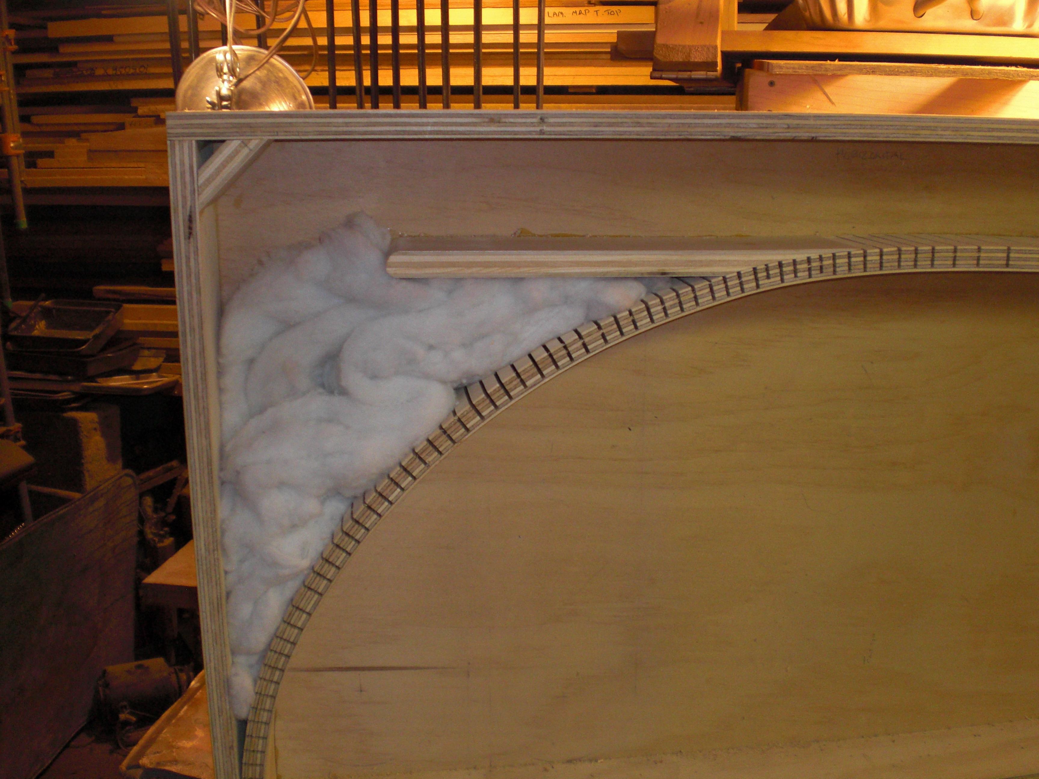

photos of IN WALL BLH
Yeah!(had to upload one at a time)
The photos are blurry in the post preview. I will post it and see if they look any better. They were clear on the camera, and in my computer.
This is the one that will be installed close the ceiling and will lay horizontally like it is shown in the pictures. Notice that there are blocks in the (oversized) mouth to make it effectively smaller for testing.

Nice design! I like the curved wall with bendy ply. If you were to mount the driver at a point 0.21 down the line it would sort of approximate a BIB ( no driver chamber).

I think that the vertically oriented cabinet design will end up being more rectilinear inside, on this one it just seemed to work out nicely to curve it this way. For those with more basic woodworking skills/tools, installing a series of smaller pieces should work just fine to form a (bumpy) curve. Not too many folks will have a need for a horizontally oriented cabinet though.
Unless you have good hand skills with a skill-saw(American slang for portable circular saw), you need a radial arm saw, or a sliding miter saw to kerf plywood like that. Shorter pieces can be managed on a table(bench) saw.
