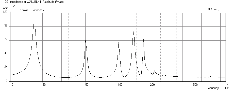

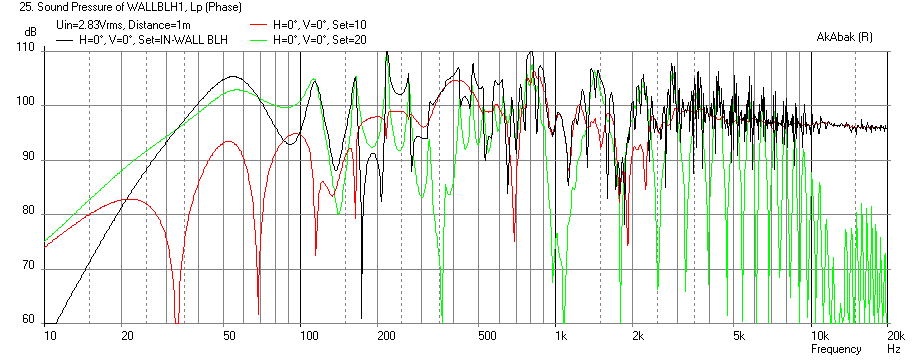

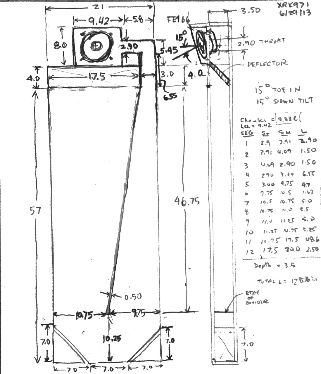

Initial Design of In-Wall BLH for FE166EN
Here is what I came up with for a design so far: A 4.33 liter driver chamber connected to a 129 in long conical horn with a throat area starting at 10.15 sq in and expanding to a 70 sq in mouth area. The driver is canted 15 deg toe-in and 15 deg down and is located 5 in from the ceiling. The horn mouth is located immediately below the driver box and has a 4 in tall x 17.5 in wide opening.
The simulation in AkAbak assumes corner mounting 25 in away from the side wall. The corner loading provides a huge bass gain of +9 dB. First plot is frequency response at 1 m, the bass peak is about 105 dB at 1 watt input. The next plot is the zoomed into 1 kHz, then next plot is impedance, then the cone displacement (exceeding xmax of 1 mm already so I don't think there is enough horn loading due to lack of expansion ratio), final plot is the impulse response showing a significant group delay beyond the audible 8 ms range. The bass extension is pretty deep (90 dB at 27 Hz) - but it is not flat.
This design can definitely use some tweaking - and I would love to receive feedback/constructive comments to improve design. It probably would sound not too bad given the size constraint and that it is in-wall, certainly better than any box-store in wall speaker you can buy. The sensitivity with the FE166EN is phenomenal - perfect for fleawatt tube amps.

Your drawing is extremely similar in important detail, and overall layout to my in-progress speaker, except that I have built in the 30" of extra length.

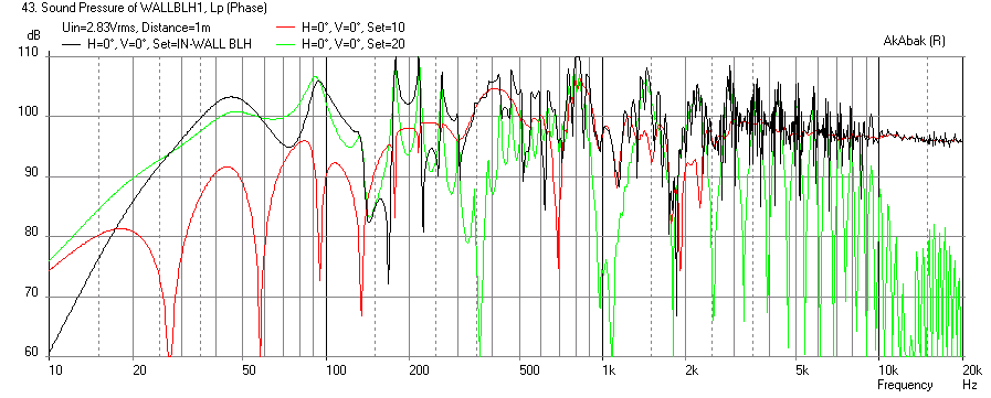

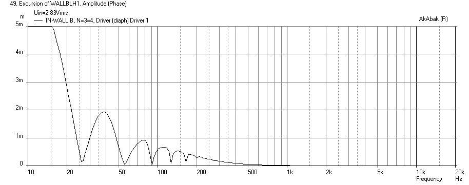

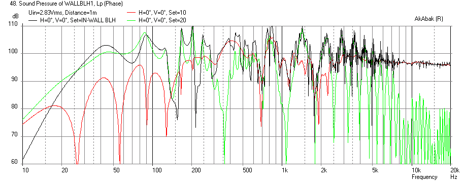

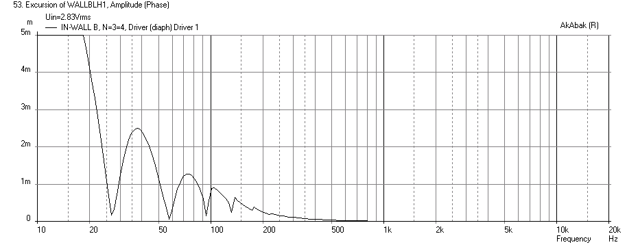

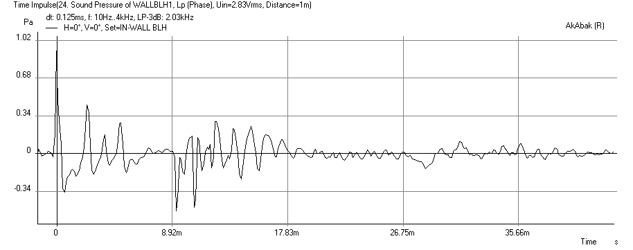

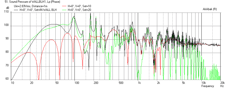

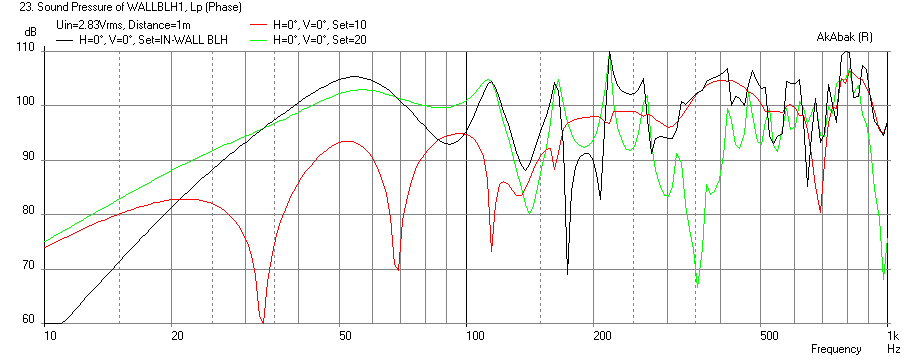

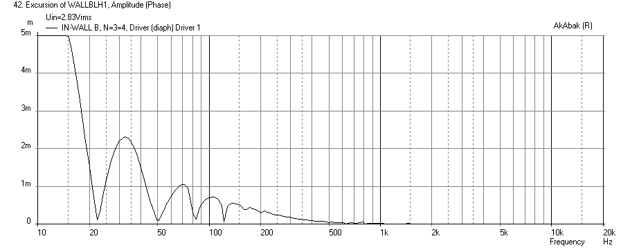

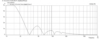

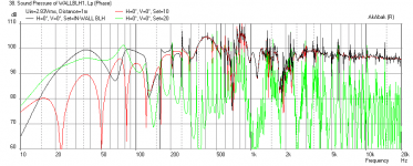

Howard,

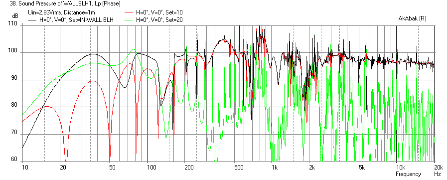

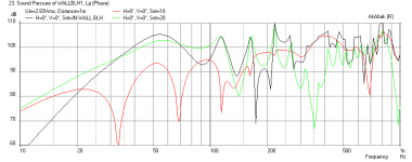

Here is sim with 30 inches more - it helps smooth response and gets deeper extension. However, the peak excursion is just pulled to lower frequency. I tried restricting terminus to a 1.30 x 4 in hole and this smooths even more but peak excursion actually worsens. I then tried adding a horn extension to get the final expansion ratio to be similar to Austin with additional 12 inches of exponential exit horn - and this still does not reduce cone excursion. The solution may lie in the chamber and throat more.
First plot is freq response with +30 inches in main lengths, second is corresponding cone excursion.
Third plot is freq response with +30 inches and restricted terminus and corresponding excursion.
Fifth plot is freq response with +30 inches and 140 sq in mouth x 12 in long exponential external horn and corresponding excursion.
I think with stuffing to damp the resonances more like a TL, you may be able to get this to sound pretty good. The cone excursion is an issue still.
