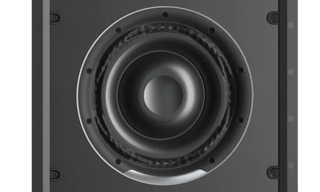

For midwoofers, replacing an existing surround Purifi's neutral surround may help. This will need some kind of group buy with a MOQ from Purifi, whom seem very supportive of DIYers/startups. Dali use one for their in-wall (IW Sub 100) subwoofer.
the "Constant Surface Surround (CSS) technology, developed from the ground up by DALI's engineering team in Denmark." looks conspicuously like Purifi's neutral surround, so I would like to think they have a license to use it.

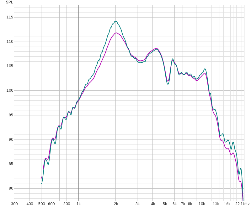

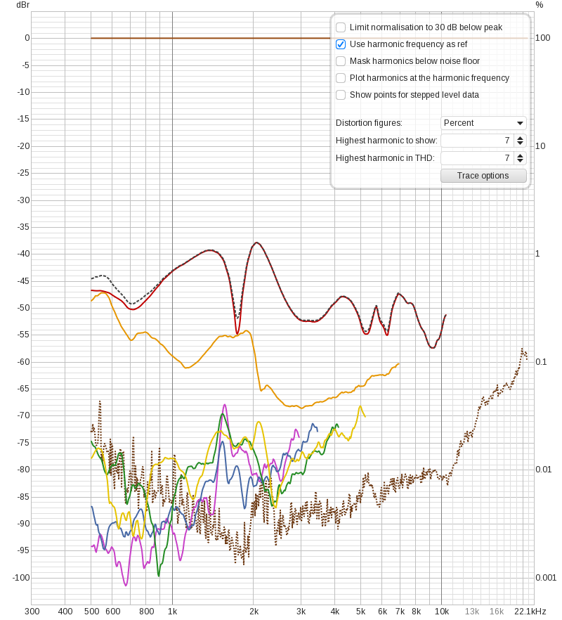

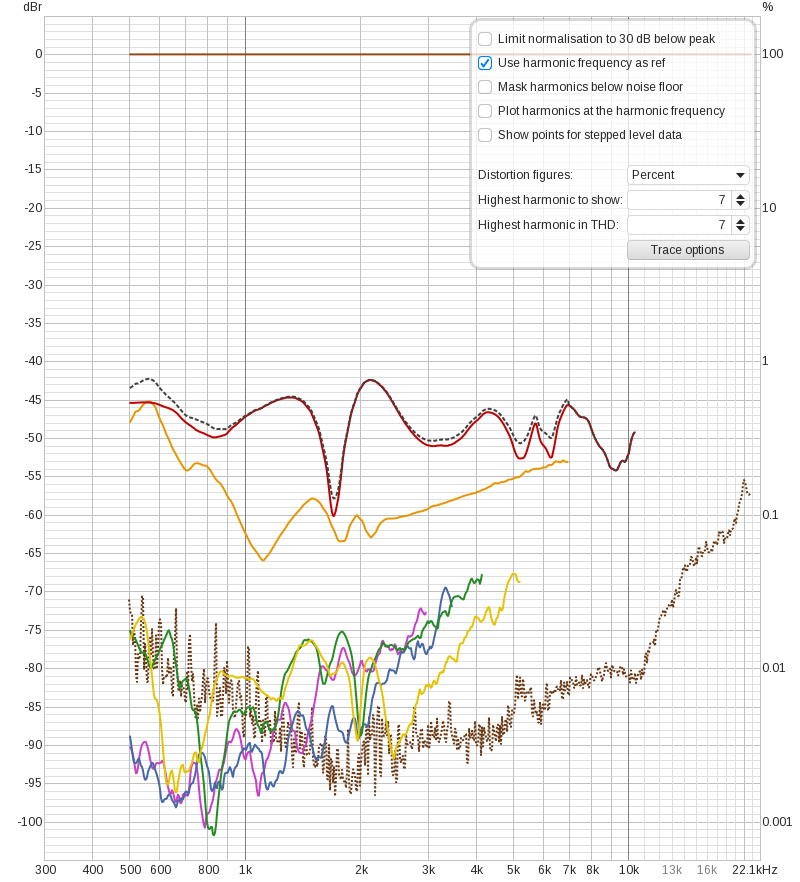

In my preliminary testing ,a low sensitivity, high SPL capable microphone with low noise pre-amp like the Line Audio Omni1, AT 2020, Rode NT1-A or upcoming Omni-mic 40K microphone, or the dynamic microphone eg. Sennheiser MD21U or MD42 in a carefully considered setup/process closer to Yevgeniy's hand tuned method than a Klippel machine.
The other alternative to not measure them at all, and use a proxy that is easier to measure, like maximum SPL, with a given THD limit, like 3%.
If your speaker can hit 115dB@1m at 3% THD and mine can hit 100dB@1m... it's arguable that at 85-105dB it's cleaner than mine. But Earl Geddes has shown that THD is not consistent with user's listening preferences...perhaps I should start using his Gedlee metric...

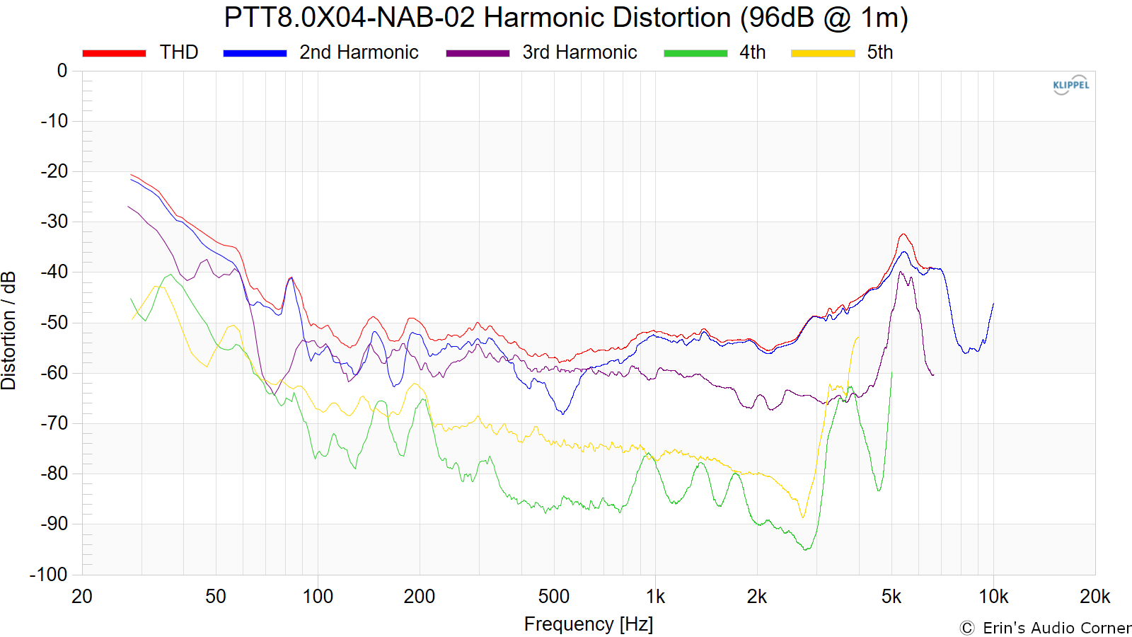

When the topic is harmonic distortion in loudspeakers the problem is not the lower orders (2nd, 3rd) but the higher ones. As an example I give you Erin Hardison's measurements of the MOFI Sourcepoint 8. This is a great sounding loudspeaker (based on limited listening to them in person). But the amount of 2nd order distortion below 200Hz is actually quite high. If Andrew Jones thought this sounded bad he would not release this design:
https://www.erinsaudiocorner.com/loudspeakers/mofi_8/
NOTE: scroll down to you see plots labeled "Harmonic Distortion". For the 96dB measurement the distortion reaches almost -20dB (10%) at 80Hz...
Higher orders distortions are not really reduced by current drive or motional feedback. Instead the driver itself must have low high-order distortion. IMD is another problem that will not be solved using current drive IIRC.

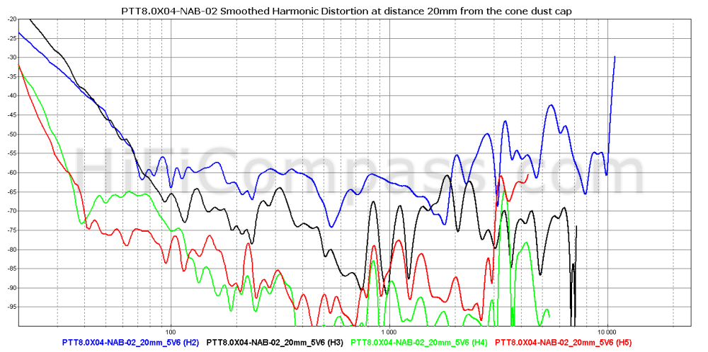

I also measured a Celestion CDX1-1446 in a somewhat less-well-controlled manner. The frequency response looks horrendous in part because I used a cheap cardioid dynamic mic without any correction. No EQ compensation was used in this case, but the responses aren't that far off above 2.5kHz:
The amp I used was an LM1875-based circuit with variable output impedance that I originally made for electric guitar use. Here's the measured distortion in "low-Z" mode (about 9Ω):
And in "high-Z" mode (about 70Ω at 2kHz, falling to 60Ω at 20kHz):
H3 drops almost 10dB above 2.5kHz.
