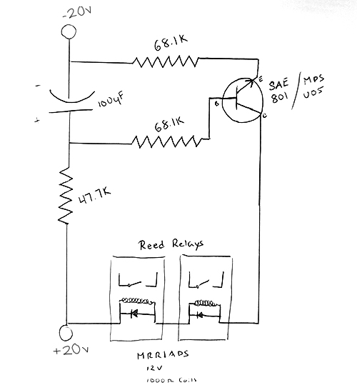

Improving Very Simple Time Delay Circuit
This shows the circuit as drawn in post #1. These are the static DC voltages for coils of 1k resistance.
Am I the only that can see at a glance that it could never work?
I see what you mean. There's a contradiction I need to resolve by measuring.
Interpreted one way, the resistors make the timing work but the switch fail. Interpreted to make the switch work, the timing fails. Something is amiss. I'll come back with definitive measurements in about 8 hours.

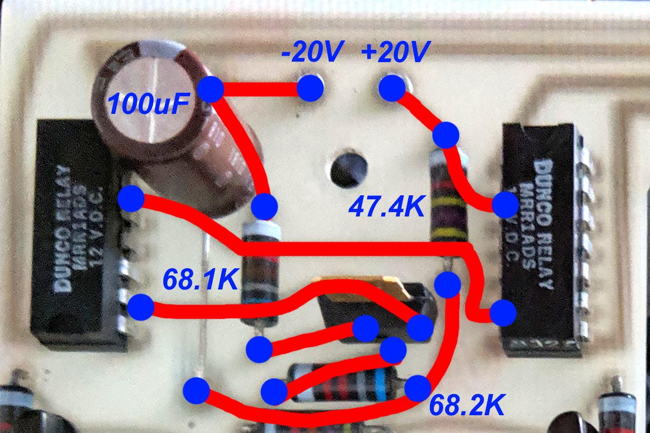

Here's my to-do list when I get my hands back in the preamp:
1.) Measure the resistors to get definitive values
2.) Measure the resistance of the relays
3.) Trace the entire relay circuit (including power supply and the audio side)
4.) Check for DC on the outputs
Anything else we need to resolve this impass?
It's more curiosity than anything else at this stage 🙂
If the relay gives a delay before it actually does close the contact then your noises are coming from elsewhere... which comes back to trying those bleeder resistors.
Thump type noise come from very abrupt changes in DC levels being passed on to the following amplifier stages. So try the bleed resistors to see if they help.
As to the component values, well if the basic diagram is correct then it looks like that mystery resistor will be more like 680 ohms.

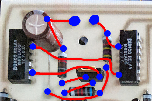

I was asked what leads to the relay circuit, so I went ahead and traced the audio circuit based on the photos I have.
Do these resistor values make sense? I used the method of reading the bands that would yield 680R instead of 68K.
Note, there are already 100K bleeder resistors before and after the relay.
Also note: the schematic I posted earlier and this new schematic below are my first two attempts at tracing a circuit. so I may have presented some things a little oddly. I'm mostly self taught and quite new at this.

Okay. Here we are. The measured, double checked, accurate schematics.
The relay circuit, confirmed by measurement:
I recapped the whole preamp before trying to solve the thump issue. I discovered there are already 100K bleeder resistors on both sides of the relay (See the drawing below). I measure no DC at the outputs. The coils of th relays measure 1453 ohms, so the second spec sheet I found was correct.
So now that we know the actual values and the above, what do we make of it?

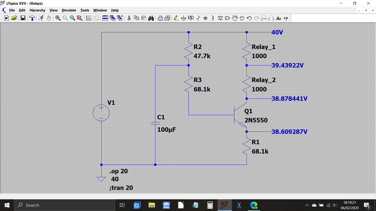

1.) I want to keep his 5 second startup delay, so I can either keep the 100uF cap and change the 470K resistor to 47K, or keep the 470K resistor and add a 1000uF cap. Yes? Changing the resistor seems like the better move.
2.) We now know we need 24V across 2.9K of relay coil. So 8.28mA of current. That means the emitter resistor should be 1.935K, so probably a 1.9K resistor.
Does that sound right? Any potential problem with those values I am not seeing?

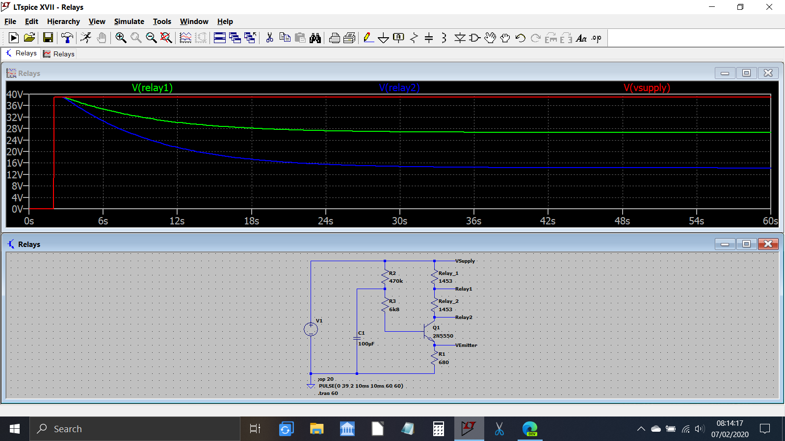

The full charge time for the 25 uF cap with the 100K resistor is around 12.5 seconds. If the mute circuit energizes the relays in 5 seconds that could be an issue right there. You could try substituting (temporarily) the 25 uF caps with 4.7 uF parts to see if the problem subsides.

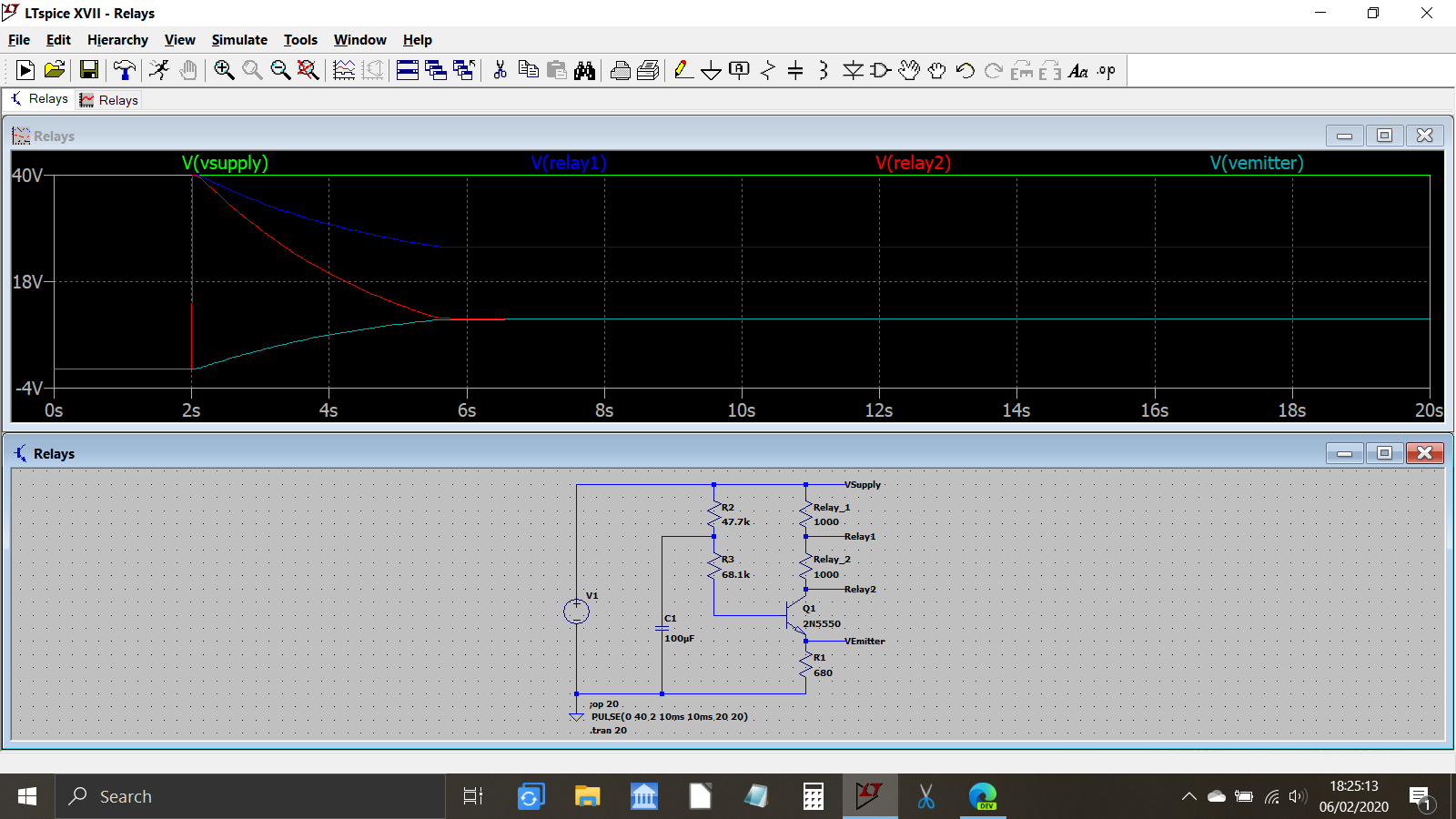

So with the new values we get this type of delay. You can see the supply voltage at the top and the two relay voltages below. Once the circuit settles there is around 12 volts across each coil. That happens around 15 seconds into the run.
Up to this point the voltage across each relay is increasing gradually, its ramping up. We can't give a definite mute time from this because it depends totally on what point the realy contact closes. For example it may gently close when there is perhaps 4 or volts across the coil, or it may need a bit more. We just don't know with certainty.
If you measure a 5 second delay in practice then that suggests the relay closes when there is around 6 volts across the coil.

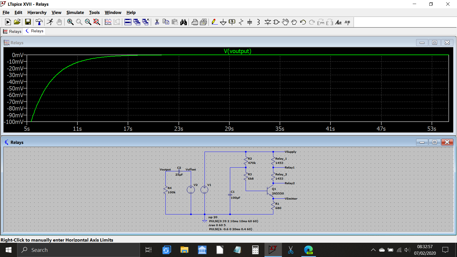

Lets look at your 25uF coupling cap situation. The only resistor value that matters is the first 100k because the second one has no impact on the settling time.

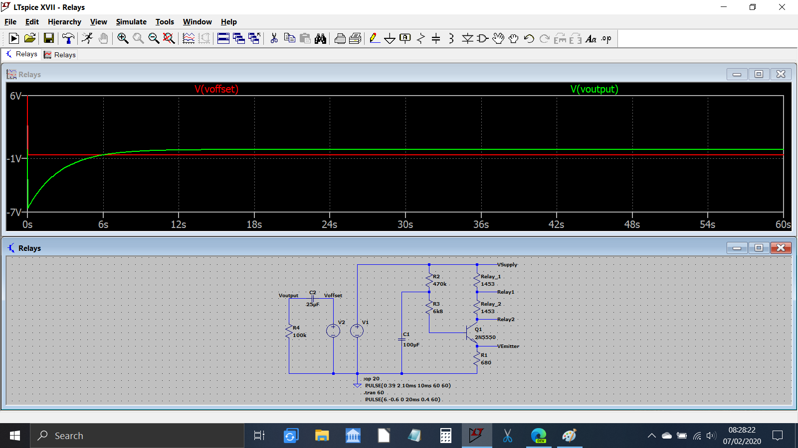

We will add to the simulation a stepped voltage and look at how the circuit settles. Lets guess and say the circuit generates an initial offset of say 6 volts and that this then falls to a final value of -0.6 volts (the emitter voltage of the final transistor. We will assume the actual circuit settles very quickly.
If we look closely we can see that the audio output doesn't reach 'almost' zero volts until around 15 seconds in. The scale is starting at 5 seconds in here to give better resolution.
So at 5 seconds we have a pretty large offset of over a 100mv. That will cause a massive thump if fed to a following stage like a power amp. At 15 seconds we have around 2.5 millivolts offset.
So to get a quiet delay needs the relay timing cap increasing to perhaps 680 or 820uF, however that may cause another issue because cap leakage current will become dominant in the timing circuit. The 470k doesn't pass much current and what it does pass is comparable to the cap leakage.
