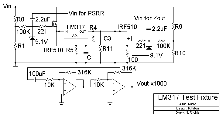

PSRR and Zout Regulator test fixture
This simple test fixture can be used with a scope, meter, or PC based FFT for testing Three Terminal Regulators for PSRR, Zout, and Transient response (oscilloscope only). Op amp supplies and their decoupling not shown. I use 9 volt batteries and 0.01 decoupling caps. Split gain between two op amps to get good bandwidth. The current change is 10 mA per volt. Ground Vin for load current mosfet when testing for PSRR and input transient response. R0/R1 AND R9/R10 can be replaced with two 100 K pots but I would use 10 or 20 turn pots for this. The output mosfet needs to be based to a greater DC drain current the AC current swing used for testing don't forget to add the current to any DC load current you have on the regulator when logging your test results. The change in current on the output is about 10mA per volt for input voltage to the current mosfet gate via the 2.2uF cap. Monitor the voltage across the 100 ohm resistor for the exactly value.
I posted this to show how simple and cheap a fixture for testing regulators can be, and to use for the testing the circuit mods that I hope will follow in this thread. It can also be used to test other regulator circuits but you will to use low noise op amps for decent resolution.
