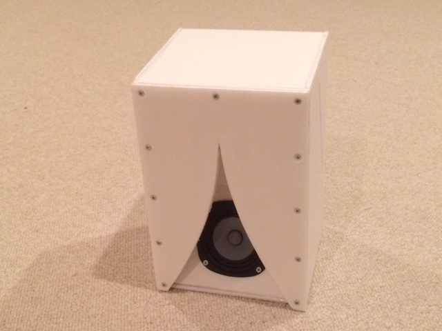

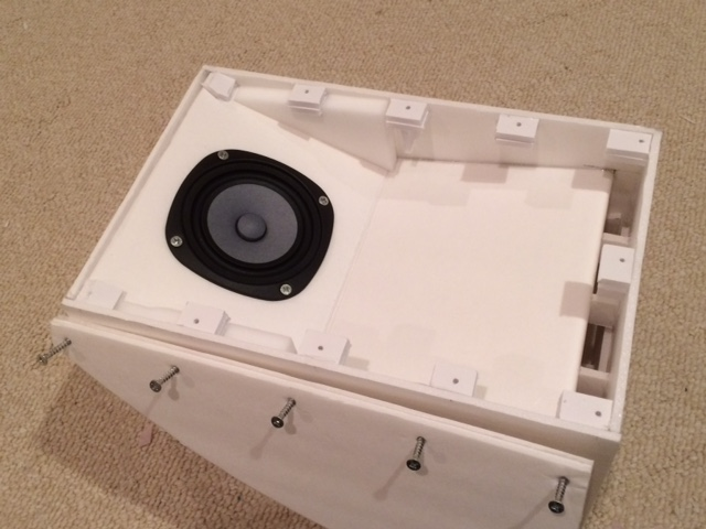

As it turns out, the cutout and bezel of the CHN-70 is an exact match with the RS40-1197 (FE-103). The swap was exceedingly easy as can be seen in the photo below. I just listened to it for a while before measurements. I noticed that compared to the RS40-1997, the bass extension was much better, the highs were less detailed, but the overall balance was much better than running bare faced in a sealed box. I put some jazz, vocals, classic rock through it. Most songs were actually quite pleasant to listen to.
Driver fits exactly where RS40-1197 went (probably same outline spec as Fostex Fx10x series):
Speaker with CHN-70 mounted:

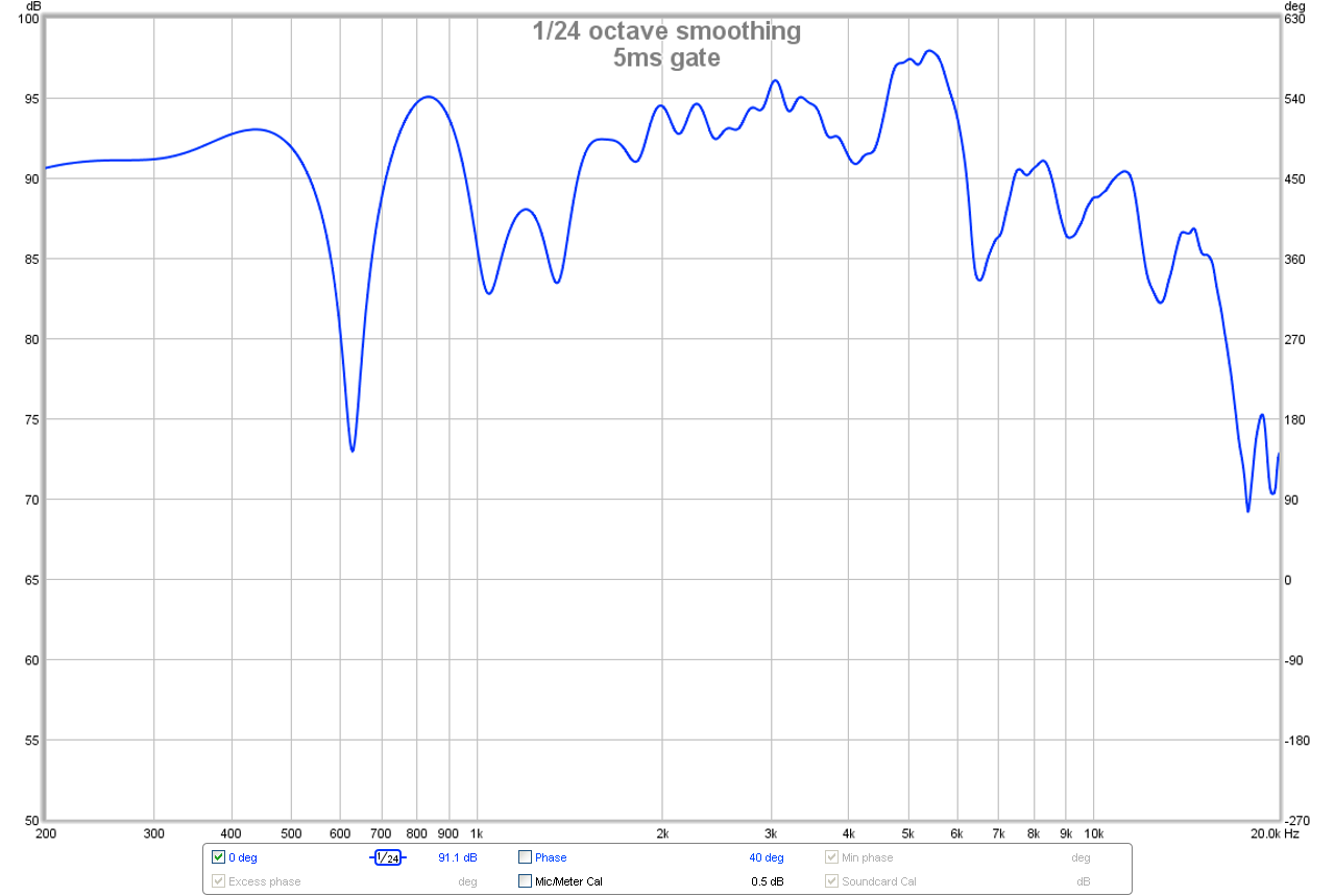

The measurement was made on a stand at 0.5m distance from dustcap-to-mic at 15 deg above horizonatal - a typical listening axis orientation. Bass extension is flat to 70Hz and +5dB better than the RS40-1997 at 70Hz. As a result, stand up bass sounded authoritative. The 9dB plateau from 600Hz to 7kHz now has several notches taken out of it from the K-aperture. Thus the elevated mids presence that was anoying before, is not gone for the most part. It made the driver actually tolerable for me. I would almost say that this enclosure is ideal for taming that mid plateau. I can recommend this enclosure for the CHN-70.

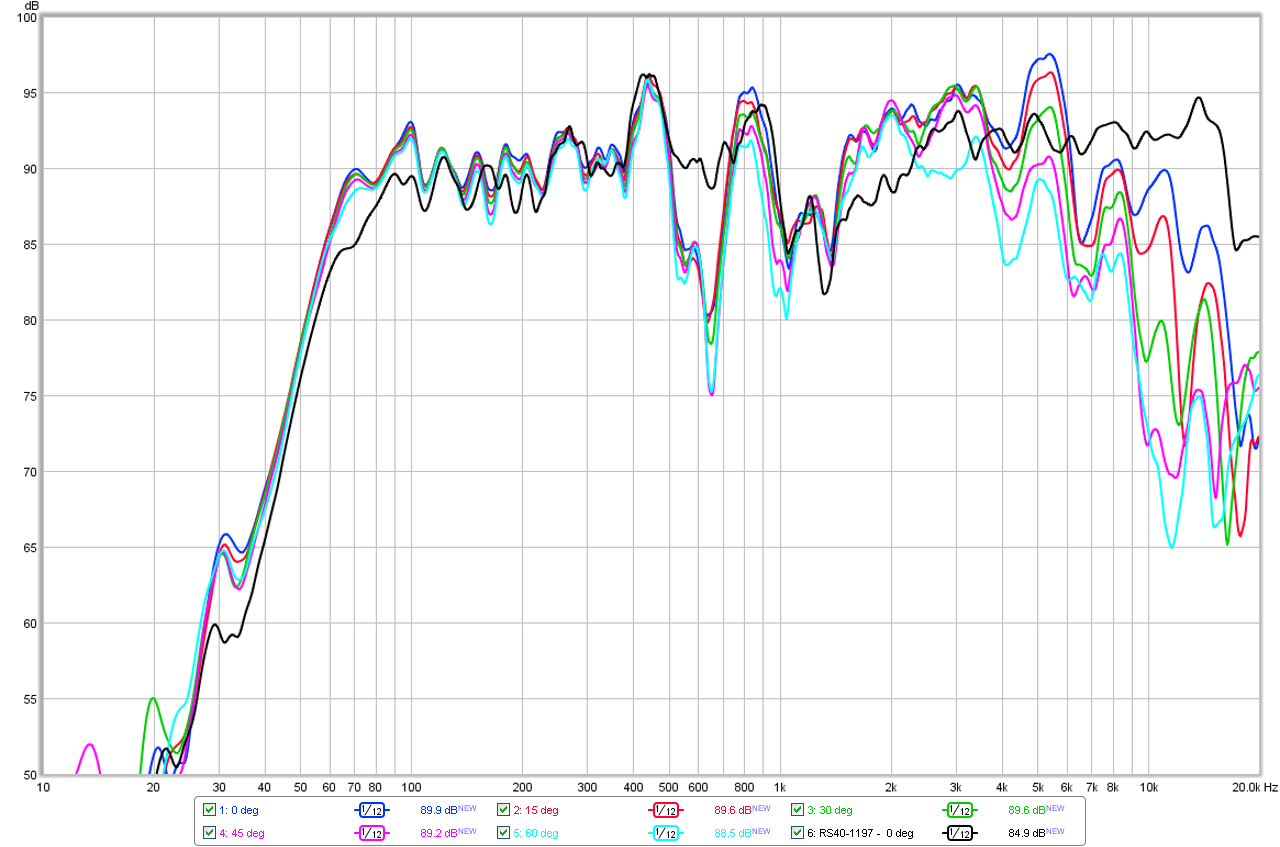

Here are the measurements at 0deg, 15deg, 45deg, and 60deg, and compared with 0deg of RS40-1197. Note that the K-aperture permits the polar responses to be remarkably uniform as a function of angle. Black is RS40-1197 for comparison:

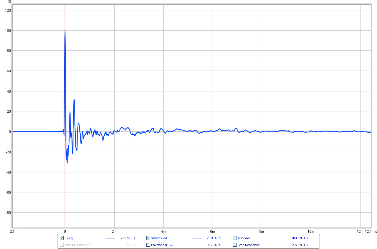

Here is the impulse response at 0deg:

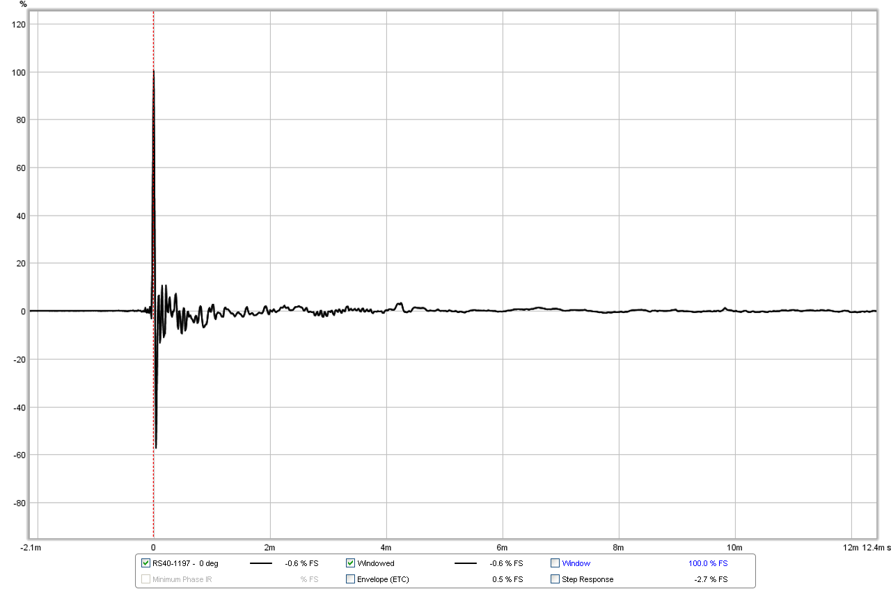

Compared to the IR from the RS40-1197 which is a lot cleaner:

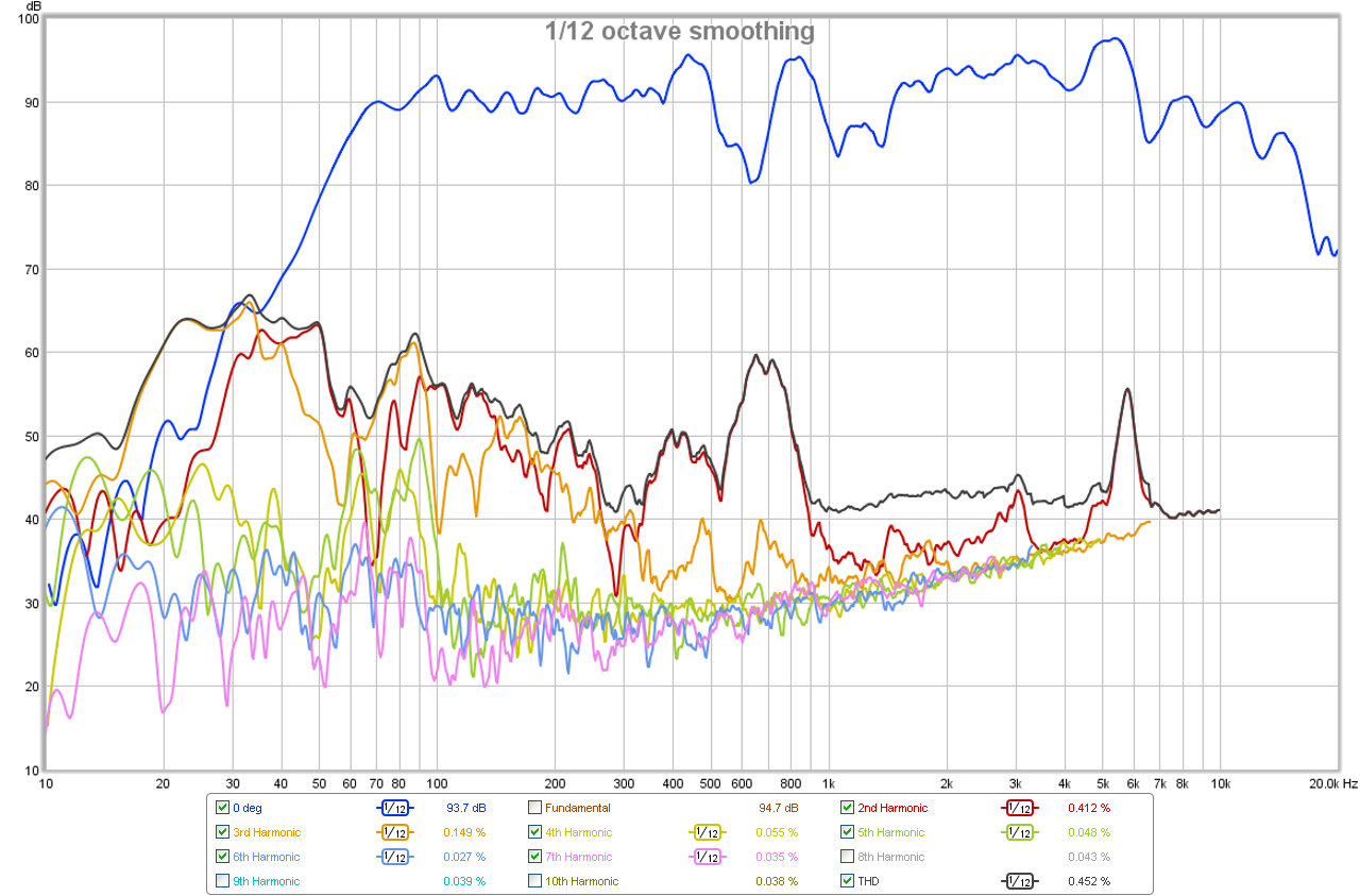

Here is the harmonic distortion - still has the peak in HD at 700Hz, this graph demonstrates the K'nator's remarkable ability to not need any baffle step compensation (this is a 4pi measurement):
