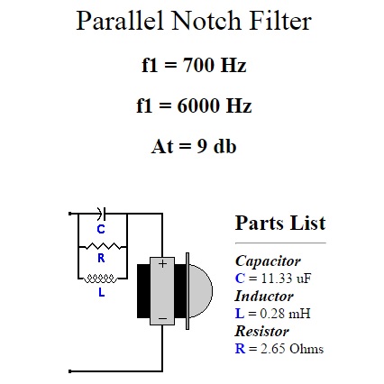

I'm not sure cone treatment is the answer, it doesn't look like errant resonances.
How about a simple EQ in series with the speaker ?
http://www.diyaudioandvideo.com/Calculator/ParallelNotchFilter/
or in parallel with the speaker
http://www.linkwitzlab.com/reference_earphones.htm

Because I don't think it's an issue of peakiness at the top end. Based on the FR plots posted earlier it looks like there is a broad response between 600Hz and 7kHz that is raised higher and this makes the driver forward sounding. If it's not a peak, caused by resonance/cone break-up for example, then it needs a different solution. Do you think there is a mechanical solution that will work over the 600Hz to 7kHz range without messing up the behaviour elsewhere ?
I was thinking that if the FR was bothering you a broad shelving filter (similar to post 29, but i doubt it needs to be that deep) to bring down the offending range would be something to try.
