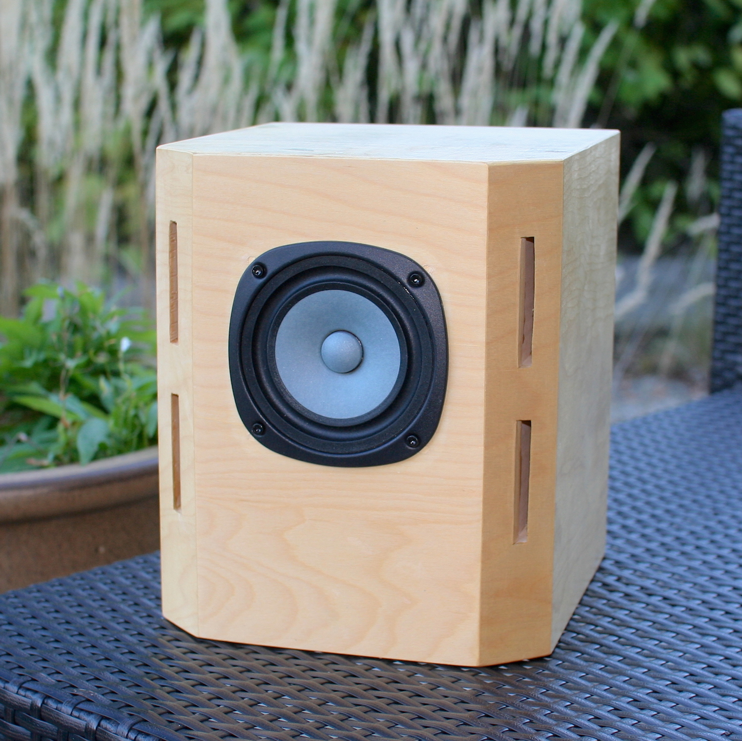

I have not finished breaking in this driver but I have had some experience with breaking in drivers and find that a lot of the inherent nature of the driver becomes clearer after the first tens of hours. I'm at that point now.
These are nice drivers, they sound pretty neutral to me, plenty of clarify. I have my copy (one only) in a 6 lite onken-type box and driven from a hollow-state spud amp there is no shortage of bass, mid or top-end. Final application is t.b.d. but probably small-space or desktop (not that they are limited to this).
I have noticed a tendency to be a little bright at the top-end. At the limit of my hearing (somewhere near 14kHz) there is a tendency for narrower dispersion but I wouldn't call it beaming.
More break-in will tell more. But whilst I'm looking at this driver I was curious whether there have been any eNable or similar treatments and observations ?

Very cute driver and box. It looks like the paper coned version. I just coated the back of a similarly sized Dayton PS95 - with paper cone - in hopes of reducing excessive treble with dammar - $8 plus a small brush for $1.49. I'll let you know how it works out.

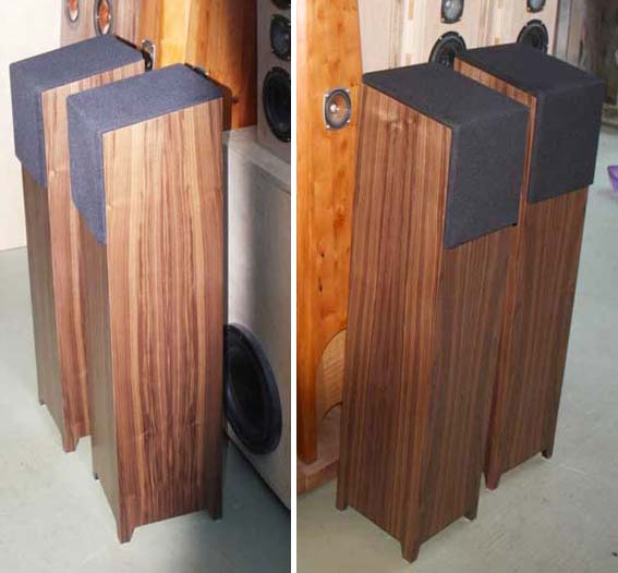

I have a pair of them per side running in another variant of one of my favorite enclosures- the Castle Microtower, and they can definitely use a little help at the deep end, but are otherwise quite a fun listen. I'm not at home right now to confirm, and as I've built at least a dozen pair of different enclosures so far this year, I can hardly remember what degree of treatment they might have, but suspect I'd find polka-dots.

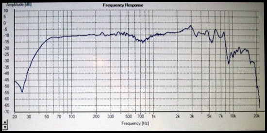

I wonder if the Wild Burro Betsy has a similar sound to the Mark Audio drivers. Attached is the Betsy WOW (without whizzer) frequncy response. It reminds me a little of the CHN-70.

The CHN was designed specifically to have a tailored FR requested by the Japanese distributor.
Despite that we found them quite pleasant, with good DDR (detail+). We listened in both stock & EnABLed form. We ended up putting them into a set of microTower Castles.
I got a lot of flack about their FR as the EnABLed CHN were the 1st thing available when we needed something to compare to the VIFA TC9 -- the CHN just killed them.
