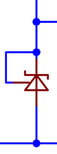

Could the rejection be increased if the TL431 (A / K+ ref = 2.5V) were used instead of the LED reference?

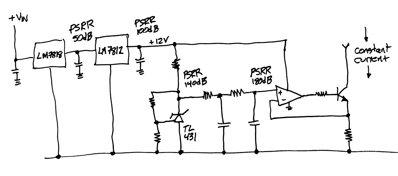

The straightforward way to improve CCS PSRR is to stop trying to make a "simple" circuit, and instead embrace an obvious tradeoff: bigger parts-count gives bigger PSRR. Cascading several filtering stages increases PSRR.
For people who worry about temperature effects: use bandgap reference ICs whose tempco has been carefully nulled by experts. Voltage regulator ICs, shunt voltage reference ICs, that sort of thing. Here is an illustrative example:
_

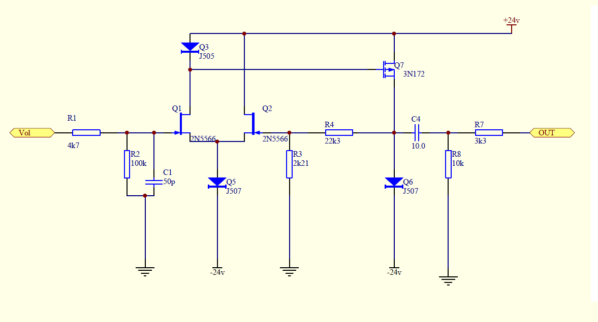

Somewhere on this site I found a schematic purporting to be the Threshold FET2 preamp by Nelson Pass. It features three current regulating diodes from the Siliconix J500 line. Linear Systems still makes and sells the J500 series of CRDs today, here is their datasheet
_
