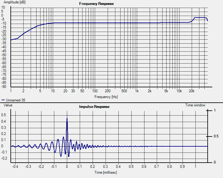

Reading a graph is easier than reading numbers. You don't need to even have numbers on the axis to get an idea where your frequency response is relative to any one point on the graph.
This plot uses the free software HolmImpulse. It is one of my speakers, but you can do the same thing with a line stage as if it was a loopback test.

You do one sweep with the preamp bypassed and use that as a calibration run.
The sweep takes about a second or two to get meaningful information. You can then do the same with any other line stage to get a reference, but in either case the response should be ruler flat. If it is not, at least any changes you make you can see if you are making progress and you won't need a blindfold.

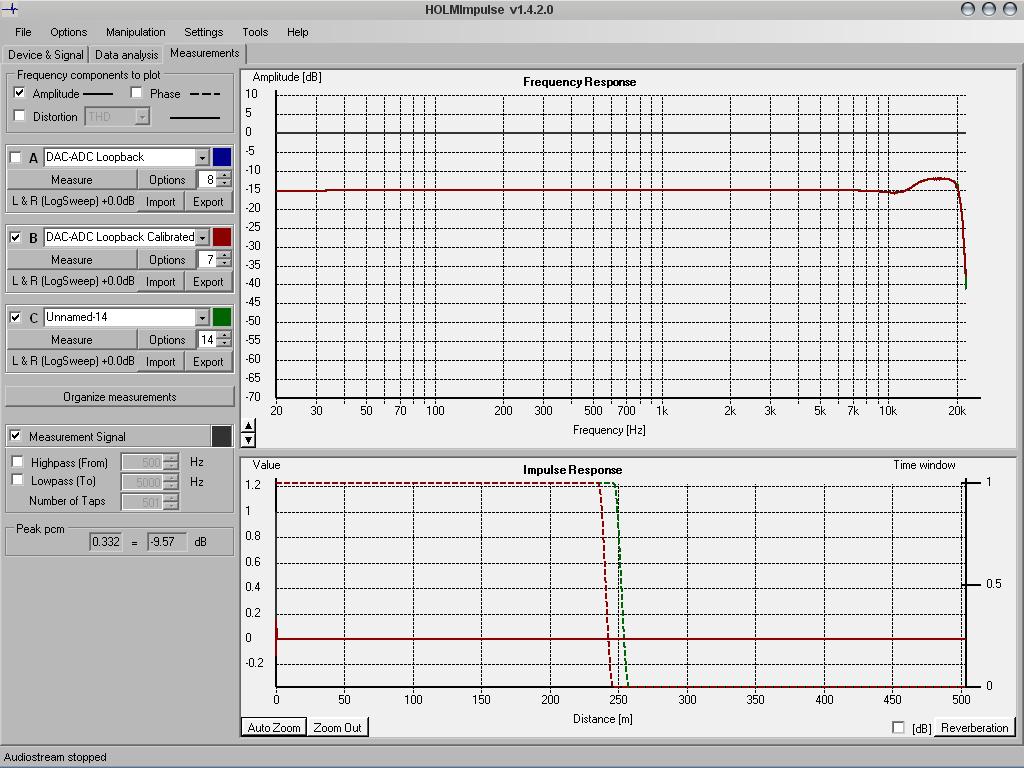

Well, since Loren insists....
I'm almost sure I did something wrong, maybe Loren can tell me.

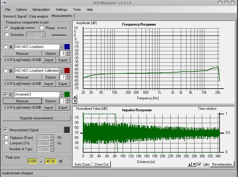

Yes that doesn't look right at all 😉 I think probably your levels are too low for starters (your impulse response should be a hell of a lot cleaner than that!!
What did a loopback of the sound card look like?
Certainly if the FR curve presented is indicative of the FR of your preamp then I'm not surprised you think it sounds bass shy 😉 rising response from about 500Hz up around 5db by 10Khz, and starts rolling off at around 80Hz down by 5 db by 20Hz....
edit: I can't find my loopback cable, but here is a quick and dirty measurement of my Sound Card preamp that I use for buffering stuff I'm testing. Not sure what is going on above 20K (I'm pretty sure it didn't used to do that) but it gives you an idea as to what you should be seeing. Note you should go into options and change to raw response rather than gated as well, when you are doing line level measurements 🙂
I think I have sorted out my amplitude problems. I'm still wary of false readings.
