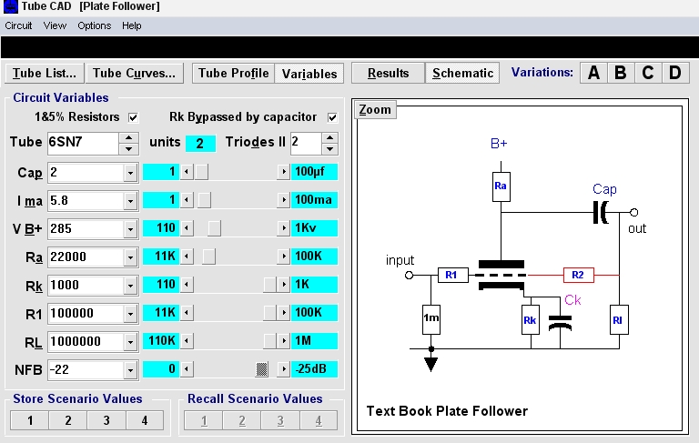

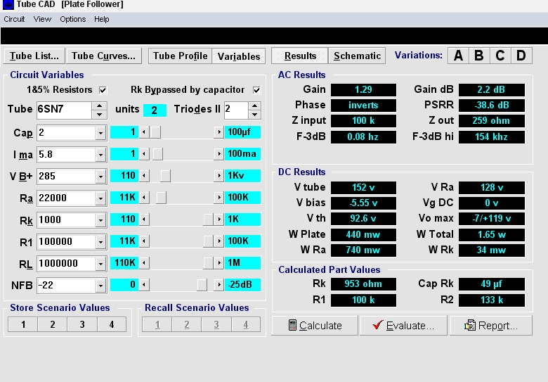

This is a tube circuit configuration I've not seen before, but tracing out the circuit and especially knowing the values helps to show what's happening.
This is working like an op amp with the positive input grounded. The signal is going through R1 (100k) to the negative input, and the output is connected back to the negative input through R2 (130k), thus the gain is -1.3.
This circuit also makes the grid a virtual ground, so the input impedance seen by the instrument is 100k (or for an "exact" number, it's in parallel with 1M, so the impedance seen is 90.9k), significantly lower than is good for most electromagnetic pickup instruments. The instrument needs to see 1M, and the 1M to ground just provides an illusion. Due to the feedback resistor, the grid is effectively a very LOW impedance, not a very high impedance that it is in more conventional circuits. If this is meant to be some sort of tube buffer, it's doing a bad job. The effect of this load on the pickup must be taken into account to get an accurate frequency response.
Also, since (once again) the grid is a virtual ground, the impedance the output "Cap" drives is RL in parallel with R2 (56.5k), so the resulting low frequency cutoff should be recalculated (though I don't think that's a problem).
Even more, a bass guitar only goes down to 41Hz, unless it's a 5-string bass with a low B, which is 31Hz.
Musically, it may be this lower impedance loading the pickup that makes the mids magic you like, and it may not be easy to get the lows back the way a fully buffered circuit would without changing the mids. Maybe the lows could be boosted in a second stage added to the output of this one.
If you must use "old" parts, go for high quality NOS (New Old Stock, unused parts). They might be more expensive, but I know I've got some ceramic miniature tube sockets somewhere that cost me something like a couple dollars each.Anyway, even though I haven't had the time to try out possible fixes I have spotted a problem with one tube: one of the triode's filaments was underpowered, seriously underpowered. Barely glowing. The triode with problems was facing the wall so I really don't know when the problem started. Turns out my bakelite socket is acting up; my fault really, I have a soft spot for vintage parts and sometimes **** happens. Now I have to replace the sockets and possibly change the schematic. No more news from me in a while. Thanks to all.
Great, now that explains how the circuit works. The tube is acting as a fairly high gain (maybe 20 to 100 - regardless, it's a lot higher than the whole circuit), with a negative feedback path through R2.Value of R2 is 130K.
