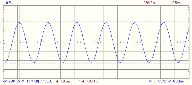

OK, here it goes.
********** TEST 1 **********
On page 3-5 of the manual, section 3-48 there is an Oscillator test. I followed it but my device desnt axactly behave as expected. Step 'J' says the meter should indicate 0dbm and stay that way. But my meter starts to move up as I down-range the level. At 3mV, its about 0.5dbm off. I dont know how accurate this should be, but the manual clearly states it should read exactly 0dbm.
********** TEST 2 **********
At high frequencies (above 10K) my DMMs start to get a reading far off from the voltages indicated by the HP... DMM indicate 6mV, HP indicates 4mV. But then, this *moght* be the DMM's fault.
At 100K, my DMMs always read 3mV (on the 10mV level on the HP), no matter how I turn the level vernier. But, the HP meter does move indicating a change in output.
********** TEST 3 **********
After turning my whole house into a mess, I managed to find a 1K 1% resistor and a 1R 1% resistor (that is the best I have on hand).
I measured them with my Fluke and they seem to be well within their tolerances.
Got a 12V transformer, plugged it in my VARIAC and set the output to exactly 10.10V… this way, I should get 10mV across the 1R resistor.
Now, the readings:
FLUKE $300 DMM: 11.7mV
ANOTHER FLUKE $300 DMM: 10.6mV
MINIPA $60 BRAZILIAN DMM: 10.0mV
Now, time for the analyzer…. And it measure 9.9mV! Not bad…. But then, can I trust it? Not sure.
Obviously this was a 60Hz wave, as I don’t have any means to turn my mains to other frequencies. This Minipa DMM is NOT True RMS and its cheap. The analyzer and my Minipa seem to agree, but I don’t like the fact they don’t match the Fluke readings.
Im starting to realize I was living in a world of illusion.
********** END OF TESTS **********
So, now I need some advice:
1-Does the result of TEST1 indicate I have a big problem?
2-What about TEST 2? Most probably my DMMs can be trusted for high frequencies, right?
3-I dont know what to think about TEST 3. Any opinions are really welcome.

1. -Yes, you have a basic problem there. Make sure there is no static electricity built up on the meter face. It's a long shot, but who knows?
2. -No, you can not assume anything. You can build an oscillator running at 50 KHz or so. If it is outputting a sine wave (check with your 'scope), you can compare the instruments but you will still not know where you are. You will know which meters read high or low from the average.
3. -You may have some problems with very low voltages. The shielding of the meter will come into play, as well as possible stray field pickup. The target for basic calibration on most meters (3 1/2 digit) will be about 1.9 V, or somewhere close to that. You want to be near the top of scale, but far enough down so you are not going above the top limit. Checking points are near bottom scale, mid scale and near top scale at the very minimum. That's to confirm your zero point, midrange for linearity and top for span correction. Some transfer characteristics are not linear.
Take care that your resistors do not self heat, they will change value. That is one reason that standard resistance assets are enormous. The test current should not change the temperature far from ambient.

I tried to scope the monitor output of my HP, but, set to the OSCILLATOR LEVEL function, the output is disabled. So, I just connect the oscillator output to the distortion input and set the HP to INPUT LEVEL. This way the monitor out gets enabled.
But, I have a question.. how can I determine the noise, since its an AC wave we have here??
Here are two scope shots.
SCOPE OUTPUT NUMBER 1
Here is the output with the oscillator set to 3V and 1kHz. The HP meter was set to 0dbm exactly.
