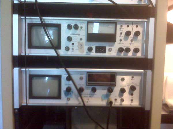

I was in my wife's laboratory day -- and there were a pair 0f "Correlators" in there -- used with the rats (as expected).
It's in the part of the lab in which the critters attain their useful end.
BSGD -
