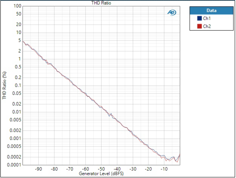

Besides the THD+N it could be interesting to see the THD, so without the noise.

I do have THD results as well. Here is a graph from the VREF=5V case, from the same run I posted before the THD+N. At 0 dBFS THD+N is pretty much dominated by THD as can be expected, below that noise contributes more.
I could maybe extract more numbers from there but the lowest values are somewhere in the -116..-118 dB ballpark (and again, I forgot to change % to dB..).
Jens, you got to the better side of -120 dB with your analyzer?
In fact, I did not check THD only numbers with large extra capacitors so this is something I should still check. Too many variables!
Yes, at -20dBFS I typically get just below -120dB THD.
Perhaps you are limited by the AP analyzer? It looks like your results are limited by noise. I normally use a large FFT window (512k) to suppress the noise floor in order to see the harmonics.
