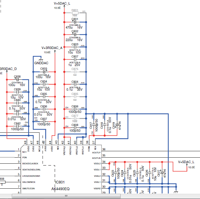

Hi ,
this is from a well known product.
I find it intresting....

Hi ,
To me it looks like they don't really know what they're doing, just fire all types of caps there thinking each one cures different type of issues. I suspect could remove most of them without much impact.
In general it is not a good idea to put so many different value caps in parallel, especially not so close values. You get nasty resonance spikes in the impedance curve. For digital decoupling you basically want many equal value caps in parallel to bring the parasitic inductance down but without creating these nasty spikes. In analog/low-f you want big caps and maybe one small in parallel.
I may be wrong of course 🙂 Maybe they have evaluated that. But for example Henry Ott has good material on measurements of parallel caps, and showing that different values often create more issues than benefits.

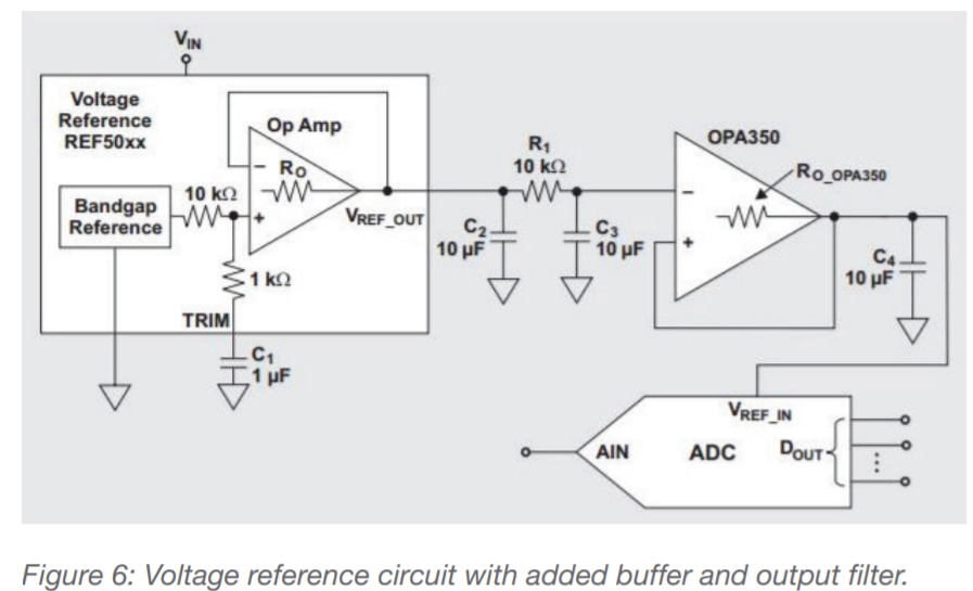

Try treating Vref as a low impedance node where packets of charge are taken from rather than something held up by capacitance. Firstly low pass filter your voltage reference to remove high frequency noise, then feed into an appropriate bandwidth (select based on converters true conversion clock) low noise opamp which feeds the Vref pin on your converter. http://www.ti.com/lit/ml/slyc147/slyc147.pdf (see figure 6).
Getting wideband low impedance is surprisingly nontrivial. Looks like that's what they were shooting for here. Pretty much a cap every decade sounds about right if you don't want any nasty surprises. (And look at all the unpopulated spots.) I'd imagine this should get the job done well into the dozens of MHz. Not sure why Vref needs this (I mean, the actual DAC is operating in the double-digit MHz, but still), but the datasheet of another AKM DAC puts great emphasis on VREFH-VREFL having to be very clean (up to the point of using 10 ohm resistors in series with both to exploit the bypass caps for RC filtering), including keeping all kinds of clocks away from them. So clearly "Vref hygiene" is Important Stuff.
The figure 6 below looks a lot like what we use for AVCC (the dac reference voltage) for ESS mobile dacs (ES9038Q2M). Except we use LTC6655 as the reference, and the opamp is OPA1612 or AD797. It works very well for that application.
EDIT: To be a little more clear, we use one OPA1612 or two AD797. One opamp for each dac channel maintains best stereo separation.

Ok, interesting to see that in a high volume product. I would imagine they have done their tests then. I don't doubt it not working but think there could be an easier and cheaper way for the same result - if all those caps are even populated.
We can only hope they probed the impedance right at the chip's pins with a network analyser...
In general, I agree with you. Paralleling ceramics (or any low-ESR caps) of different values staggered in more than 3:1 rations most often leads to disaster.
Interesting they're using that over something like the LTC3042 or its brethren. Then again, mobile application is going to have different needs, and be originally running from a battery, so the bandgap vref is probably the noisiest thing around!
I guess one could use LT3042 as a reference, but not as the buffer. People try that frequently and always say it sounds much better with an opamp buffer. In fact, a few people have stopped using LDO regulators for anything having to do with dacs. That sure looks like an over reaction, as other people report very good results using ADM7150 or ADM7154 for AVCC. One regulator for each channel, of course. Have to try those ADM715x devices sometime myself.
Can you (safely) actively drive the reference pins of the AKM DACs? I don't think the datasheet says much about it.
