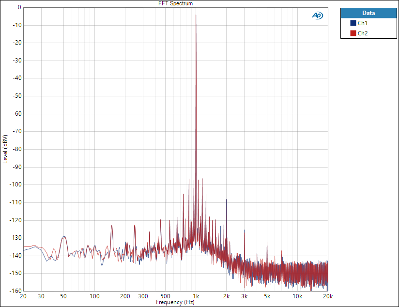

THD+N ratio vs amplitude (I like dBs but forgot this to %), THD+N level vs amplitude, and THD+N vs frequency, and FFT 1k 0dBFS plots below.
I also put schematic. Basically on board I have 100n+100u on all supplies, except now in these mods I have soldered extra caps. And as a sidenote, output filter is not a limiting factor here, I have also measured directly from DAC output.

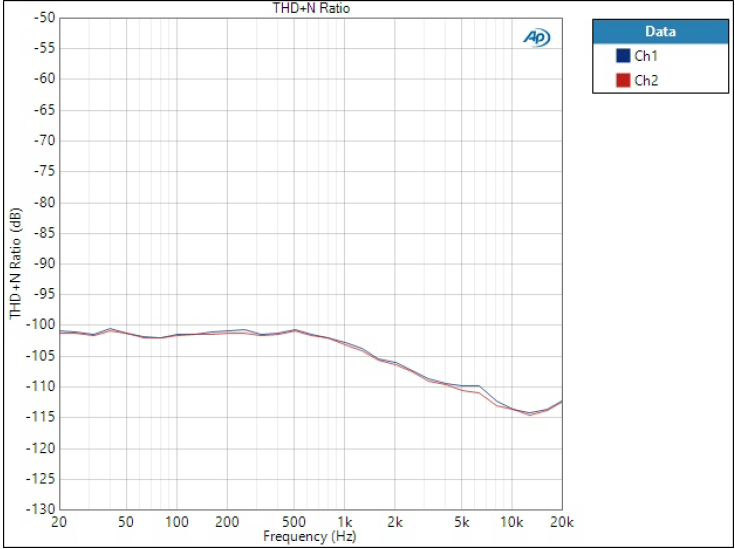

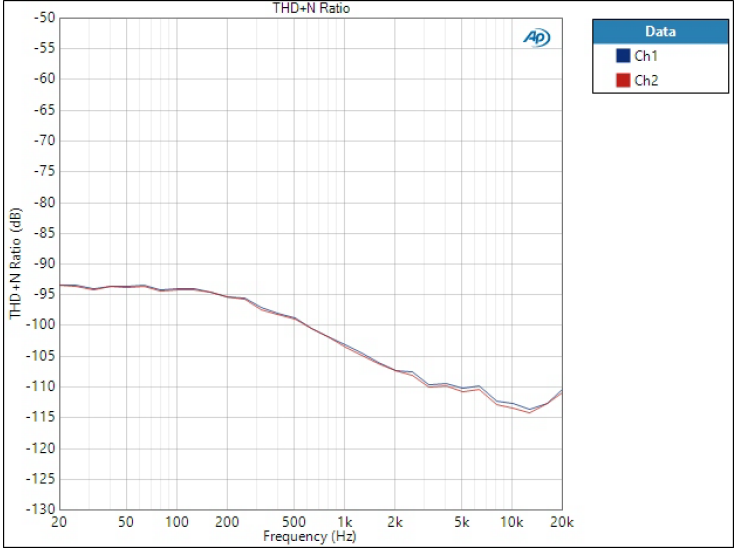

- 5V line (goes to VDDR/L and VREFR/L) is a sensitive one; my initial THD at 0dBFS was -93dB and I saw weird sidelobes on FFT. Apparently the bench PSU providing this was not good enough, after changing to the PSU baseboard I got rid of those. I suspect VREFs are the more sensitive ones. Need to do more tests on this.
- Adding large capacitance on VREF improves THD+N significantly (as is known - although datasheet does not say it anymore!). However, my THD+N vs. frequency still shows elevated distortion at lower frequencies.
- In fact, VREF capacitance seem to matter the most, even removing other caps do not change performance much.

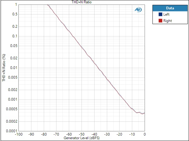

- I see THD+N sweet spot at around -6dBFS.
- Increasing VREF (I've only tried 6.2V as my caps were 6.3V) improves THD+N ratio slightly at lower signal levels, close to full-scale things get worse. THD+N level actually remains constant but ratio improves due to increased signal level. Obviously this improves SNR directly.
- Playing one channel at a time shows an improvement of around 2dB to stereo.
So I have got from -93 dB to -108dB (0dBFS), the latter with 2200uF on VREF, voltage kept at 5V. Obviously these have been ugly mods and it can be tricky to fit lots of capacitance on such a tiny board. I also have some layout changes I will do for next revision. I probably will also make a bigger board for experimenting but will see now what I can get out on that form factor.

- Full scale output level: 2Vrms
- THD+N at 0dBFS: -108dB
- SNR/DR: 119 dBA
- Crosstalk at 10kHz: around -130dB

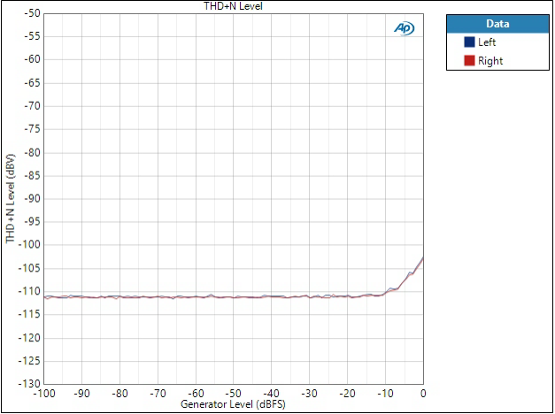

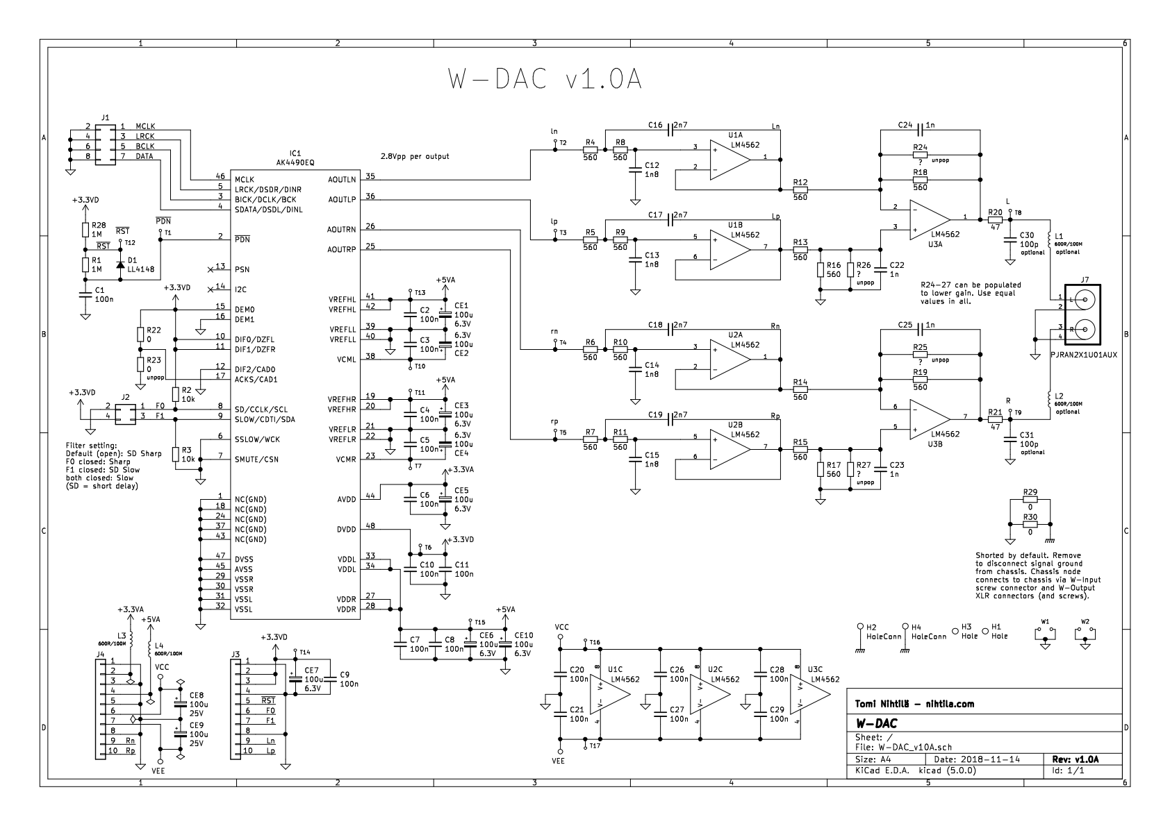

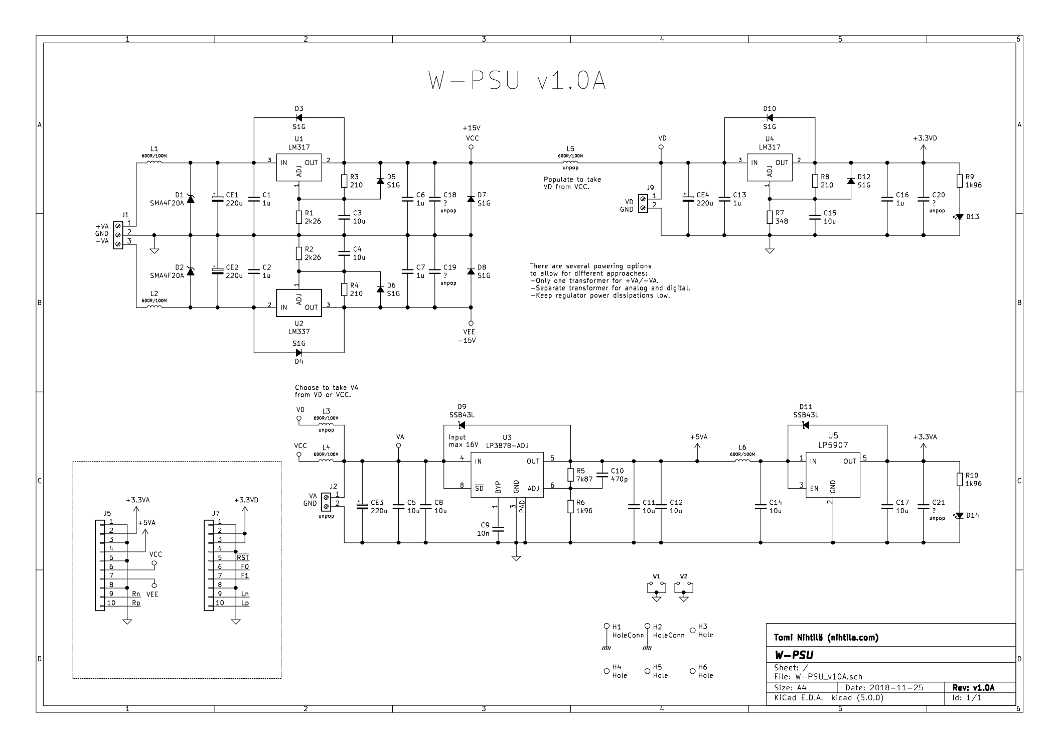

Oh, and here is schematic of the PSU baseboard. So all power lines go through pinheaders which is of course not ideal.

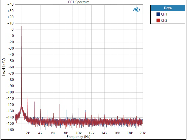

As I mentioned, first round of measurements were done with bench PSUs powering all supplies. See the resulting 1kHz FFT! I haven't seen such FFT before.

The FFT from the first round of measurements looks familiar! I saw something similar at one point, where the LDO was not set up correctly, so the ripple rejection was bad.
You have some noise at 1 kHz +/- 50 Hz, +/- 150 Hz and +/- 250 Hz. These are "mixer products" that you get from the 1 kHz tone and hum on the VREF supply.

1. R4 to R7 are too high, loads DAC outputs and rise THD. Try to increase them at least to 2k7-3k9. Yours value mean that high-resistance Sennheiser HD800 could be used straightly with DAC outputs while coil inductance would filter out aliases... 😉
2. Try one stage 3-order Bessel envelope filter based on the fully-differential THS4131.

3. Series supply-regulators are ugly, go to shunt ones.

1. No. The DAC will not see a load equivalent to the resistor values. It will be much higher. I would rather reduce the values to reduce the noise. I used 220 ohm in the RTX6001.
2. I don't think this will improve the distortion. It will give a higher load on the DAC.
3. As long as the output impedance is low enough and the noise is very low, the regulator type should not matter. Can you measure the difference as nihtila asked for? I used an LT3042 in the RTX6001.

1. The impedance of the filter caps are quite high at lower (=audio) frequencies so the loading of the DAC should be within specs; and at DC there is basically no loading at all. As Jens said, going higher resistances will introduce extra noise. Even if this is nothing extremely quiet, -112 dBV or so noise at audio band is quite low and easily increases when resistors go to k-range.
2. Fully differential circuits load even more as you need to have low resistances to get noise low. Unless you buffer the outputs, and then you don't win anything anymore. Fully differential opamps seem to be more expensive as well.

I agree with Jens suggestion to use a better regulator and place it adjacent to the DAC on the same PCB using +15V as the source. I think LP3878 probably has noise levels low enough, but the ripple rejection >1kHz is nothing to write home about.
In the meantime you could try out remote sensing for the regulator you have. Connect R5 and C10 on the regulator board with a (short) wire to +5VA on the DAC board.

And having the "sweet-spot" for THD at -10 to -6dBFS in very normal for delta-sigma converters.
You have reached -110dB at -10dBFS, I think that is quite respectable compared with the datasheet, how low distortion do you aim to get out of this chip? Which AP analyzer are you using? You may be getting close to its limits as well.

Your values for R4,R5; R8,R9 - seem to be low. (560)
The AK4490's recommended load is about 2kohm.
Did You try to raise these values?

ojg, nihtila , I was likely incorrect. If it is the case, freuency-THD+N plot must increase depending on the frequency.

See the whole circuit and not just resistor values. Resistors connect the output to the opamp input = extremely high impedance. It is the capacitors that matter, and their value is tens of kohm at 1 kHz, for example, when doing basic THD measurement.

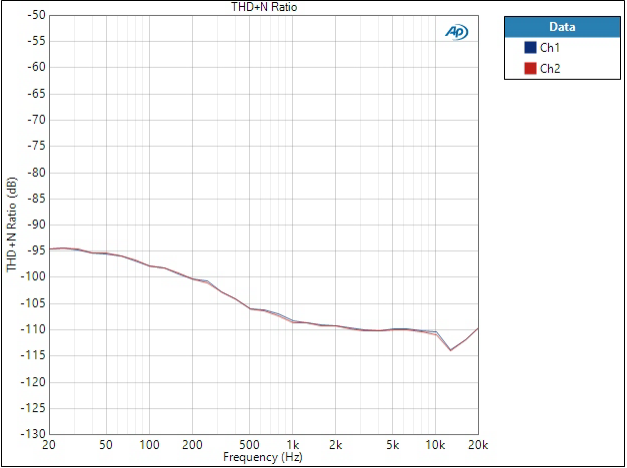

I got some polymer caps yesterday and did a quick measurement after work. No improvement, in this case it seems to be just about the capacitance and not really how good the cap is. This was quick and ugly test though, it's a bit tricky to put caps on my tiny PCB.
I also tried a quick mod by wiring the 5VA reg voltage sensing point from the DAC board, as suggested by ojg. This is quite ugly mod also as the wire is not that short. THD+N at 1kHz remained the same BUT lower frequency distortion got better, see graphs (this is with 680u tantalum polymer I was able to fit on the board, first normally and second with the sense wire mod). This gives some confidence that on-board regulation would improve the lower frequency distortion, and hopefully will push the 1kHz range down as well when all are on solid copper instead of flying wire.

Your issues would seem to reflect LP3878 noise levels, which are quite high below 1-2 kHz in particular according to the datasheet. In hindsight (which proverbially is 20/20, I know), maybe not the best candidate for +5VA. I'd suggest trying a larger capacitor on the BYPASS pin, which would seem to be filtering the voltage reference. The datasheet insists on something low leakage - if you have some 220-470 nF films around, try one of those.
It is unfortunate that the capacitor in parallel to R1 is already used for some pole/zero trickery, but what you could try is another RC combo in parallel to both - an electrolytic in series with maybe the same value as R2 (or half that). This would make the regulator act like a 2 V (or 1.5 V) one for AC, with correspondingly reduced noise gain. I'd try 1 kOhm + 10-22 µF (low ESR not needed for obvious reasons... quite the contrary, you want lowish leakage).
With as much capacitance as you have on the VREF pins now, a bit of series R (as mentioned before) is in fact also worth a shot. RC filtering always works much better if R isn't just regulator output impedance, for obvious reasons.
Using two mono DACs in differential output mode avoids a lot of these problems, as the Vref noise subtracts (so it's got inherent PSRR).

It is interesting that the AKM DACS all seem to require lots of VREF capacitance, 1000uF or more, while the similar spec'ed DACS from TI or AD do not have these requirements. What is the inherent difference in DAC design that causes this?
Why not try a Jung/Didden regulator for +5VA?
Some more armchair-engineering: As much as I like small cute PCBs, it seems in this case it might be limiting the performance you can get. With a larger PCB, perhaps the same size as your PSU board, you would have room for more VREF capacitance and a +5VA regulator.
Capacitance requirement can be quite crazy. In my ugly mods there was a significant change still going from 2200u to 2x2200u. But I hope when I get a good regulator on-board it would not require that much anymore. Odd thing in this is also that why AKM removed the graph from AK4490 datasheet (or EVB manual) showing the impact of VREF cap on low frequency THD? And they don't even use large capacitors on their EVB, nor are the regulators on the same board as the DAC. I really doubt they measure the claimed performance on that board.
I will need changes on all boards but the XLR one so I will re-consider the form factor and interface. At least the interface will change, I will likely have 5VD, 5VA, +15VA, and -15VA, and then use on-board regulators for 3.3V voltages and also for 5-7V for VREFs and such. Also remove two pins from one side for simple keying. Therefore, I can think of making the boards larger but will need to check cost impact as well.
It would be nice to have a bit more information on all the supplies other than VREF, such as AVDD or VDDL/R; how sensitive are those to noise and interference. Will try to do some simple tests on the test board when I have it.
