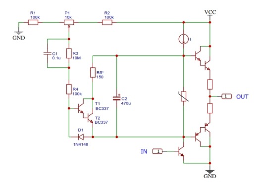

Class AB amplifiers are gradually being replaced by class D amplifiers. More and more old AB amps are being thrown away. But this is toxic waste for the environment. Alternatively you can significantly improve the sound quality of the first watt and keep using the old amps. The circuit is in the appendix. You can make from it a piggyback-board. It is connected parallel to the bias network. But before that, set the quiescent current to about 1A. After connecting the piggyback-board, set the quiescent current to 20mA with the potentiometer P1 of the piggyback-board. And that's it. When the small audio signal comes, the quiescent current increases to 1A and the amplifier works as class A. If the output power is more than 1 watt, the quiescent current drops and over 10 watts is less than 0.1A. And it continues to decrease at higher output powers.

The quiescent current is set by the bias voltage. Can you explain how the (small) audio signal is changing this setting?
...If the output power is more than 1 watt, the quiescent current drops...
How is this controlled, and why 1W and not 2W, or 0.5W or 3.1415926W?
All this circuit does is drawing some current from the current source "I", a little bit more with a negative going signal, or a little bit less with a positive going signal. Less current from "I" is available for the bias circuit, causing the darlingtons to switch off at lower bias / q-current settings.
Can you show a simulation of this controlled bias / q-current behaviour?

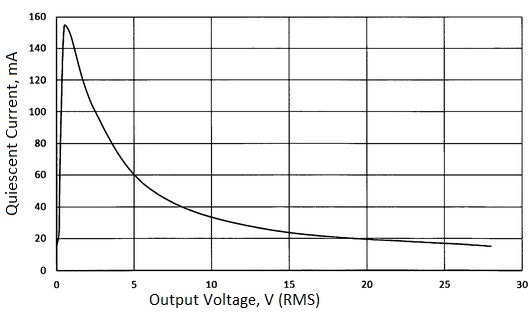

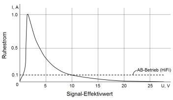

Sorry, the numbers are for my 200W amps. You're right, the quiescent current curve can be quite different.
The measurement diagrams are in the appendix.
The only way this circuit can work is the trick with C1 and R3: for dc there is a base resistance of (≥) 10MΩ, and the darlington T1-T2 is pretty much off. With an ac signal more current flows: due to the µ1 capacitance there is only 155kΩ (( R1 + 1/2P1 // R2 + 1/2P1) + R4 ), and the darlington is 'modulated'. If the quiescent current is set high (from the current source "I" through the 'bias resistor' to the control vas) with no signal, then with a signal more current runs through this darlington and the quiescent current (due to the reduced bias) will decrease. And indeed with more / larger signal, more 'bias reduction'.
All settings and values of the components are variable, so lots of calculations to find the right values for a particular design.

Here you should actually pay attention to the temperature of the heat sink. If this becomes too high (>60°C), the circuit can no longer set the quiescent current to a minimum during the pauses. Alternatively, you can try using a Temistor instead of R6. This should be mounted on the heatsink of the output transistors.
