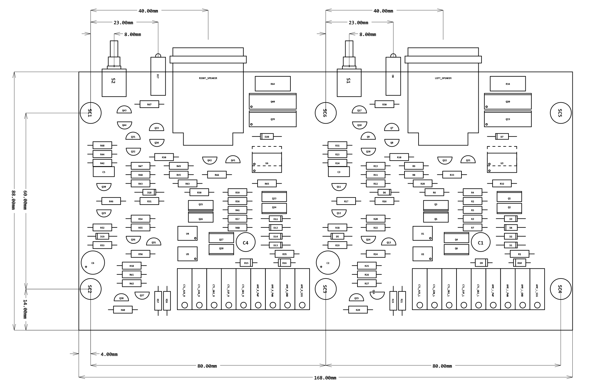

Here is my solution for the protection. Contains on delay, DC, and thermal protection, and fan speed controll, using 2xLM339, and some small signal transistors.

Schematic.
I have the PCB in Eagle, or gerbers.

what about short circuit ?
have this too?

The short circuit protection is V/I limiter built within the amplifier.

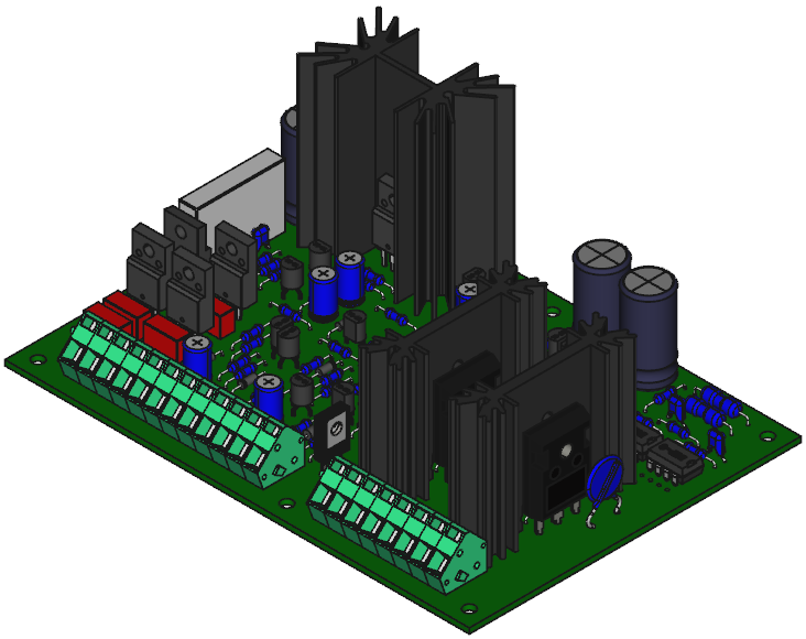

I used the freed up board space for some heat sinks. The SSR might get a little warm under extreme conditions plus the heat sinks provide some mechanical support to the expensive MOSFETs.
This is how the board may look like:
I tried to make the series regulator more robust by adding some current limiter but was not satisfied with the result.
So I decided to use an integrated solution instead - the TL783. This has full protection built in and saves a lot of board space. If I had found this part earlier I could have saved a lot of time.
The remaining circuit stayed more or less the same.

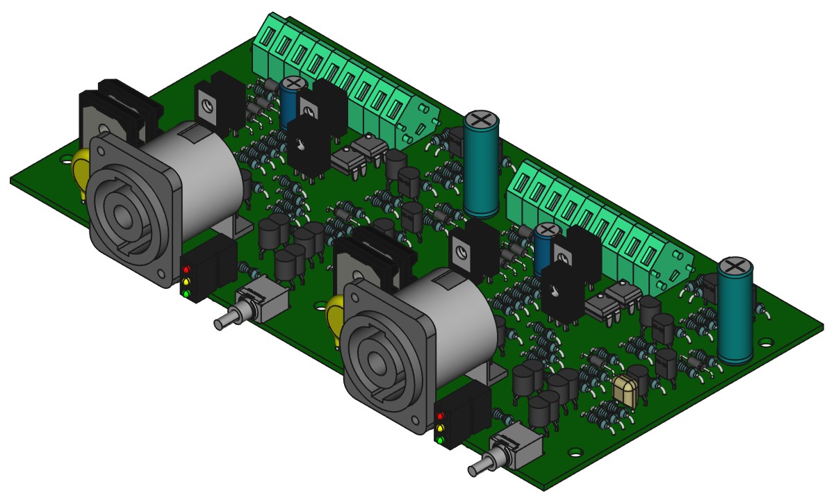

I like to reduce the cable mess inside amplifiers and I don't really like binding posts for the speaker connection so I put Speakon connectors on the board.
The schematic became even more complex of course. I don't really mind complexity as long as it has some benefit.

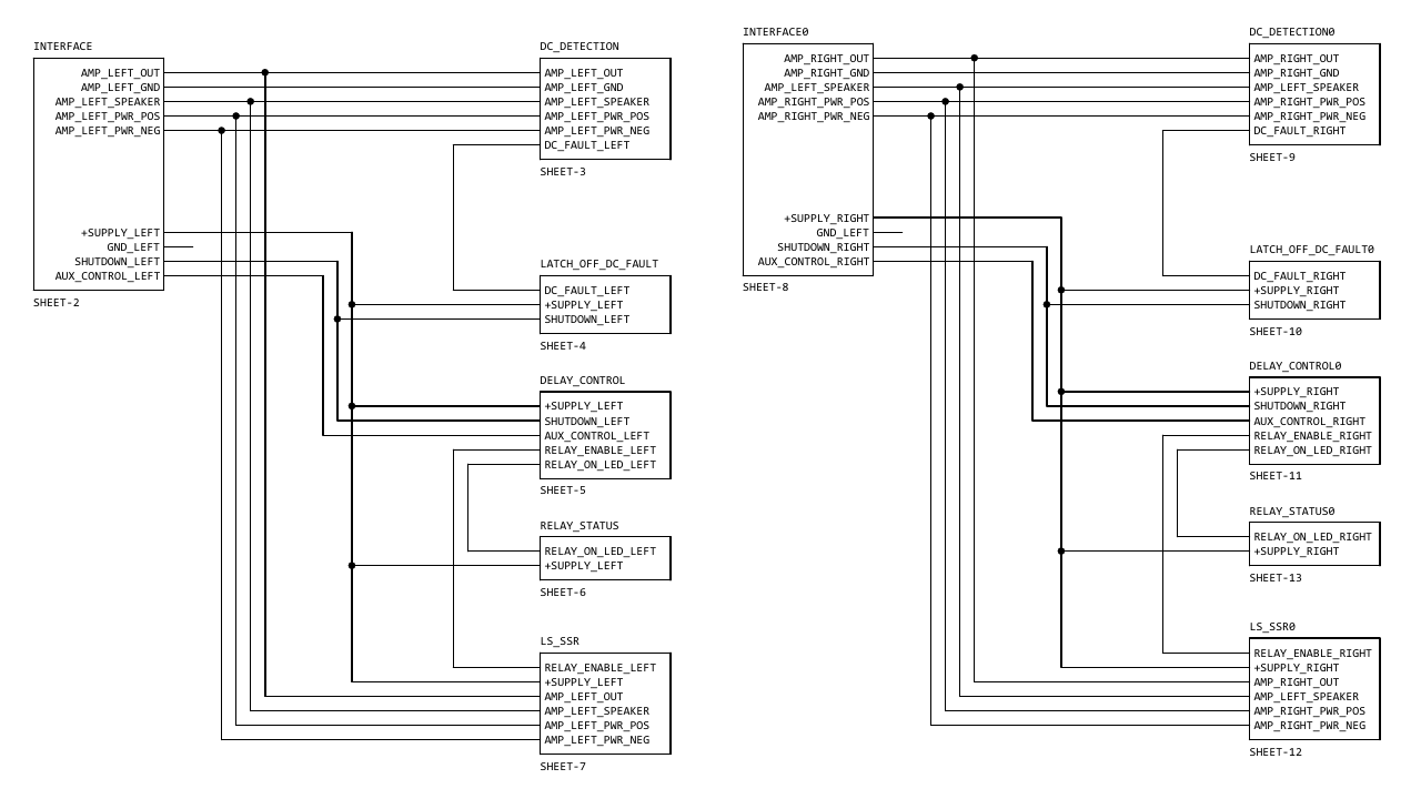

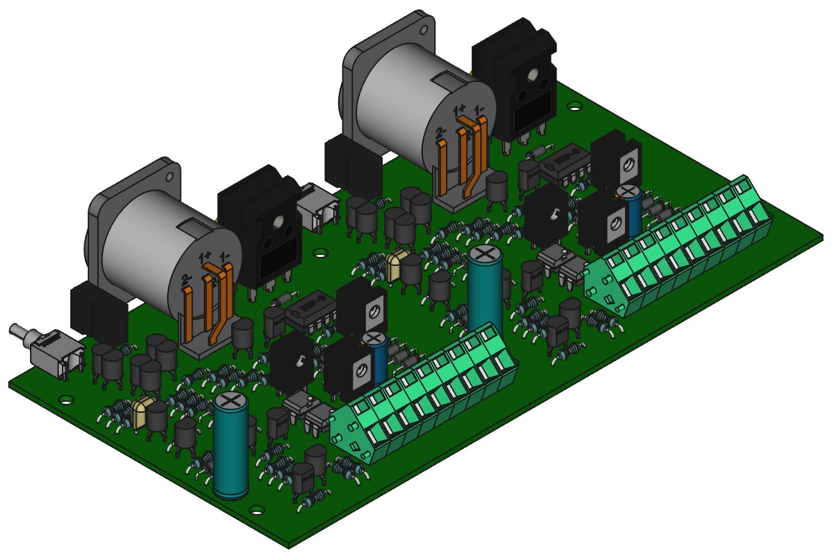

I don't provide Gerbers for any of my projects, but you may have PCBs if you like. But first, let me test whether it works.
Please find attached some screenshots how the assembly and schematic blocks look like now.

modular_amplifier_speaker_protection_V01_assembly_thumb.png138 KB · Views: 523
modular_amplifier_speaker_protection_V01_assembly_3d_01.jpg140.2 KB · Views: 526
modular_amplifier_speaker_protection_V01_assembly_3d_02.jpg129.8 KB · Views: 517

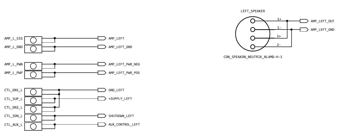

I will explain the schematic page by page.
This page is just the interface.
The module only needs a power supply for the control circuitry plus the amplifier output and ground connected in order to work.
Amplifier power supply rails are optional. Note that the control power supply is galvanically isolated from the amplifier.
Pulling "shutdown" to ground disconnects the speaker.
"Aux_control" is an open collector output that can be used to switch something together with the speaker. Ground reference is the control supply.

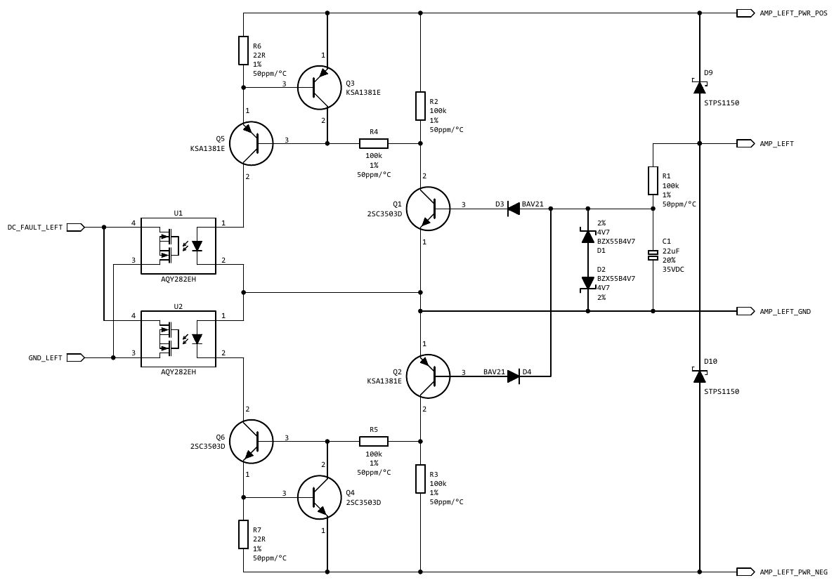

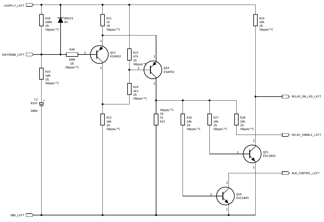

Page 3 - DC detection
This is where the circuitry becomes interesting:
The amplifier signal output is low pass filtered by R1 and C1, voltage limited by D1 and D2 and then activates the switches Q1 for positive DC and Q2 for negative DC.
Q1 and Q2 control the current sources that feed the opto-relays.
DC detection threshold is roughly 2V.
There are more sophisticated approaches available with lower detection threshold and faster response time. This one should be good enough to protect a full-range speaker that has a passive crossover inside.
The supplies for the opto-relays are generated from the amplifier output. This is what D9 and D10 are for.
Amplifier supplies can be connected optionally. In that case, D9 and D10 must not be installed.
D3 and D4 are not really required if D1 and D2 have lower breakdown voltage. The point is that Q1 and Q2 need to be protected from high reverse voltage at the base.

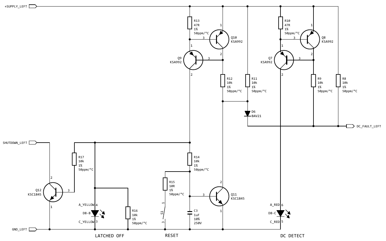

Page 4 - latch off on DC event
Once one of the opto-relays are engaged, two current sources are powered by pulling the node "DC_FAULT" to ground. One CCS lights up the indicator LED. The other one charges C3 and latches itself on via Q11. Another LED indicator shows that the latch activated. S1 resets the latch. Also, the shutdown is initiated, which turns off the speaker solid state relays.
Note that I use those switched CCS everywhere instead of a single transistor. This makes the circuitry supply voltage independent. Complexity is increased dramatically, but those parts are super low cost so I don't mind.
Page 5 - delay control
Basically this is just a Schmidt trigger.
After some time, the loudspeaker SSR is engaged and shut off instantly once "shutdown" is pulled to ground.
Shutdown is controlled by the latch, which is triggered in case of DC at the amp output and can be controlled by the power supply in case of mains voltage loss.

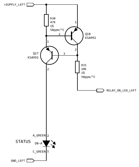

Page 6 - Relay status indicator
This is really nothing special. I dropped the astable multivibrator circuit although I like it and it provides better status messages. The reason was that I ran out of PCB real estate (wonder why) and it only works well at low supply voltage. In case the module is powered with like 100VDC, I found it difficult to deal with high reverse voltage at the transistors bases.

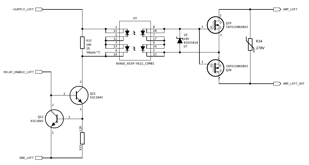

Page 7 - loudspeaker solid state relay
This is probably the single most expensive page - expensive photovoltaic gate drivers, expensive MOSFETs. Dependent on use case, cheaper MOSFETs are an option.
I guess there is not much to explain here.

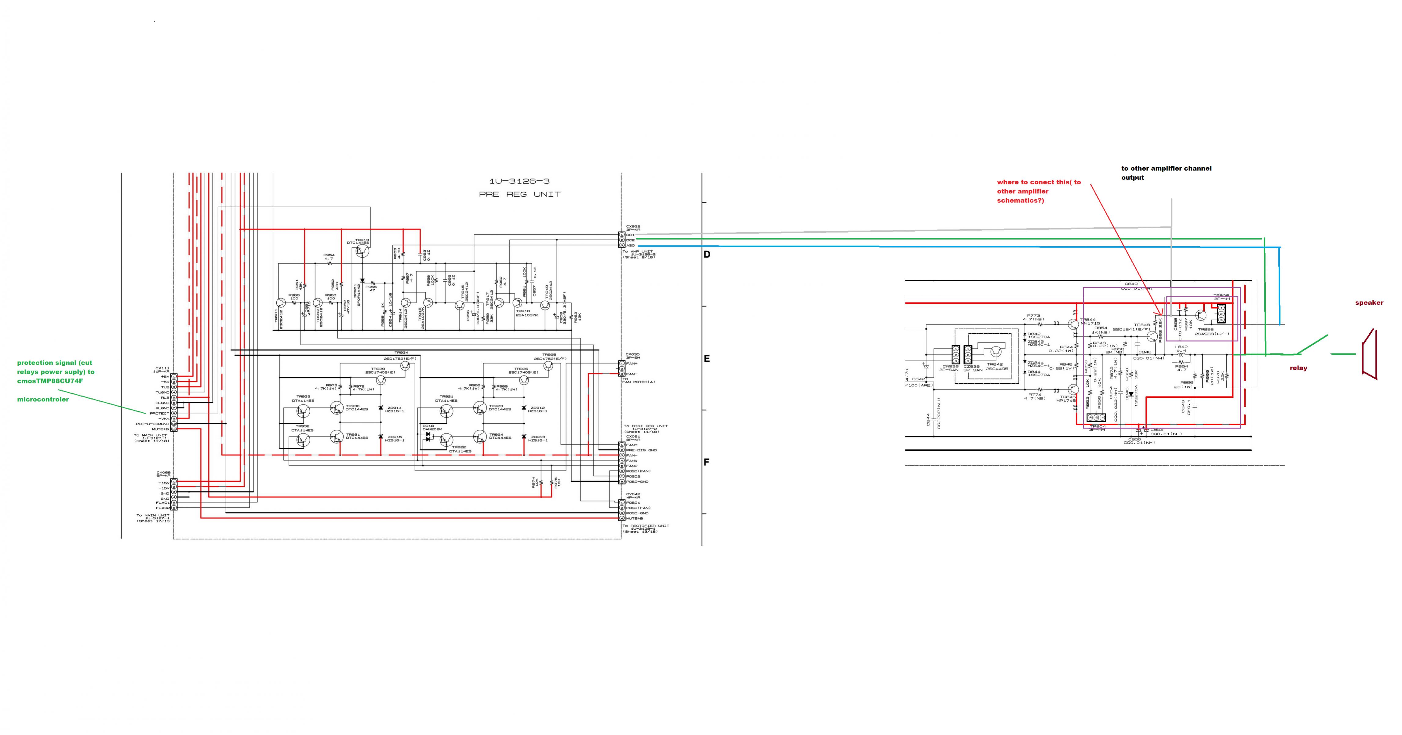

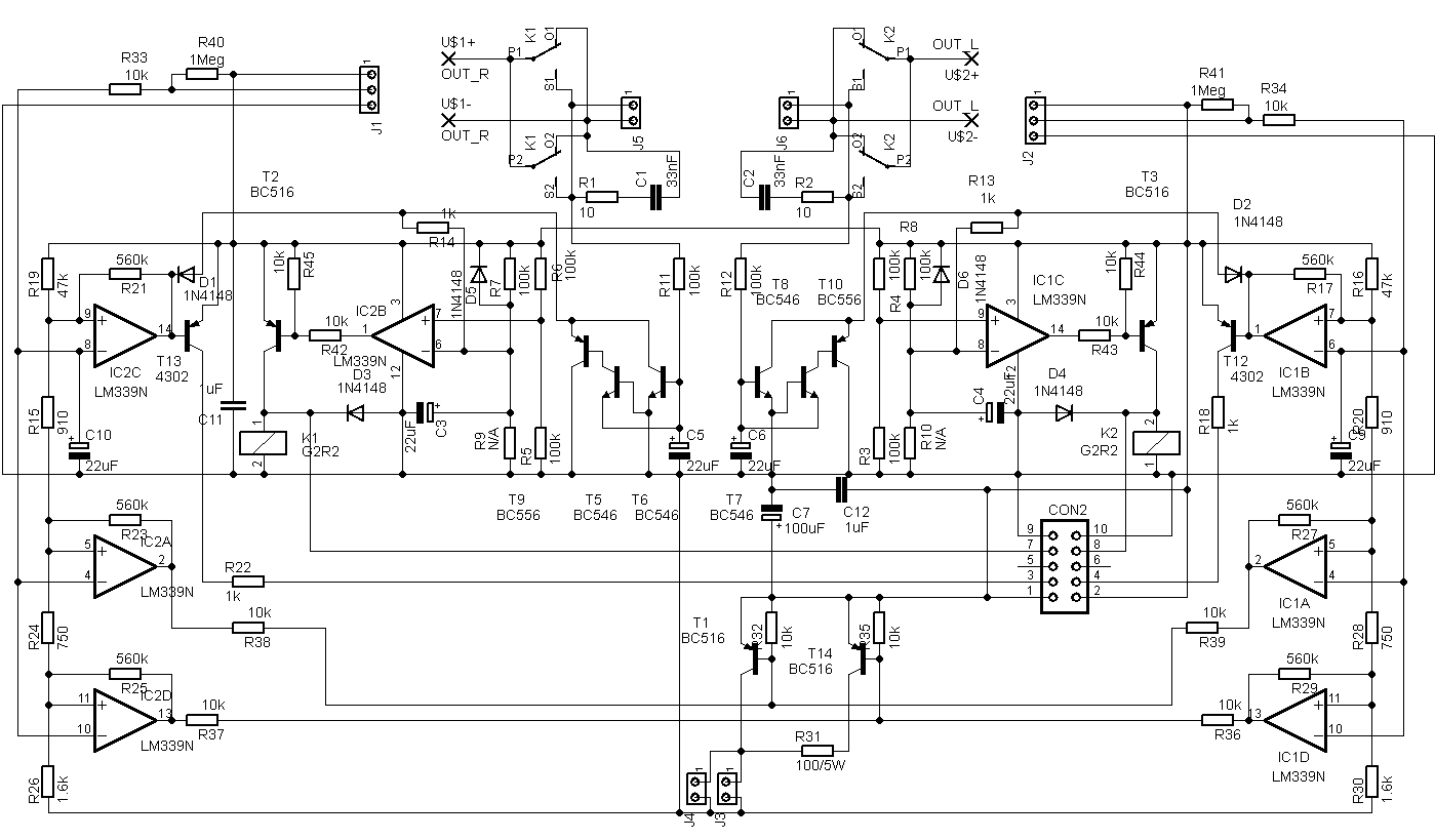

i have a question- I never had any seriuos issues with any of my amps without any protection for 20years. pass labs is very reliable amps. now my other amplifiers shematic is diferent, only two trasitors runing at 66v and doing it in class a. if speakers are not connected it starts oscilate and blow speakers. I have implemented DPTH relays (when system starting it takes 5-7 seconds ,so output from amp is not delivered to speakers dummy load of 5.6ohms 50w on amp, when relay activated 5.6ohm load disconected)
my problem is that I need protection from DC when something goes wrong, I don’t mind amp blow ,its eas to repair, but I really concerned about expensive speaker drivers. and I have clever protection its microcontroler operated combined protection with fan coolings temperature tresholds,etc in event of any failure microcontroler sends signal and relays are cut. the problem is HOW to connect this protection to other amplifer(with diferent schematics- https://www.diyaudio.com/forums/dig...put-1704-dac-paraleling-dacs.html#post6522779)
I missing only one point for conection marked with arrow . unless protection parts are integated deeper in the amp(larger square) I need protection and amp guys chime in , because I do not understand this amp (darlington transistors) and protection. thanks a million
