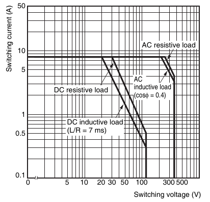

The reason is the relays.
Those relays are rated for 30VDC maximum.
Look at this graph taken from the famous Omron G2R:
attachment.php
The contact can switch 1A at 30VDC for inductive loads.
Other relays behave roughly the same.
Maybe some can do 2A. But that's about it.
My amp runs from +/- 90VDC and the transformers (two of them) can deliver 10A continuously.
See what I mean?

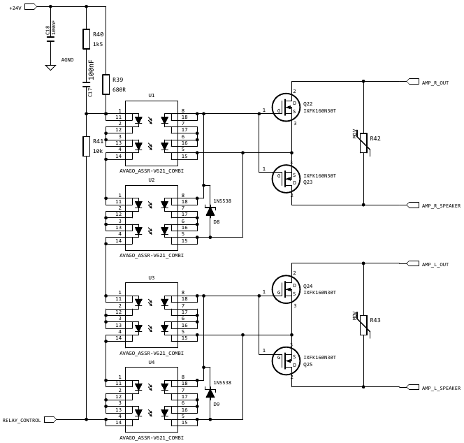

So the solution is to use solid state relays.
They are very reliable, switch small signals as well as large ones and, dependent on MOSFET selection, can switch really big loads.
I have up to 200V from the amp plus 100V safety margin and need to be able to interrupt over 10A DC.
This is why I chose the IXFK160N30T. They should do. Hopefully. The MOV shall protect them from voice coil voltage kick back at 250V in case.
Two in series give 40mOhm.
I'd prefer a lower Ron but need to make compromises with DS voltage rating and current.
Each two in parallel would make a huge hole in my wallet.
U2 and U4 are optional and can be bridged if not needed.
I can't find a good Zener diode for protecting the gates that has extra low leakage not more than 10nA at 16V with a Zener Voltage of less than 20V. Any ideas?
Here is the circuit I plan to use for SSR:
attachment.php
attachment.php
I just noticed I got the wrong diagram.
Please excuse.
This is the correct one:
attachment.php
At 30VDC it can do almost 4A.
At 90VDC it can switch only 0,4A.
Please excuse.
attachment.php

The relays are not fine BTW.
A reasonable amp has maybe 40V to 50V supplies.
At 40V the relay can switch 2A, at 50V 1,5A.
Simply not enough.
