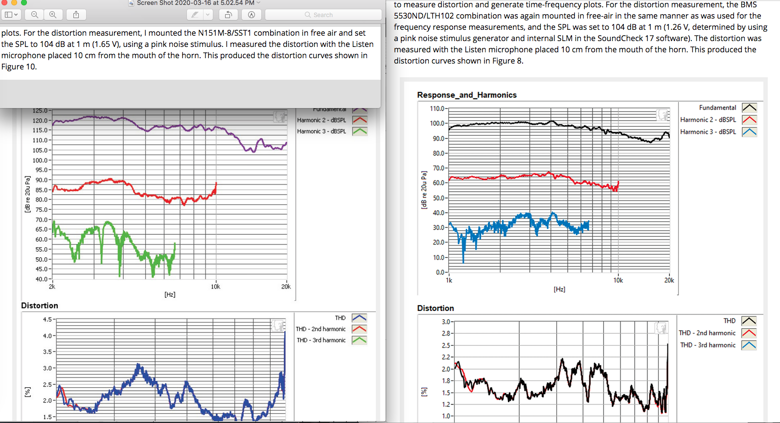

the N151M also has a voice coil review:
Test Bench: Eminence N151M-8 1” Compression Driver | audioXpress
and if I'm reading the graphs correctly has dramaticly lower harmonic distortion than the 5530nd:
Test Bench: The BMS 1” 5530ND High-Efficiency Compression Driver | audioXpress
They are both around 2% THD but the N151M is playing at 120dB whereas the BMS is at 100dB. Its a shame that the distortion graph is not from 1kHz for the N151M otherwise we would have data on whether it can play loud and low. From my experiance pelanj's method of increasing the level gradually checking THD works well and allowed me to get a 1.27 kHz, 4th order crossover on a 1.75" diaphragm comp. One thing to be careful of though is REW starts the sweep at 1/2 of the minimum selected frequency so you may want to use steady state tones and fft analysis for the lowest frequencies at the highest powers if pushing it.

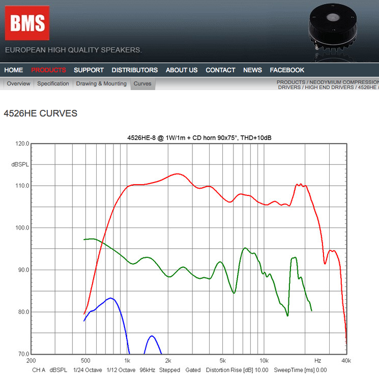

Here's the Eminence N151M on the QSC waveguide
Here's a BMS 4526HE on one of my DIY waveguides.
The 4526HE is *really* nice, but the N151M goes lower, no doubt. (Of course, it *should*, it's much bigger.)
The cool thing about the Eminence is that phase plug; it takes a large diaphragm and manages to get it to behave a lot like the much smaller 4526HE.
(Note that the BMS was measured at a louder level.)

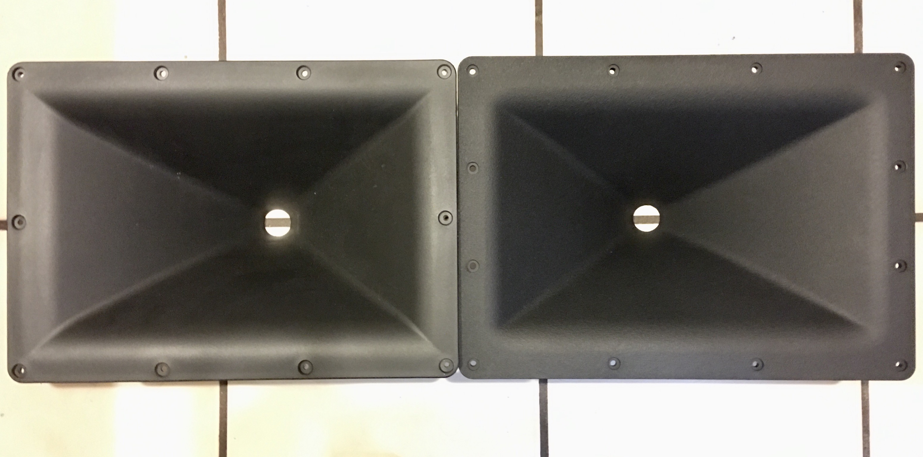

B-52 PHRN-1014 1" Horn 10" x 14" Bolt-On
Thirteen bucks!
If I'm not mistaken, this is basically a clone of the QSC waveguide.
The SEOS would probably work really well too, they're very similar.
Thirteen bucks!
Unfortunately, this is another case of "if it looks too good to be true, it ain't".the N151M also has a voice coil review:
The N151M is looking absolutely amazing, its definitely going in my next sound system. The ability to do low distortion 120dB/1m seems pretty unique for a 1" throat driver, never mind one with such high fidelity characteristics.
The Audio Tech Bench review has a clerical error in the display of the graphs:
"For the distortion measurement, I mounted the N151M-8/SST1 combination in free air and set the SPL to 104 dB at 1 m (1.65 V), using a pink noise stimulus. I measured the distortion with the Listen microphone placed 10 cm from the mouth of the horn. This produced the distortion curves shown in Figure 10."
So, 104 dB at 100 cm (1m) at less than one watt (1.65v into 8 ohms=.34watt)
Apply the inverse distance rule, -6dB for halving distance:
110 dB at 50 cm
116 dB at 25 cm
122 dB at 12.5 cm (close enough to 10 cm)
and we have a curve with 120+ fundamental, and low THD.
On the BMS driver, the same procedure was followed, but the graph was evidently was normalized for the inverse distance, showing slightly less THD, but also properly (more or less..) indicating the SPL at 1 meter.
It takes a lot of these small annular diaphragm drivers to equal the Sd (surface area) of a standard inverted dome compression driver of a similar voice coil size. The relationship between volume and pressure in air (gas) creates non-linear output as volume is increased, at high volume, increased Sd is still the primary determining factor for reducing THD.

I was genuinely surprised by how low the N151M could go. Because as you noted, ring radiators are *definitely* displacement limited.
For instance, the BMS 4526HE is *astonishingly* loud, possibly the most sensitive speaker I've ever tested. But it just doesn't play very low.
Depends what you mean by "low", it's basically flat to 1000 Hz with low distortion, 110dB one watt 1meter on the 90 x75 horn BMS used.For instance, the BMS 4526HE is *astonishingly* loud, possibly the most sensitive speaker I've ever tested. But it just doesn't play very low.
From everything I'm seeing, the BMS 4526HE plays lower than the Eminence N151M, which appears to be designed more for 1.8kHz up, with Fs at 1.24kHz.
Many thanks for sanity checking the distortion numbers. How will having an Fs of 1.24 kHz affect a 1 kHz crossover point?
The QSC on the left, B-52 on the right. Width and depth dead-on similar, height slightly larger on the QSC.
It looks to me like the height difference is just the width of the mounting lip?
