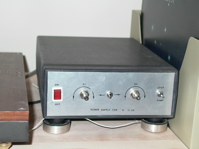

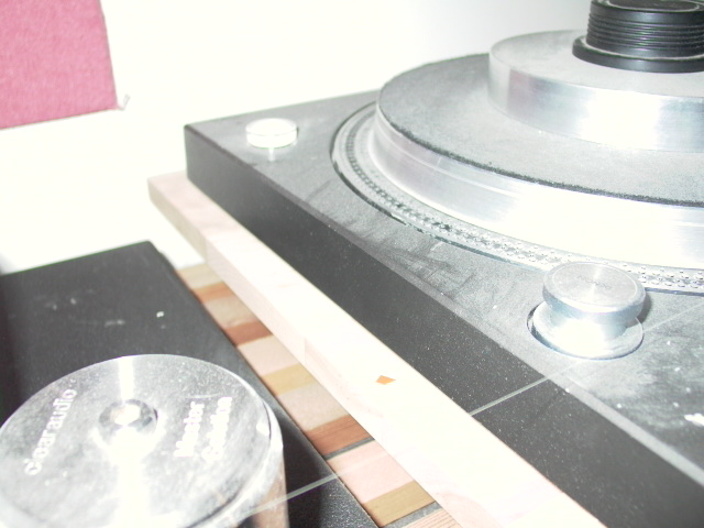

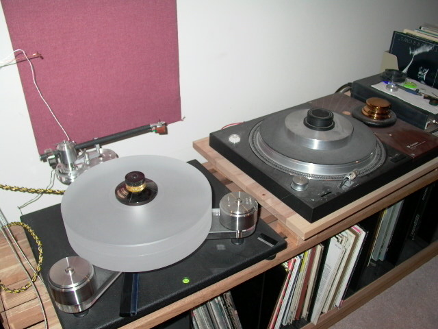

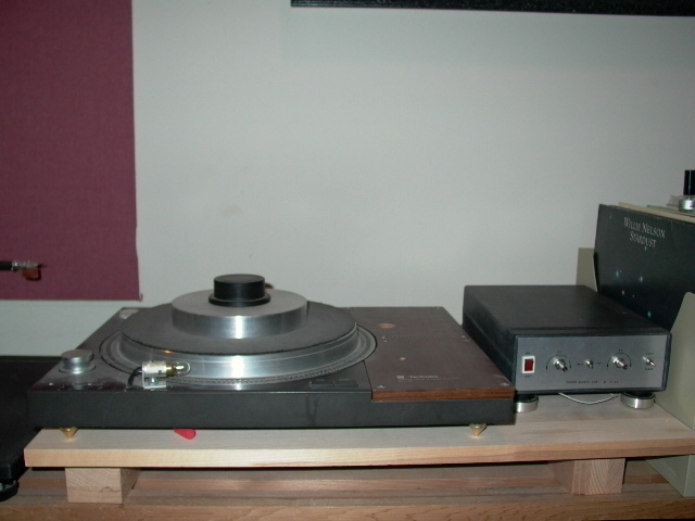

Hi Guys
I did to my SL110( 5 years ago) in a different way of all yours, I took the whole power unit out into a separate box with a extend cable, replaced those speed control with a 10 turns precision potentiometer, SL110 is the firest modle of the direct drive TT in Technic, I got it in 1972, it already 38 years old before the modification, it had a problem of speed stable, but working good now, I only use it as a belt drive TT's motor, it has the bigger torque than the later's modles , I use a very thin elastic thread as the belt to drive a more heavy platter, only thing has to do is use hand to turn both platter to run before power switch on, weight balance is a issue, and will make the sound change but this set-up come up supper, no other driving motor can be better than a direct drive TT ( better bearing, slow speed quite and smooth) the only thing concern is the torque , because the ratio is 1 to 1
Cheers Tony Ma
