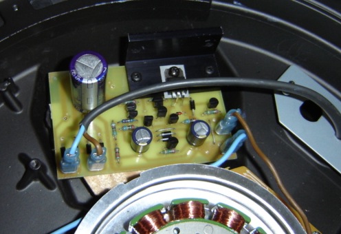

I got a 1210 with a custom made external transformer and simple LM317.
The original PSU and traffo were still in there so I tried old vs new and the mods made a nice difference.
Another big improvement came when I took out the old traffo - it's near the line the cart follows and seems to affect it negatively. Others have also noted this.

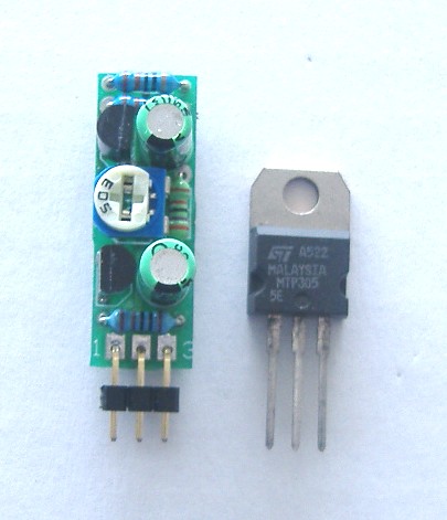

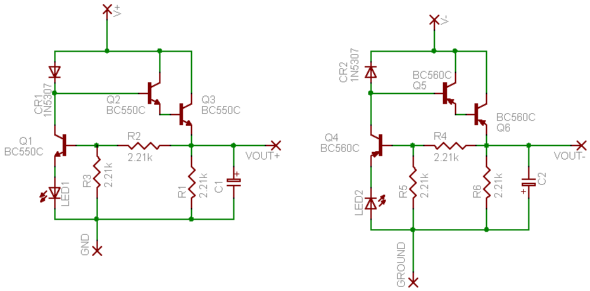

I'm investigating in building an external PSU for SL 1210 MK2 and SP 10 MK2 players. For that I need a regulated voltage at about 21V DC. The internal regulators of the Technics deck will be bypassed. For a SP 10 MK2 there are 3 voltages (DC). 5V, 32,5V and 140V. Except 140V is easy to generate.
I am using a well known LM317 regulator for doing that. I already did a PCB design.
Bild: sl1210psuavsu.png - abload.de
Bild: 1210d747.jpeg - abload.de
Now I have a prototype running. There is sound improvement. Soundstage is more stable, bass is more detailed. So it is woth it to build an external PSU.
Does anybody has an idea how to generate 140V DC? I don't have a glue. Any comments about my PCB Design? Is anybody interested in PCBs from me?
