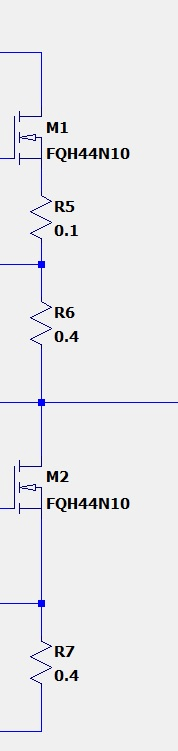

The picodumb mod for the source resistors looks like this:
It is only applied to the upper Mosfet M1. I ended up with a smaller value at R5, and suggest you use high precision thick film resistors. It may be applied by carefully lifting the Source leg of M1 and inserting the resistance between the lifted leg and the PCB mounting hole. Make sure you have some spare output Mosfets on hand before trying this one.
This mod seems to change the relationship between H2 and H3. The stock F6 may sound a little analytical to some. Changing the source resistance in this way introduces a small amount of asymmetrical distortion to the output.
In the original F6 R1 is 0.56 ohms and R2 is 0.47 ohms,there is not 2 resistors as r5 and r6 in the above schematic.I built an F6 and mine had the original R1 and R2.I moved both capacitor negatives.In the original if you move only the R1 negative you wind up with 10x the distortion,about 0.5% at 1W vs 0.05%.In the above you wind up with about 3x the distortion (.15% at 1W)

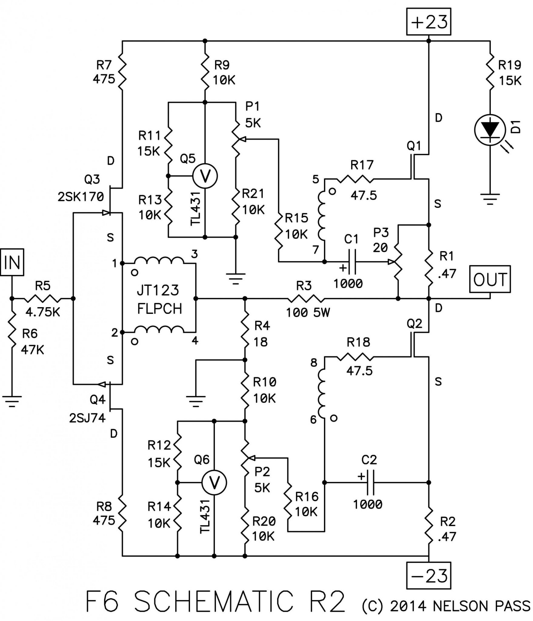

Reactions: geoturbo
An improvement would be an update to revision 2, especially the addition of P3 which allows to adjust the harmonic spectrum (soundcard and software like Arta or REW is sufficient). Ideally the PCBs from the store should implement the R2 changes.
Have a look here as well: https://www.diyaudio.com/forums/pass-labs/258613-diyaudio-firstwatt-f6-post6039613.html
Thanks for posting this R2 schematic Georg, it's good to go back to papa's original post too.
I was thinking something similar to adding R7 and R8 in my post #26 above, plus a 200uF (?) decoupling capacitor if it makes sense from drain of the Jfets to ground?
It might be worth adding provision for 2 input jfet's source <-> transformer pins1/2 resistors and also provision for positive feedback too to expand the possible variations ...
Plus, the ground connection of the possible 220uF capacitors should be grounded to the pcb central 0v power point, not the signal ground, if possible.
Would that also work with the IRFP240? The FQH44N10 are unobtainium.
Certainly, splitting the source resistance between the connection to the 1000 uF capacitor works as well with IRF Mosfets.
I am investigating the use of IXTQ75N10P Mosfets in place of the FQH44N10. The newer Mosfets have a high transconductance figure, plus reasonable Gate capacitance and Gate charge figures. And they require a higher threshold voltage to achieve the bias currents we typically want in an F6. I'm still working on that.
