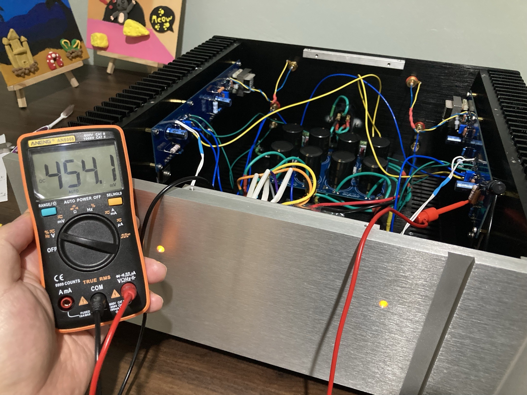

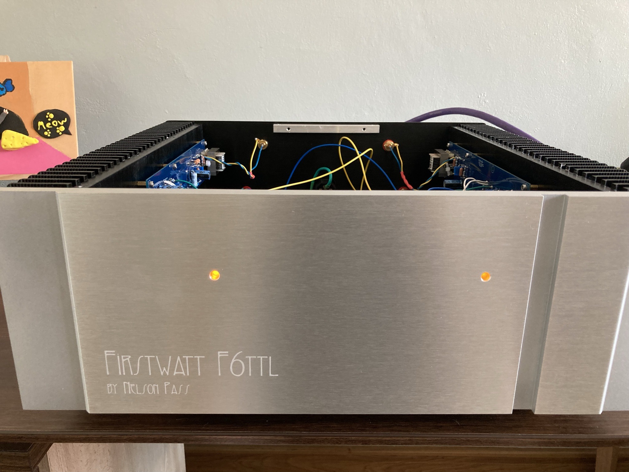

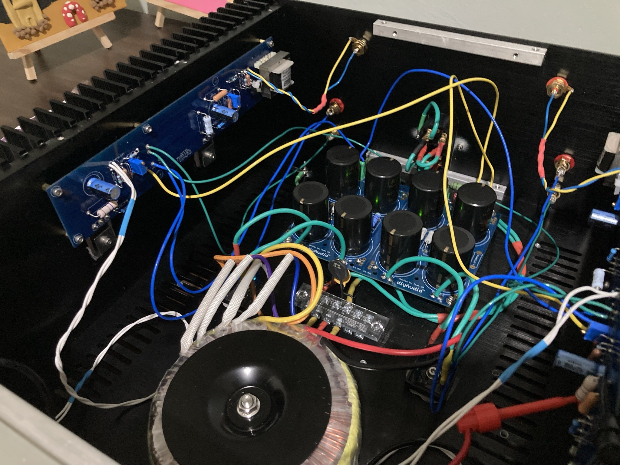

I did not see your speakers mentioned. What speakers?I’ve built a F6 last year from diyaudio boards, transistors and input transformers. I find the sound warm and topend slightly rolled off. The bias is 520-30mV. I have a Schiit Aegir and this is the observation when I compare both.
my queastion is how can I take the F6 further up a notch? Keeping the same tonal balance in midrange but open up the highs a bit and a slightly tighter bottom end?
Will replacing the 1000uF caps to Mundorfs help? How about building dual mono power supplies feeding dedicated amp channel?
thanks
To add, what's the source? My F6 was drastically different stepping up from a Schiit BiFrost to the Benchmark DAC3.I did not see your speakers mentioned. What speakers?
