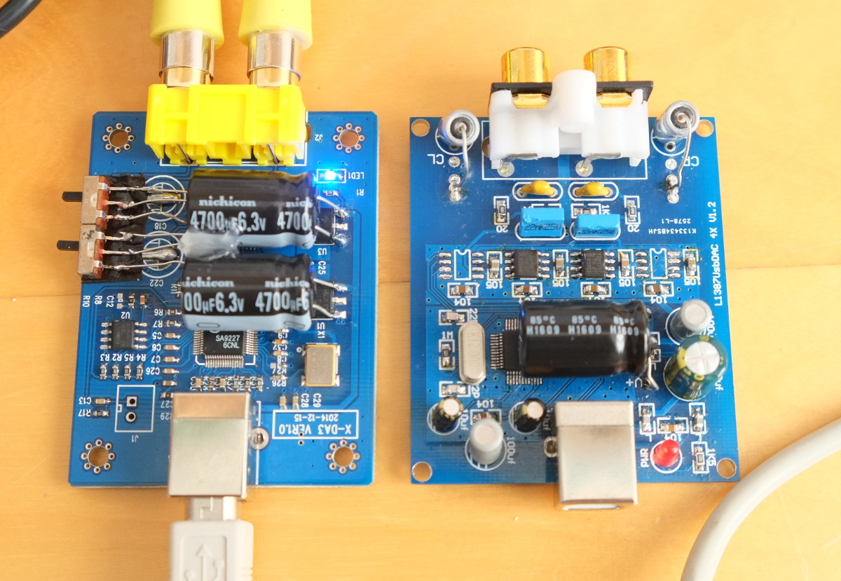

Here are two, the X-DA3 and L1387.

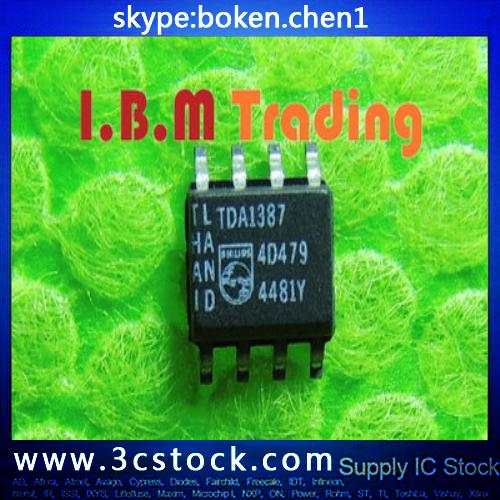

First it’s worth noting that finding genuine TDA1387 chips is a nightmare. If they say “Thailand” in bright white text they are fake. The ones I have look real but I'm suspicious because TDA1387 requires a current/voltage converter at the output. This can be accomplished without an op-amp using a small resistor network but results in a much lower output level, hence stacking the chips becomes necessary, however, in my case one chip per channel gives at least the same level output as the TDA5102A! Two TDA1387 chips on this board was way too loud for line-level so I suspect even these are fake.
X-DA3 - TDA5102A / SA9227
I removed the pointless output capacitors and 10K resistors to match the manufacturers recommended design. I added capacitance on the Vin side and two switches to play with the filter and pin 10 setting.
The SA9227 supports resolutions up to 32bit/384KHz. Completely pointless but oh so modern. More interesting the TDA5102A has two filters which can be switched. In my testing I could hear no difference. However the setting on pin 10 makes a significant difference to mid/top end, at least in 44100 and 48000Hz mode. I’m not sold on it, it sounds like an anti-aliasing filter is switched out and is perhaps tiresome with some music.
The TDA5102A trounces on the TDA1387 for dynamics and sound-stage. It's almost like there's a stereo separation enhancement at work. This is the noticeable benefit.
L1387 - TDA1387
Assuming the chips are genuine I can speak for the sound, which is warm with quite a mellow top-end. I feel it has a more taught and accurate bass response, which apparently is a characteristic of a NOS dac. For me it isn’t quite lively enough with a lack of energy. This would suit some music fine.
Overall
Both boards have as good as zero noise and if I’m honest the extra capacitors made no difference.
I’m not satisfied with either. I have a replacement SA9023 coming and from what I recall it beats both these DAC’s. I’ll report back!

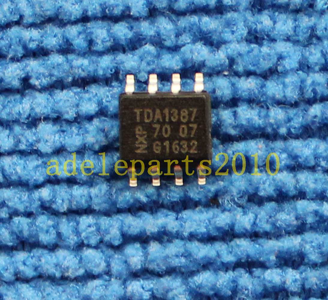

Where did you pick up the story that TDA1387s with 'Thailand' written on them are fakes? Most of mine have this marking and they so far have performed very well (subjectively) and there's been no noticeable deviation in how they behaved compared to the datasheet.

There are two fake "versions" from Thailand, some have the writing broken up around the philips logo (blatant fake). There is a post on the web somewhere describing the difference which is easily identifiable because the I/V resistor converter significantly limits output and the original chip can't output enough current with one chip. This is why 2-4 are required to get line-level. It is why I believe my NXP ones are also fake. I originally had two of these NXP chips per channel and is was massively over-powered for line-level.
TDA1387 have been out of production for a long time now, the writing will have decayed while the new ones is bright white from recent lasering. The fakes will work as a basic resistor ladder DAC but I doubt they have the auto-calibration stuff.
Bass is solid on the L1387, better than the TDA5102A - perhaps the 470uF cap is colouring the signal which works better for your amp/speakers. For me the let down is mid and upper range. Of course I have to consider if my chips are fake then there's no point comparing.

Genuine one from a Creative AWE64. I was hoping to get two old boards but prices are crazy.
Mine look like the 'fake' ones you've shown, however they perform according to the DS in terms of output current. I have no idea why you think the original chip by itself can't output enough current.

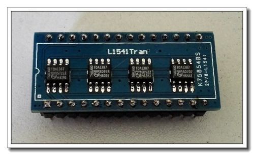

There's a very nice post on the web somewhere explaining it, using the original data-sheet. It's why the board takes 4 chips. I run 2 chips and it's louder than the TDA5102A (when it should be half the volume). 4 chips made the volume uncontrollable.

Note that pin 10 on the PCM5102a is the deemphasis enable pin, which only works at 44.1 and 48k, which would explain the sound difference. Pin 11 is the digital filter settings.
Hi Paul, Can you explain what this feature is? It makes a big difference to mid/treble. The digital filter select has no noticeable impact.
