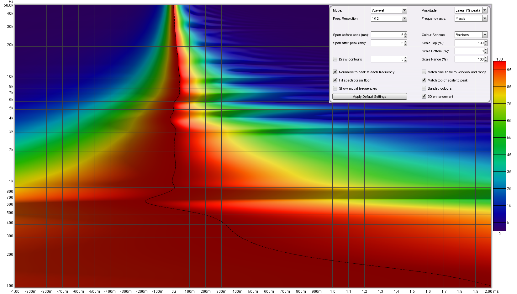

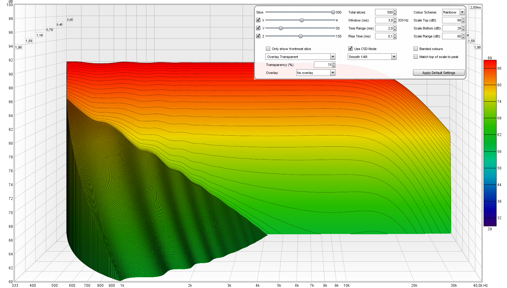

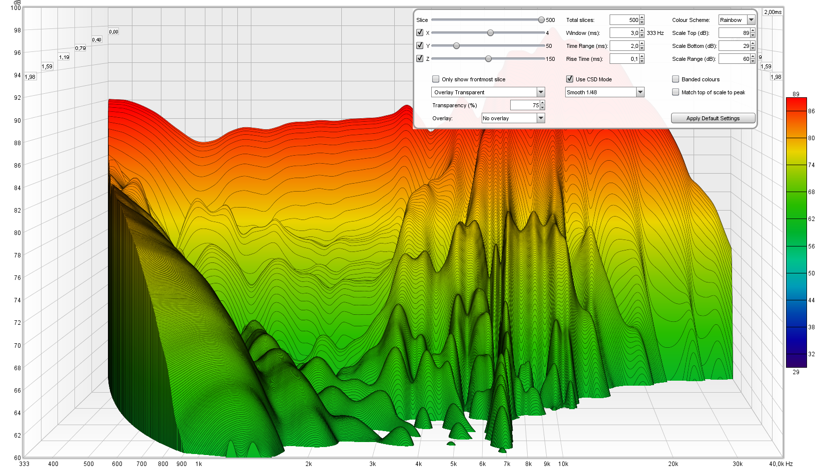

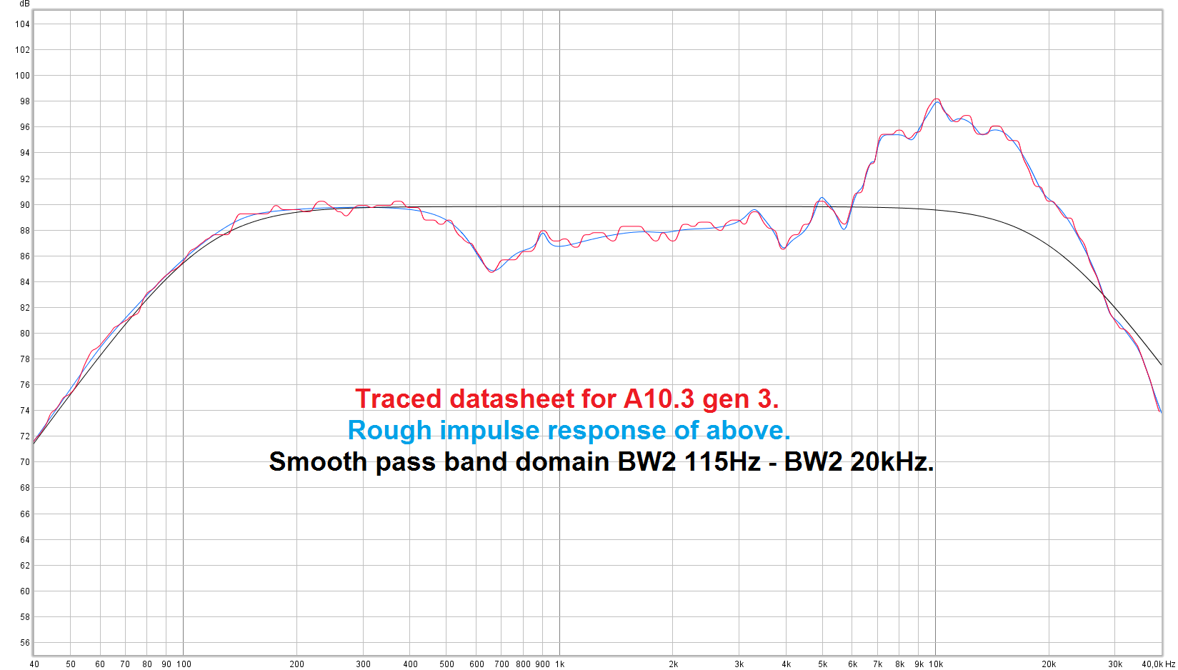

Fine enough TC9 is not your cup of tea but please stop subjective non documented conclusions for it, or start share and document data for your own favorites.
If we run them A10.3 out of box they have all technical reasons against them to make any conclusions on low level detail, but guess if MrBoat in the end happen prefer his TC9 you just tell they aren't broken in yet or system is not good enough even most system devices should be more than able to cover pass band that full range driver are capable of.
Its a mystery why continue talk low level details 40-50dB down when most music material is in 7-12dB dynamic range area and few into 20dB area. Below is how minimum devices behaves when responses are non smooth verse smooth and that is a story about start attack and decay at the right time at the right level all over the frq spectra and if non smooth somewhere especially with high Q deviations its distortion and output is not true to input and attack and decays will be manipulated in time domain so harmonics will not follow the true note started by instruments, this manipulation is obvious looking black line showing peak energy time in wavelet plot for A10.3 how its out of box response is far from smooth and optimal, of course this Alpair driver can be response corrected but guess most don't have gear to smooth its metal cone top end and the huge dip around 680Hz is as far i know non-repairable because its origin is same distance diffraction when using under hung surround.
Think to love out of box sound from this driver is no problem but to use it as a reference system or comparison of low level details then it will need heavy correction somewhere in system.
