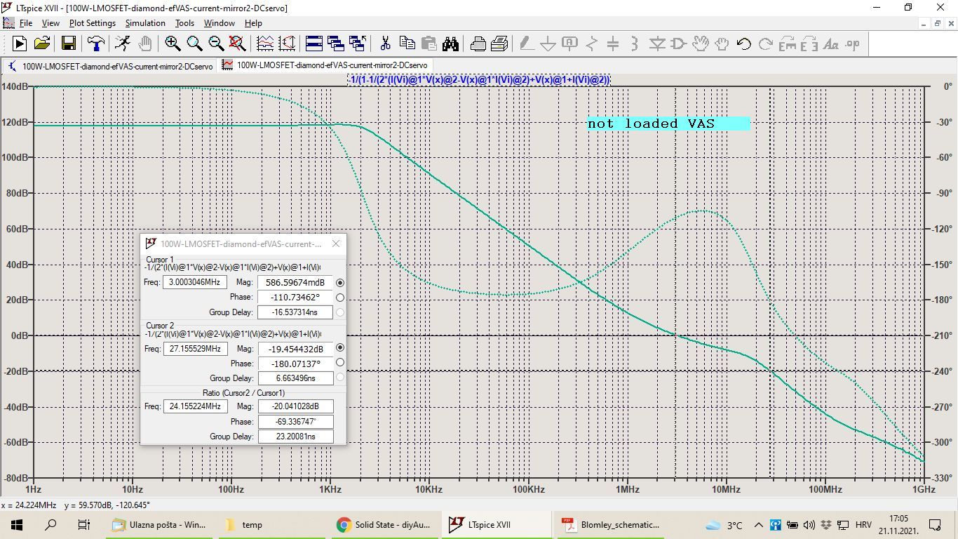

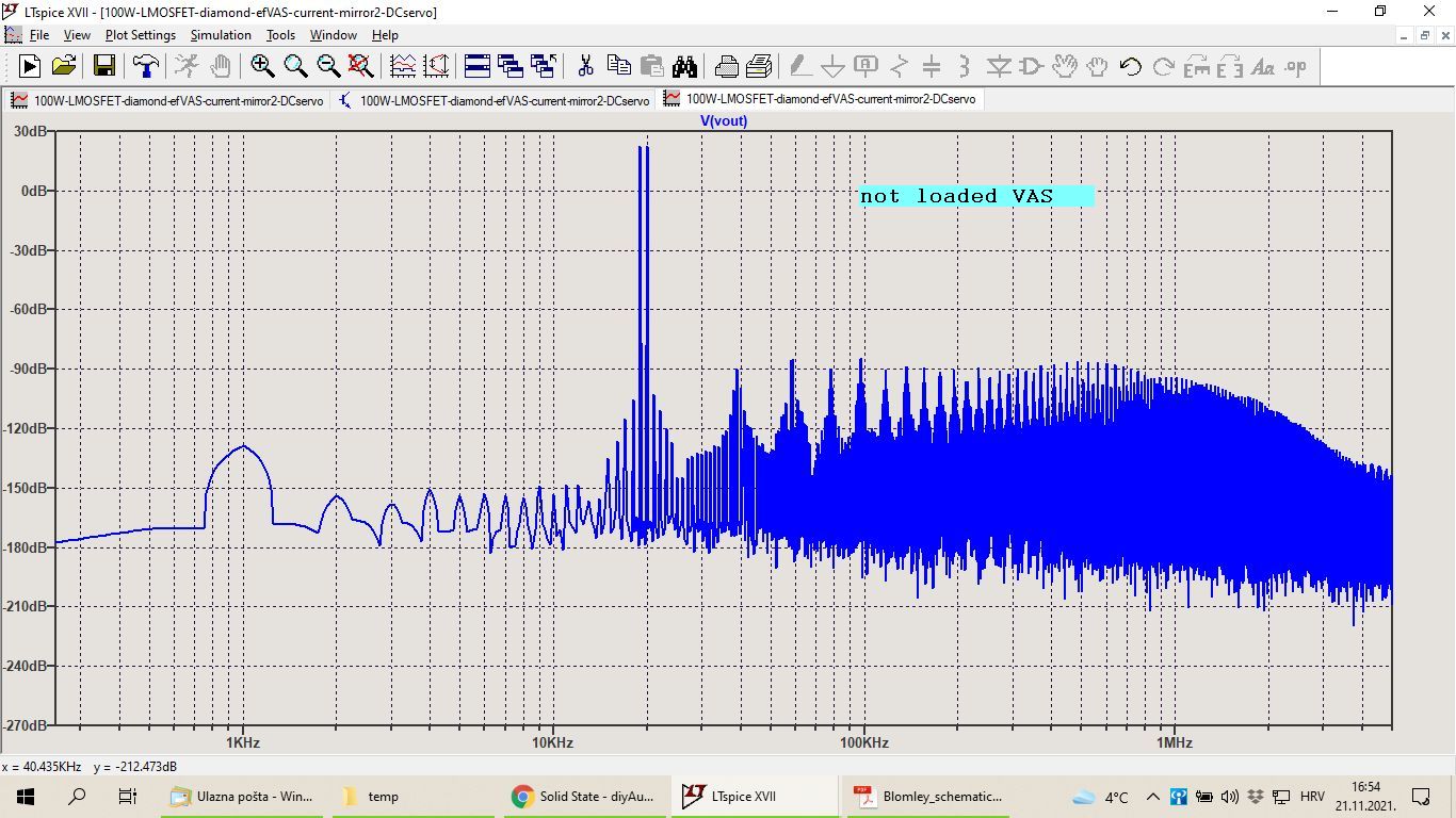

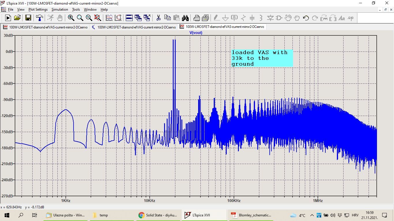

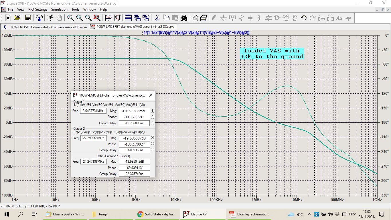

To conclude this tread I would like to show some more simulation on the same amp. It uses active loaded IPS but simulated in two situations, first one with VAS not loaded (keep the LG high at 120 dB up to 1 kHz) and VAS loaded with 33k to the ground (keep LG lower at 80 dB almost up to 20 kHz). Attached are LG plots and corresponding IMD simulation with two frequencies, 19 kHz and 20kHz of equal amplitude.
From this, I hope, it's clear that is better to have as high LG as you can get even if is not extended to the whole audio band.
