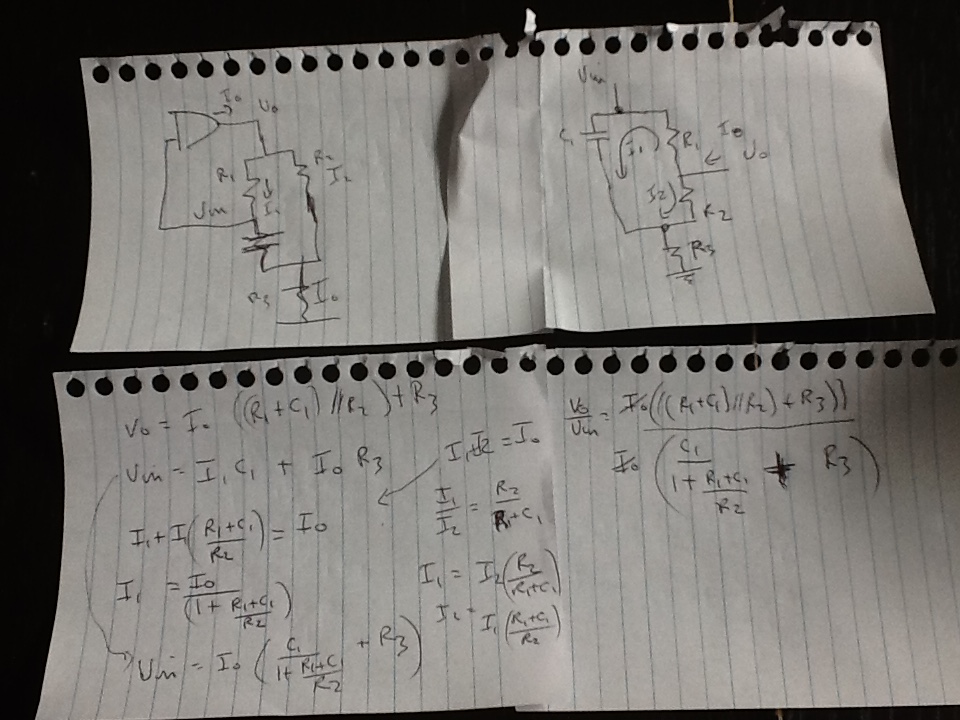

A quick napkin calc, please let me know if theres errors. C1 is the cap impedance not just the capacitance.
I can't see the equivalence of your circuit to the original? It seems re-arranged.
Jan
Oops your right. That the wrong circuit
Tried again, a bit more complicated and the results arent intuitive. ( if there right). And C1 should actualy be the cap impedance Z1

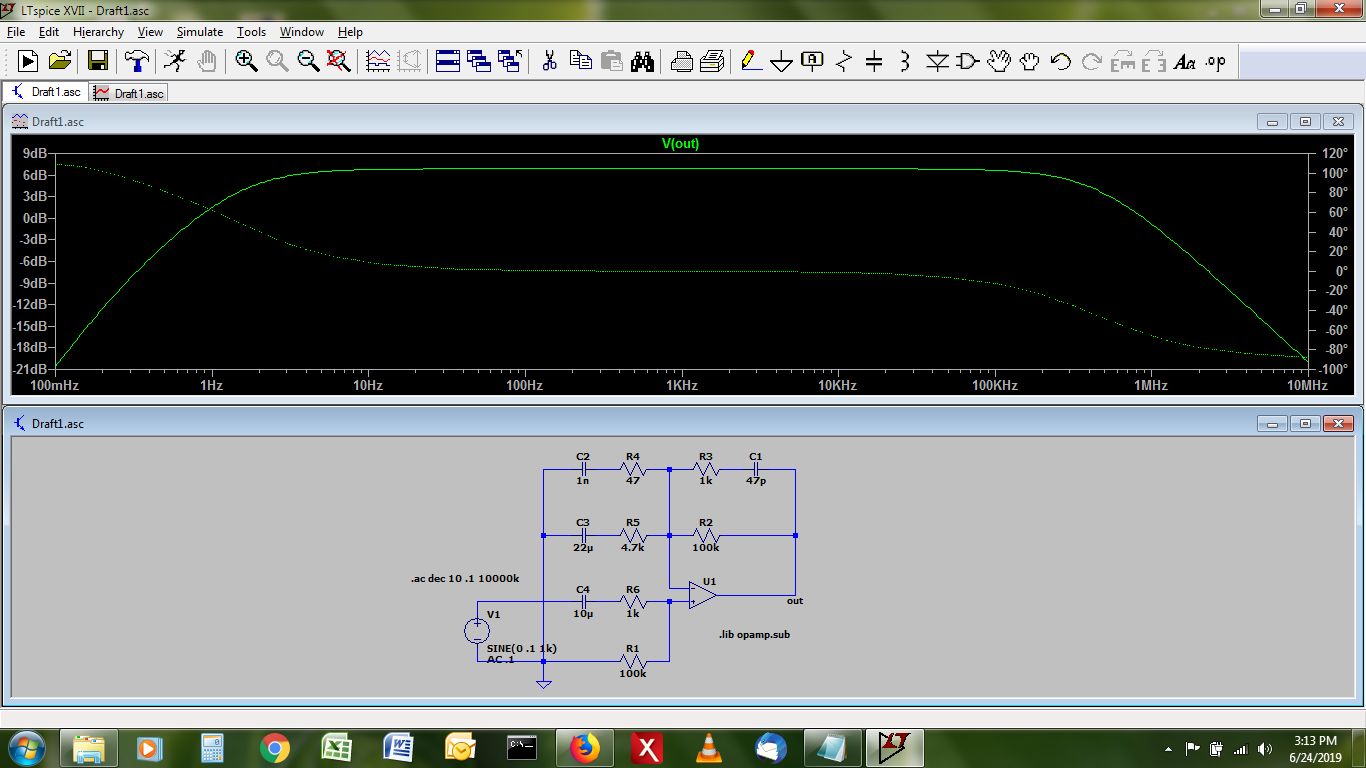

There is several points to this issue.
1. You can use a smaller shunt capacitor by using larger value resistors, but
2. this increases the divider impedance which lowers the pole with the negative input and can aggravate feedback stability.
3. Some put a small cap across the series resistor (~R1) but this
a. allows RF rectification of speaker cable antenna
b. effects the feedback stability
c. creates a bandwidth limit
4. Another issue is that a low value resistors get hot in larger amps, require large resistors.
So, any series cap needs a limiting resistor of 100 to 1K to prevent radio rectification.
My recommendation is two series RC networks across both resistors, ie a pole and a zero at the same frequency with the ratio of the two networks matching the ratio of the two feedback resistors. The result is rational power dissipation at audio frequencies and ~50 Ohms to the negative input at RF frequencies.

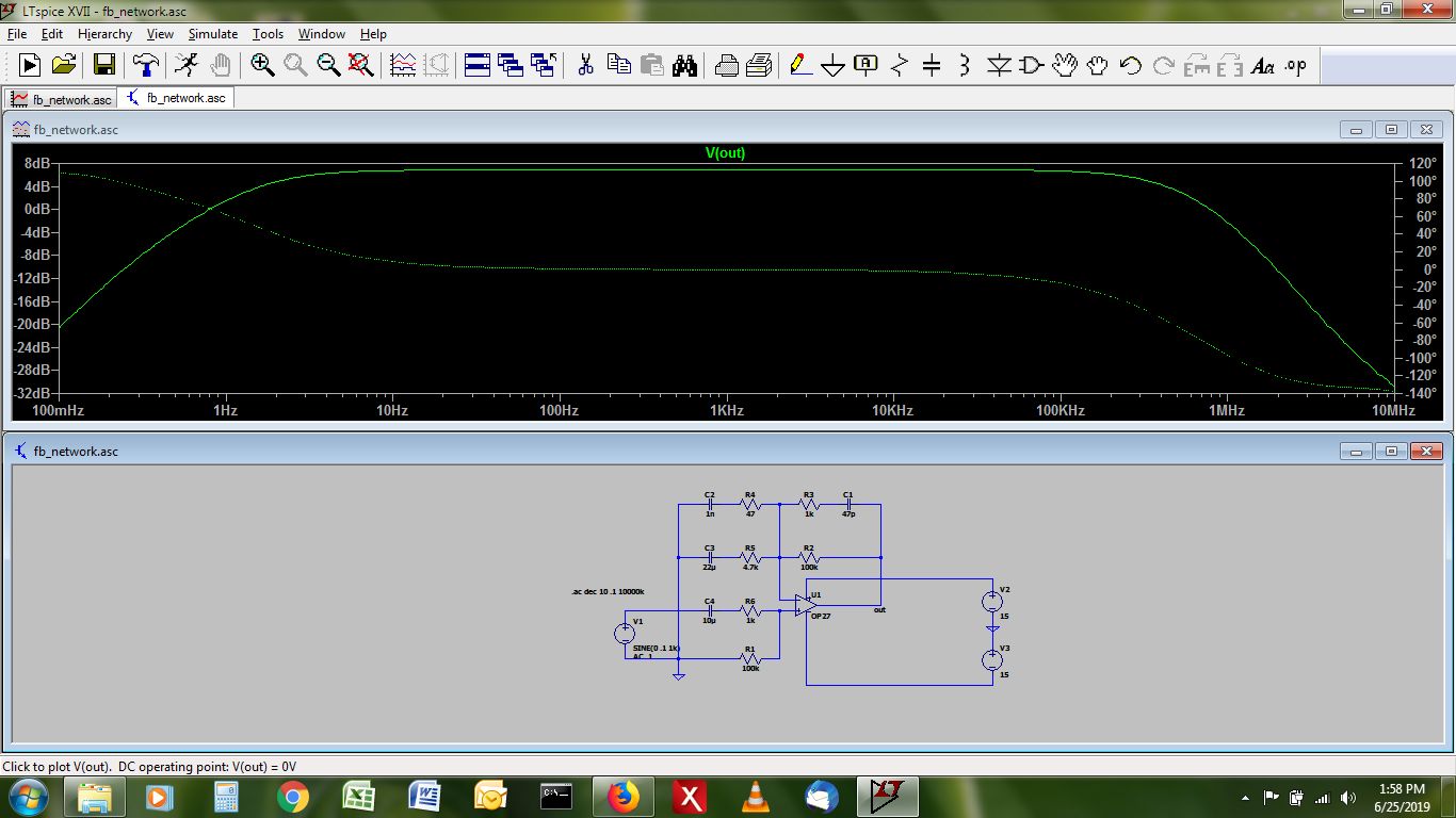

I looked at this with initially with OP27 as the IC and then with LT1057 both with 15 V +/- supplies. The circuit dc offset with the latter which has a FET input stage is OK however with the OP27 having BJT inputs the dc offset is around 3 Volts. The network as depicted in some ways reminds me of a tone control based around a non-inverting stage.

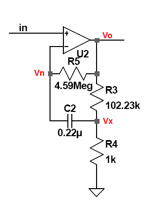

It kept me awake. By inspection:
Call the top of R4: Vx. Then Vx = R4/{R4 + (R3//[R5+Xc])}.
The feedback voltage is then: Vfb = [{Xc/(R5+Xc)} * (Vo-Vx)]+Vx.
Xc being the impedance of C2 and // means 'in parallel with'.
Now what?
Jan
jony how do you get there?? Can you do it step by step for dummies?
Jan
I use a "brute force" a Nodal analysis.
And wrote this forVn node.
(Vn - Vo)/R5 + (Vn - Vx)/(1/(s*C2)) = 0
And for Vx node.
Vx/R4 + (Vx - Vo)/R3 + (Vx - Vn)/(1/(s*C2)) = 0
And I solve for Vo I manage to find a transfer function.
AV = (1 + (C2 (R4 R5 + R3 (R4 + R5)) )/(R3 + R4) s)/(1 + (C2 R4 (R3 + R5) )/(R3 + R4) s)
Hence in the denominator of a transfer function, we have a single pole.
Fp = 1/( 2 * pi * C2* (R4 (R3 + R5) )/(R3 + R4) )

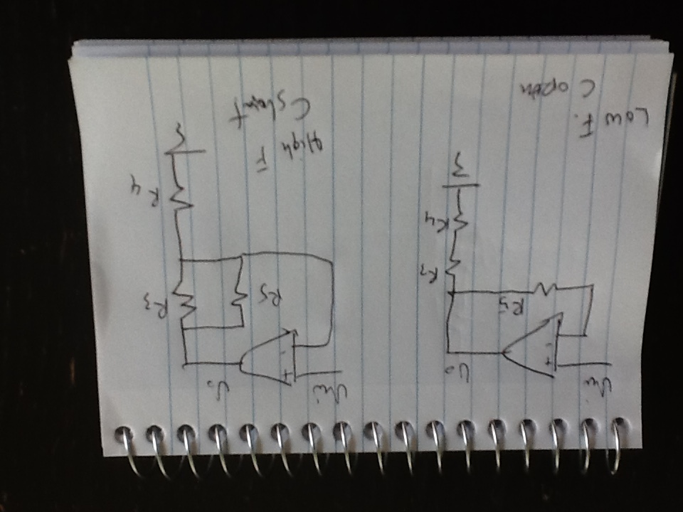

Now we look at the circuit at the freq extremes, where C is ( close to ) a short and an open.
At low f a gain of 1, at high f 1+ R5//R3 / R4 and since R5 is large 1+ R3/R4.
And I would GUESS the corner freq is at around Zc=R5 which is way up there. So a small cap will do. ( but Ild worry about parasitics at these high impedances?)
As the author says, its not HiFi.

I can't imagine what you did wrong but op27 works fine for me. The DC resistance presented to both inputs is 100k in this example in order to cancel any DC offset. The op-amp is a surrogate for a power amp where 20K to 50K is typical.
In any case this is about AC response and impedance, not DC. If you are not familiar with circuit dynamics then "don't worry about it."
