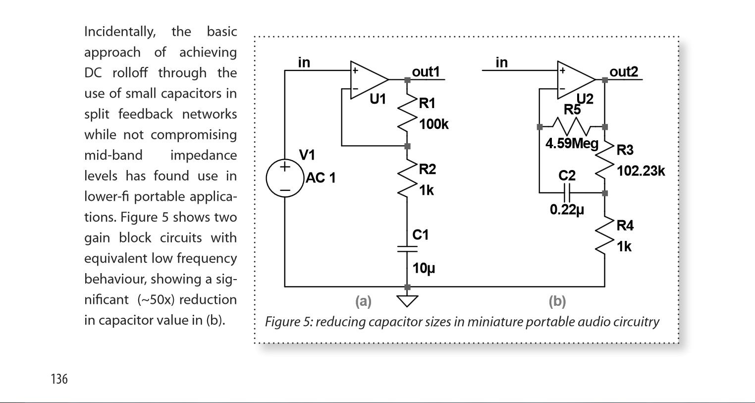

The supergainclone from Cordell's book also has a nice trick to avoid large value feedback caps but it's for an inverting config.
Actually you triggered my memory about a most relevant article I almost forgot about, in my own Linear Audio series! I must be getting old.
Here it is, complementary 😎
His figure 5b is what Jonathan showed in post # 26. But this time with a narrative ;-)

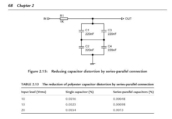

From "Small signal audio design" Cyril Bateman !

DC-blocking feedback capacitor is something totally different from capacitor in XO.. Think about AC voltage across capacitor terminals, and AC current.
you are completely missing the issues here, it is what is audible, not what is measurable
nonsens..🙄 For sure it is measurable.
I´ve seen that "capacitor trick" implemented on several Luxman power amps from the ´80s that were very well regarded. Like the M-02 and others.
Also simulated in LTSpice, comparing that with sim THD results using DC-Servo and blocking caps.
The only demand seems to be that the input transistor should be FETs.
I'm sure it can be used on line preamps, though I never saw anyone who did. It should be tricky to implement on a RIAA preamp.

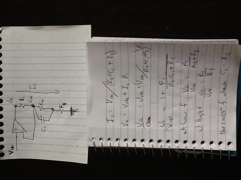

I have a novice question, hopefully not disturbing this interesting discussion. .

I'm trying to understand how the capacitor in this figure 5b is calculated. The author says the two circuits have the same low frequency behaviour, -3dB roll off I guess. For figure 5a it's 15,9Hz if I get it right. For figure 5b only way the 0,22μF capacitor to reach that is to work against 45,522 ohm. Is it 4.59M/(102.23k/1k)?
Interesting question, I don't have the answer right here. I think you should look at the signal across the cap. The voltage across the cap is very low, because both sides are at about Vin.
The impedance it works against I believe includes the opamp input impedance, but I am not sure.
I'll see if I can reach Kendall, to ask him! Thanks for bringing it up.
Jan

If I got my math right the pole frequency is at
Fp = 1/(2 * pi * (R4*(R3 + R5))/(R3 + R4) * C2 ) = 15.9Hz
Fc~=1/(2pi*R5*C2) * R3/R4.
The effective value of R5 appears as 1/100th of the resistor value because it sees 100x the voltage at the capacitor's right side pin.
Noise performance will by compromised big time, that's the price to pay for smallish capacitor values.
A quick napkin calc, please let me know if theres errors. C1 is the cap impedance not just the capacitance. Basically multiplying all the resitors and dividing the cap to get back to the same freq.
