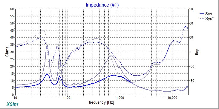

Are there any amplifiers involved, which have a significant output impedance, where there is a variation of the impedance of the driver from, say, the middle of its band, compared to its crossover end of its band?I am using all active(MiniDSP) so no real problems with crossover interaction.
The box resonance is wanted. It is a normal manifestation of a rolloff. The amp doesn't have to do anything special, as long as the box and amp together can produce something useable.I just wanted to quell any resonance in the passband

I might get flack for bringing this up, but for the tube amp / HF driver combo, you could flatten the impedance using an autotransformer with a swamping resistor in parallel between the amplifier and driver. The trade-off is wasting power heating a swamping resistor but you have at least 30 watts at your disposal so it’s really your call.
Since you’re using an active crossover upstream and no LF is present to saturate the autotransformer, you can get away with using an autotransformer with a relatively small core (making it inexpensive) which also lends itself to lower interwinding capacitance (less parasitics).

A PP EL84 amplifier should not have that high an output impedance. I have had the Grant Fidelity version of the Yaqin thru here and i figured it was the best amp they had. Joe Rasmussu also has/is using it s. abasis for his modeified amp, so i would guess he judges the iron fine.
I am not a big fan of speakers with ugly impedance, but this amp should not have too great an issue with them.
A PP Pentode amp can be made into a current amp by removing feedback, but then you would need close to absolute flat (or an impedance curve that aids the FR at the extremes).
