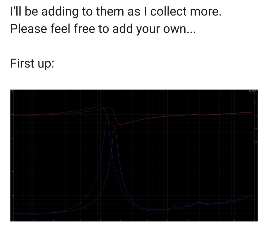

At first sight, the attachment looks like a solid black rectangle with nothing else (on my phone, see screenshot). Zooming into the black mass of nothingness shows some very faint dark red lines. Also some minuscule axis labels, again hardly readable. Hard to see the data and impossible to get an overview in deep zoom.
Can you provide a proper, easy to read plot?

stv
Joined 2005
Very nice idea!
I'll give it a try.
It's a 6 ohm-midrange driver, probably free air (no enclosure resonance wiggles visible). Low inductance.
There seems to be a higher temperature (or added resistance) for the purple trace. Identical wiggles above 1 kHz indicate identical cone (?) or suspension resonances.
Some strange wiggles between 200-300 Hz for the blue trace might be result of not perfectly attached added mass ...

Joined 2005
That's what I wanted to say, but now I am too late.

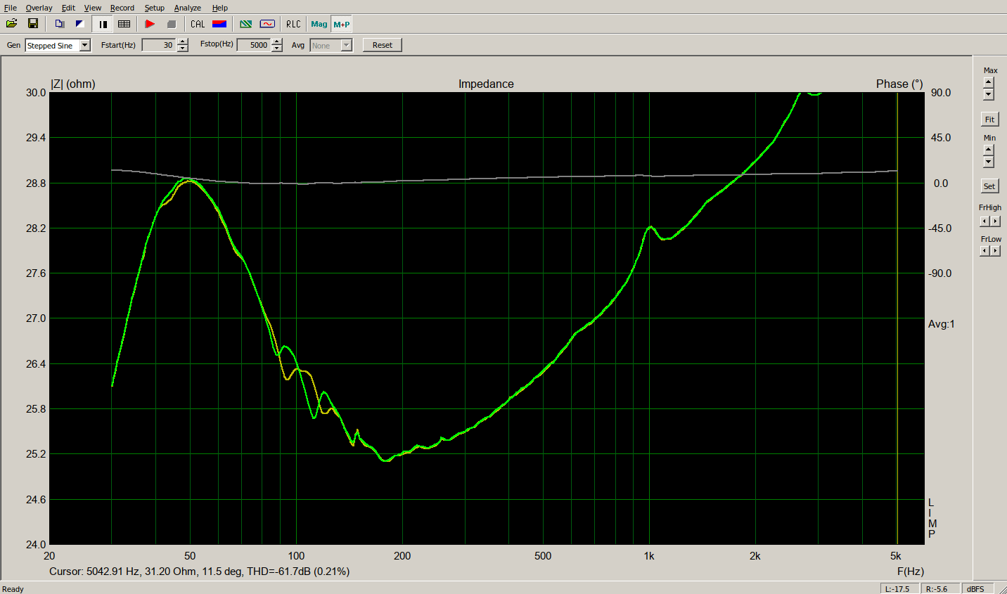

ITEM 108 #8
That's a weird one
As I think about how many clues to give, the speaker plays music that I like. Okay, two of them. There's nothing strange about that. Maybe a little low in [published;)] nonlinear harmonic distortion.
Impedance is almost flat, and so it makes sense that phase is almost flat, too.
What is unusual is that impedance is rather high (25...30 Ohm) and almost perfectly flat (within +/- 1.5 Ohm up to 2 kHz). Why is that?
SCIENTIFIC COMMUNICATOR AWARD
I will never receive such a prestigious award :cry:
Best regards
Bernd

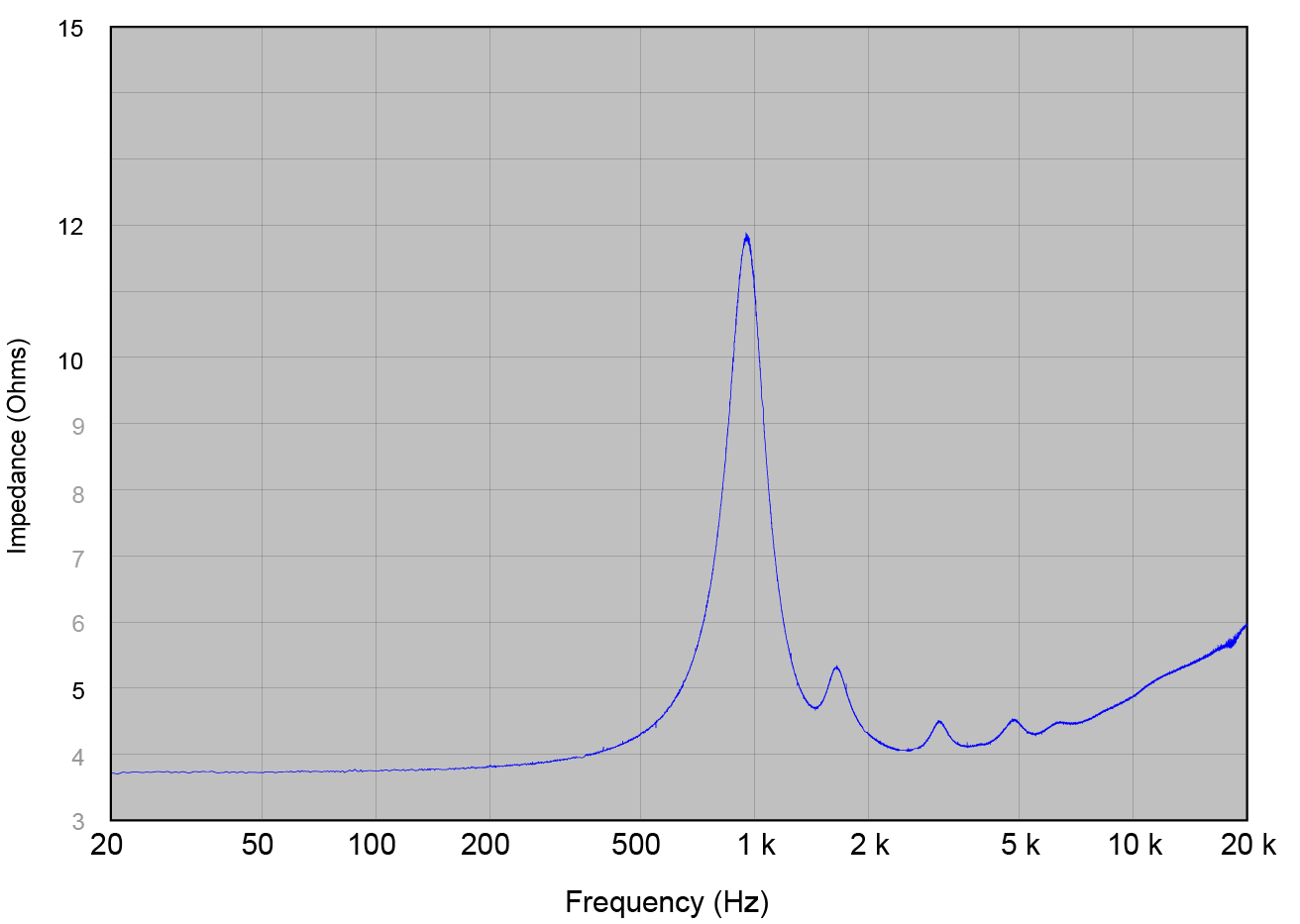

my guess for ITEM4:
a tweeter, supposedly a dome tweeter with a small resonance peak caused by lack of dampening for back-chamber and/or behind-voice-coil-gap air volume resonance.
I once created something similar that by removing ferrofluid and increasing a tweeter back chamber by drilling the pole piece.

different samples.
Yes, indeed! Impedance peak at john krutke's version has only 9 ohm peak. And there still seems to be a slight impedance elevation around 2,5 kHz?
What would you do?
If it's cheap and possible I would open it carefully and check the dampening material (if there is any), eventually test melamine foam shaped to not touch the dome - for science.
But if it's an expensive part definitely best to send it back for replacement.
Joined 2005
Dismantling mean breaking glue lines, so it was probably never designed to be repaired. And thus low cost.
But @stv you get GOLDENEYE award. Indeed poor damping or mis-damping is a common reason for dual impedance peaks. I've experienced this in the past with a different tweeter, where I replaced the voice coil/dome assembly but didn't reassemble it correctly.
