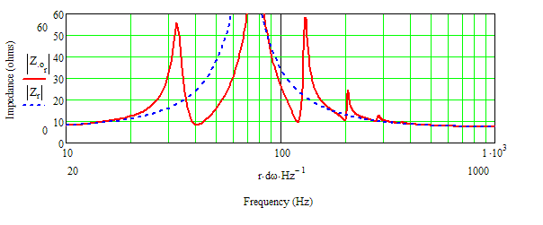

Has anyone ever measured the impedance vs. frequency profile for a Saburo? I'm just curious if this is typical. I guess I didn't expect to see so many peaks.

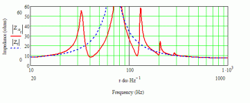

No, quite correct. Welcome to the laws of physics where when mouth size is compromised over the optimal for a given Fo, the acoustic impedance is no longer fully resistive & we're relying more on resonant action. Bends aren't particularly an issue, as you can see from the attached. Top = Saburo horn unfolded, expanding cascade of straight manifolds. Bottom = unfolded horn with same St, Sl & basic flare profile but with continuous expansion. Short of damping them per a TL, this applies to any pipe or 'cone' / expanding pipe with a compromised terminus area. And most are (unless you've room for a horn with a 50ft^2 mouth CSA. Per cabinet).

You will have noticed, I trust, the rather accurate correlation between the graphs posted above?

No, it's not got much to do with the manifolds per se; that was the point I was making with the above two graphs. Forget folds for a moment: just assume it's all straightened out i.e. heading in the same direction. Top plot is just that, lower plot is a horn with the same throat & terminus area as Saburo, and the same basic flare profile it approximates, but with continuous (i.e. smooth) expansion. Not much of a difference, right? Most back-horns are not impedance matched down to cut off. They can't be; you need huge mouth sizes to do that, so they rely on resonant action on the bottom end until they reach impedance-matching higher up.

I've never seen (or at least noticed) harmonics on an impedance plot, and it looks like that's what is there (e.g., on your top graph, peaks seem to be multiples of ~30, the dips multiples of ~45).
So I gather that "impedance matched" would mean "designed to have a flat impedance" (sorry to be dense)?
Not exactly. As noted above, it is in reference to compromised terminus size. When terminus area of a horn is undersized, as it almost invariably has to be for bass horns, you get a standing wave (supersonic shockwave) reflected back along the horn path. Horns are basically impedance matching devices, viz. matching the high impedance of the diaphram to the low impedance of the air, and thereby improving efficiency as the driver is 'seeing' a constant resistive load at all frequencies in its functional BW. Nominally horn terminus circumference should be a minimum of 1 wavelength of the lowest frequency to be reproduced in order to avoid this; depending on localised SoS for a 40Hz horn you're looking in the order of termini areas of 50ft^2+. More to it than that as you need to consider boundary loadings, whether a particular horn is reactance annulled (back horns usually aren't, although it's technically possible); you also need to be careful in other areas -Keele has demonstrated that beyond a certain mouth size efficiency will begin to drop away.

MLTL does not = horn. It's an MLTL, viz. an untapered quarter-wave resonator resistively loaded by choking down the terminus area with a slot, port or whatever. What harmonic modes remain are then minimised by placing the driver at x distance from the throat, with the remainder being damped out by appropriately stuffing or lining the pipe.
A horn, at its simplest, may be regarded as simply a pipe that expands toward the terminus.
