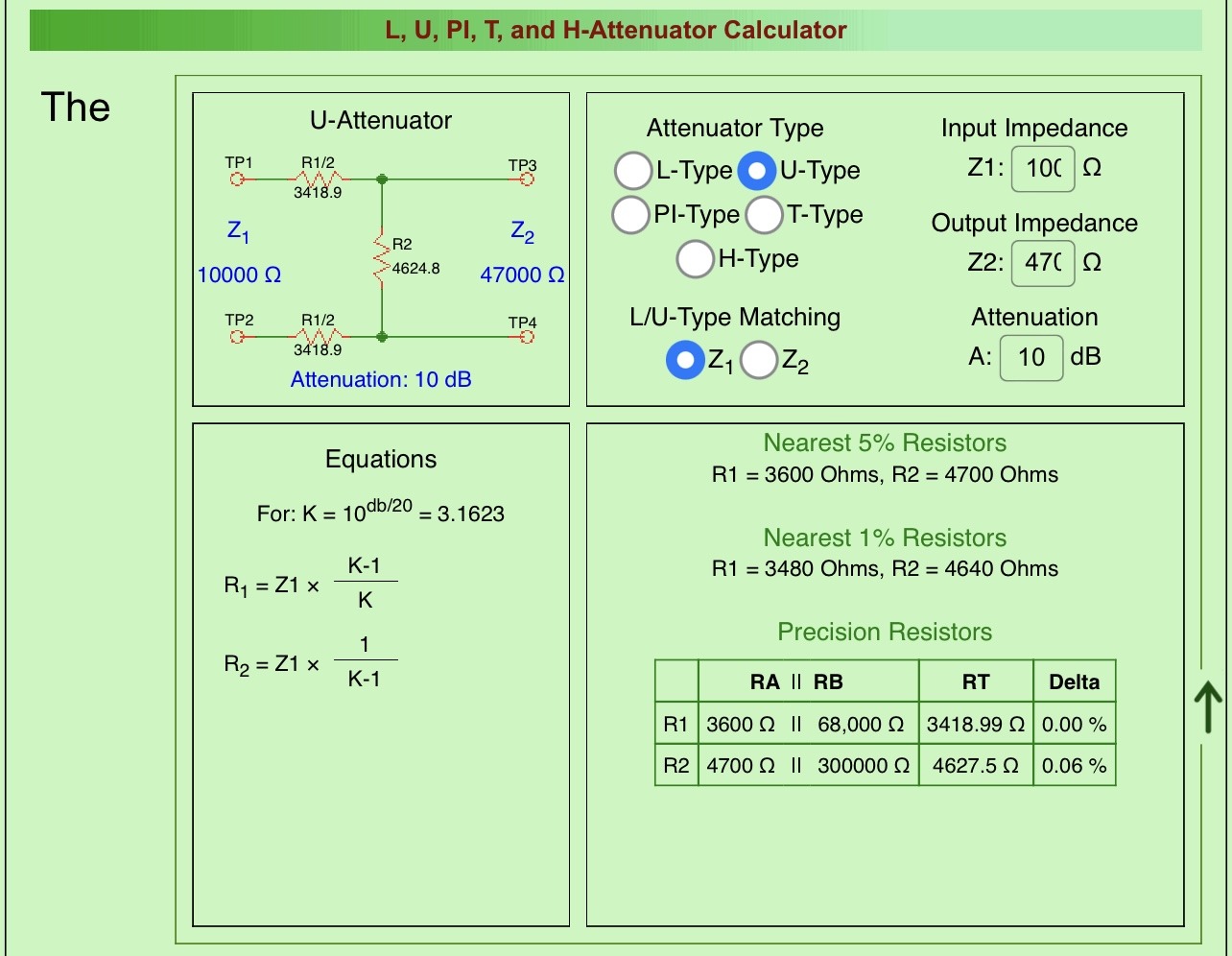

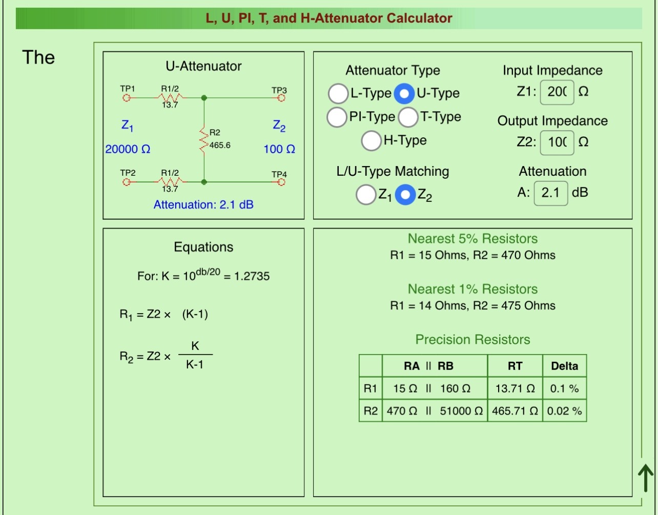

But I’m confused about what input/output impedance I should set for the u-pad attenuator. I see there are calculators online that provides this type of calculation: https://k7mem.com/Res_Attenuator.html
And it looks like I can either match impedance towards input(Z1) or output(Z2) impedance. I did some search but still can’t understand which way should I match the impedance.

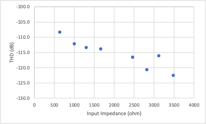

The motu’s output impedance is 220 ohm and I saw an experienced user measured the THD giving different load using e1da ADC on ASR. It looks like 1.5k ohm will not be an optimal input impedance for motu. So should I just leave the AMP’s buffer stage there so that the input impedance is 47k ohm?

The reason I want to add an analog u-pad attenuator is because the sound card is connect to two amps of different gain. One with 9.4dB, one with 20dB. I can do 10dB digital attenuation but since I only have a digital volume control and I usually set the volume at -30dB, this adds up to 40dB digital attenuation in total. So I’m thinking that analog attenuator will perform slightly better.
Impedance matching is not important but every u-pad calculator online is asking me to type in a value for input/output(Z1/Z2) impedance to calculate the series and the shunt resistor values. According to the online calculator, when attenuate 10dB, K is around 3.16, then series resistor value=Z2*(K-1).

The motu is 220ohm output impedance. So if I want to have 10dB attenuation, it would be 20*log_10(3.16)=10. So as long as R_shunt🙁R_series+R_shunt)=1:3, it would be good? In a u-pad, suppose R_series=2k2, then R_shunt is about 1k, R_series 1/2 is then 1k1 ohm. Is my calculation right?
The actual resistance values are irrelevant as long as they are higher than the source impedance, the ratio between them is important. Those values will work. Why not use a potentiometer? Forget about the U-pad.

I understand impedance matching are only for RF applications and for audio they are not necessary. But input/ouput impedance still matters in the sense that input😱utput impedance ratio should be at least be 1:10 right? Someone measured motu with different load with e1da ADC and it looks like it performs the best with 4k ohm.
So, suppose the series resistors are 1.1k and shunt is 1k, to calculate the input impedance the motu sees, it’s basically (47kohm || 1k)+2.2k right? Which is about 3.2kohm. This is more than 10 times 220ohm. So it should be fine for the motu. But for optimality, 3.5k ohm would be better right?
The opposite direction. For the Amp, the output impedance it sees is (220ohm+2.2k ohm) || 1k ohm, which is about 3k ohm. Less than 1/10 of the input impedance of the amp.

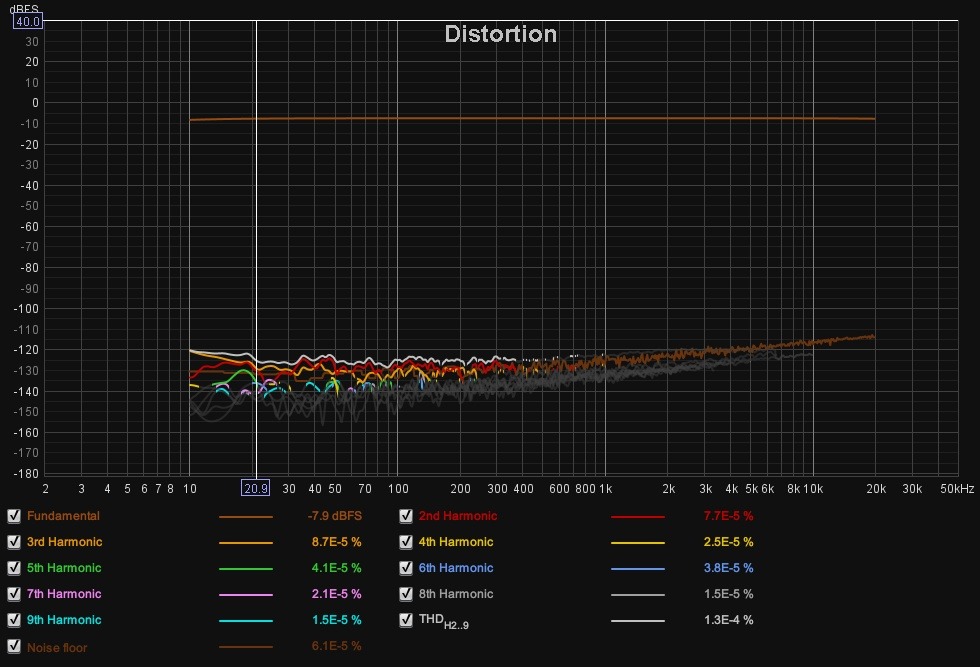

I tested with cheap 1% resistors. Two 1.2k series ressitors and one 1k parallel resistor, soldered to the XLR terminal. The test is done using motu's Line Out 7(TRS out) connected to Mic In 1(XLR in). Main volume of motu is set to -14dB since 0dB will cause the Mic in to clip. The attenuation is about -12dB, more than expected. Not sure why. But I guess the distortion graph comparing analog and digital volume makes sense?
