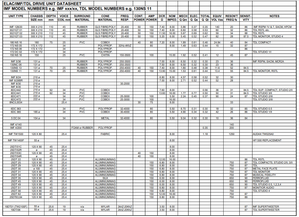

Looks like it´s an IMF / ELAC 8/28 BR. This late version with the "rips" you find at the IMF ALS 40 II. Please check the diameter of the voicecoil.
This are the only specs I have:
You can find it at the Falcon-Acoustics site also...
Grüssle Henner

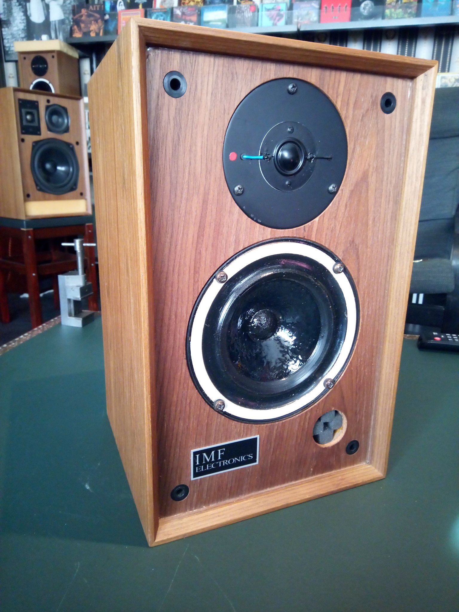

The IMF Compacts
This Thread is about the smaller models of IMF. Some years ago, I just wanted to test the "IMF house sound" - I planned to buy one of the big transmissionline models of this manufacturer but than a pair of the smaller 3 way Super Coompact II came my way and I decided to buy them for small money, because they had the same mids and tweeter as their big brother. Since then I´m listenig to them and some other compact IMF speakers.
I want to start with the 2-way Compact II:
The tweeter is the well known KEF T27 that is also used at the little LS 3/5a BBC monitor.

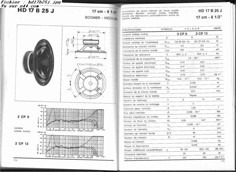

The mid/woofer ist an coated version of an Audax:

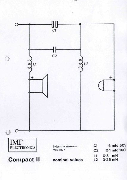

...and this is the crossover:

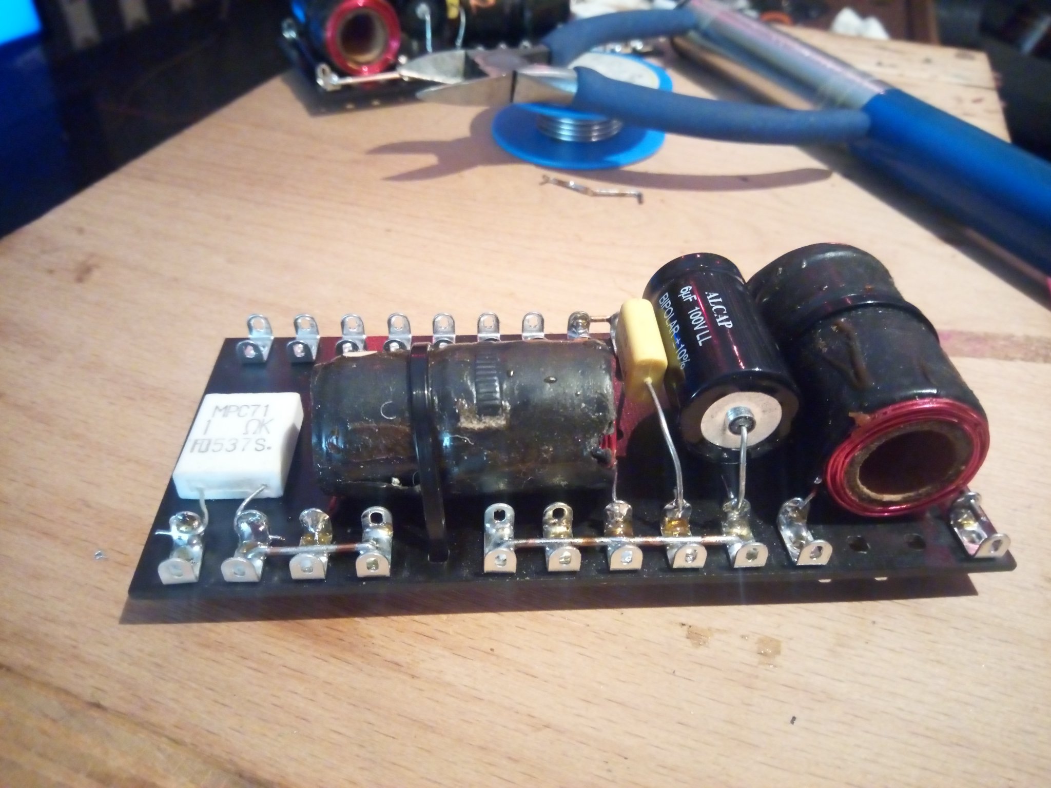

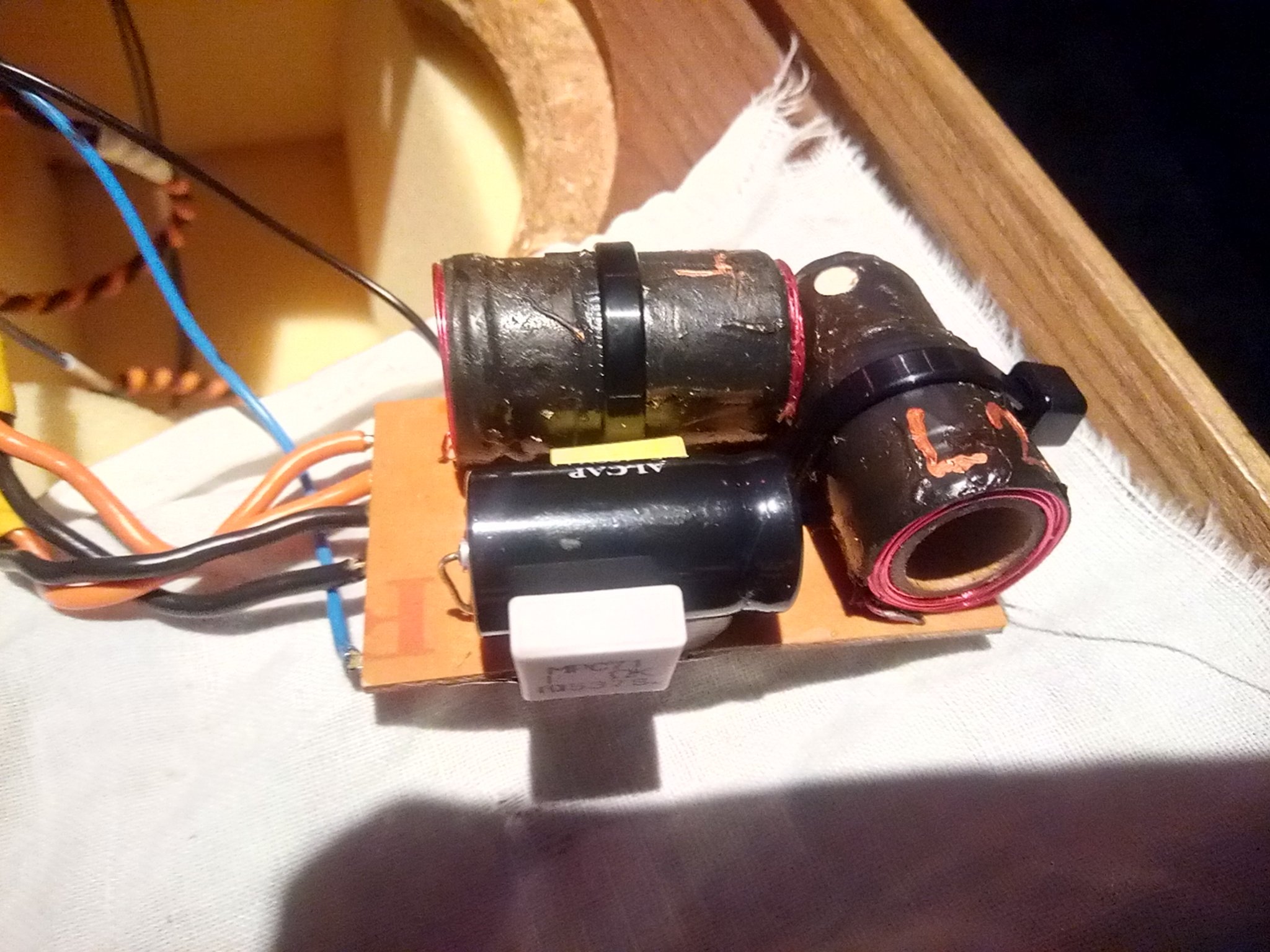

The original capacitors are a typiclal electrolytic "elcap" (C1) and a Philips "chicklet" Type 341... (C2). Together they work far better, than one might guess.

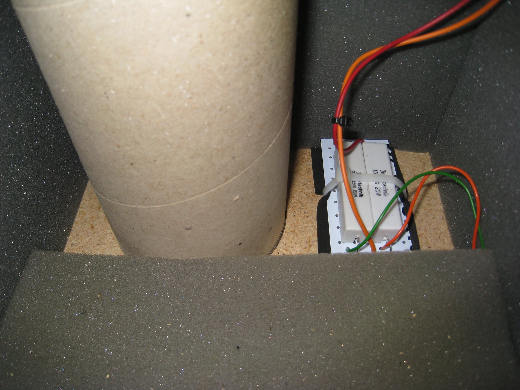

Because of the age, it´s better to replace C1 - otherwise you have to listen 20 to 30 minutes untill it wakes up and the stereo image might not be very symmetrical. The little Philips is usally not on the end of its lifetime. The crossover is glued to the damping foam, wich is a big mess, if you want to clean it for soldering. After the repair it´s better to fix it on the bottom of the speaker ( you will need longer wires then ).
If you aim to an "next to original restauration", the english company Falcon Acoustics sells Replacements, that seem to have a little lower ESR and you might want to use a 1 ohm resistor to balance that.
It may look like this then:
But it´s not recommended to use the original circuit bord, because it is very weak and the conductors loosen from the pertinax board. I rather use something solid like that:
Now I´m hungry ... the thread will continue very soon 😉
Hi, thanks for this very interesting information. I just bought a set of these Compact IIs and am very impressed with the sound. I would like to try if replacing the C1’s has audible benefits, so I ordered caps to test this, including the 1 Ohm resistors that you suggest. It is not entirely clear to me where you placed these resistors: are they simply in series with C1 to correct for the lower internal R of the cap? Your help is much appreciated. BW, Martin

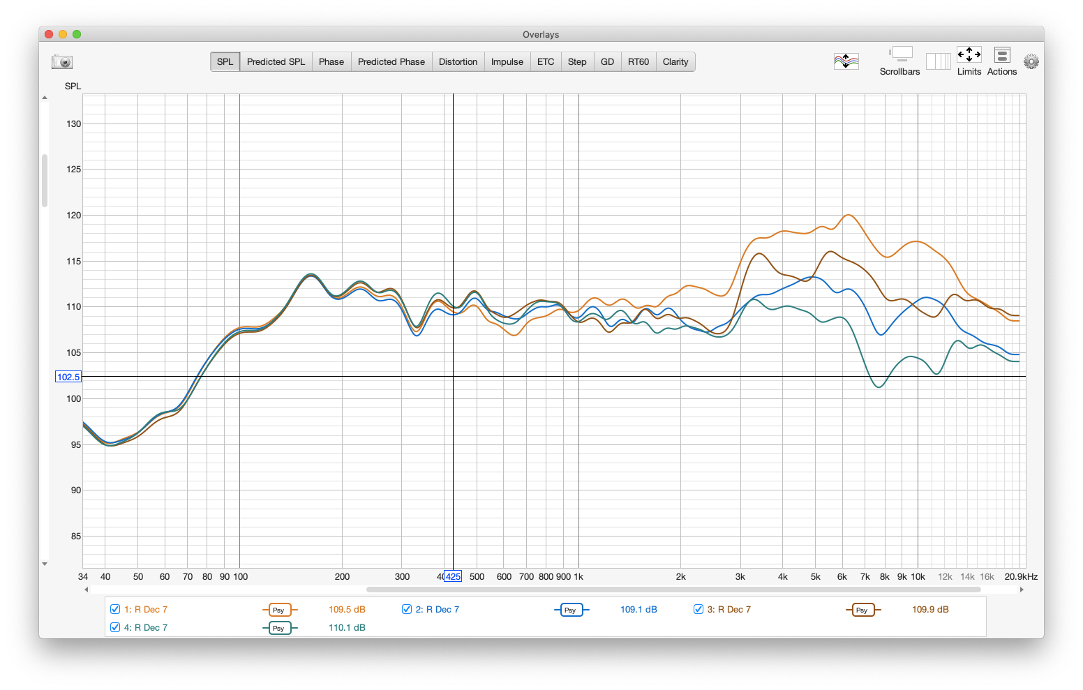

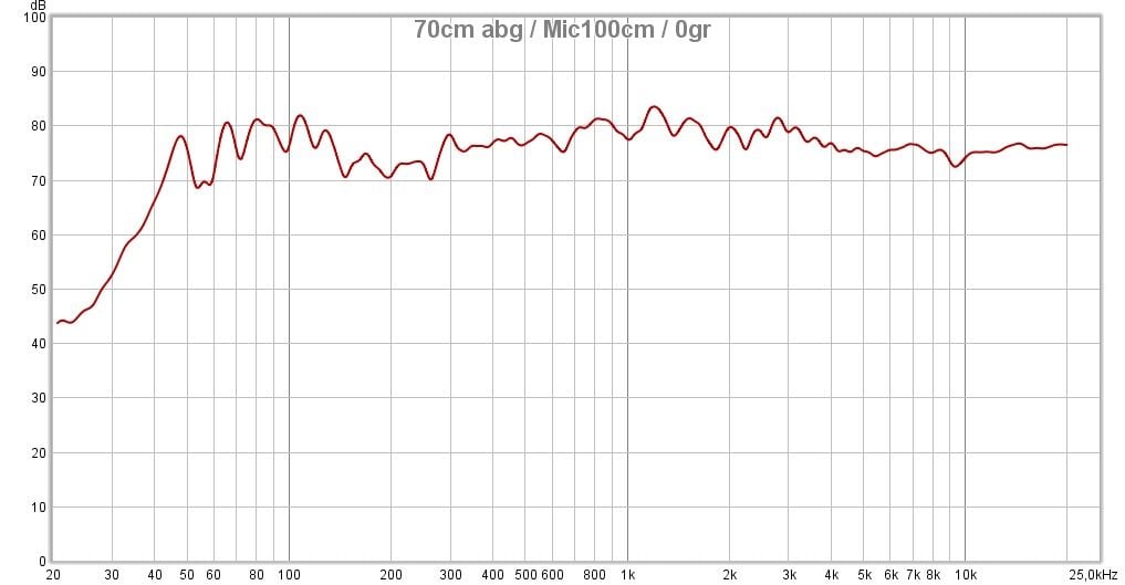

@defektzero I took a closer look and decided that the resistor should indeed be inserted with the cap. I ordered 6,2 uF / 100V caps from Jantzen and several resistors. Best audible results were with 8 Ohm (20W) resistors. This was confirmed in the REW measurements, that showed some 5-8 dB attenuation in the higher frequency range. Very happy with this adjustment!
