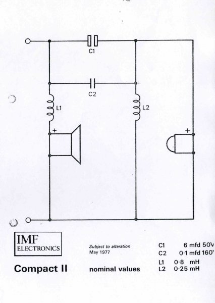

...and this is the crossover:

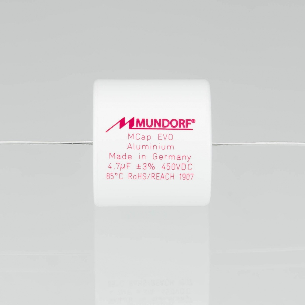

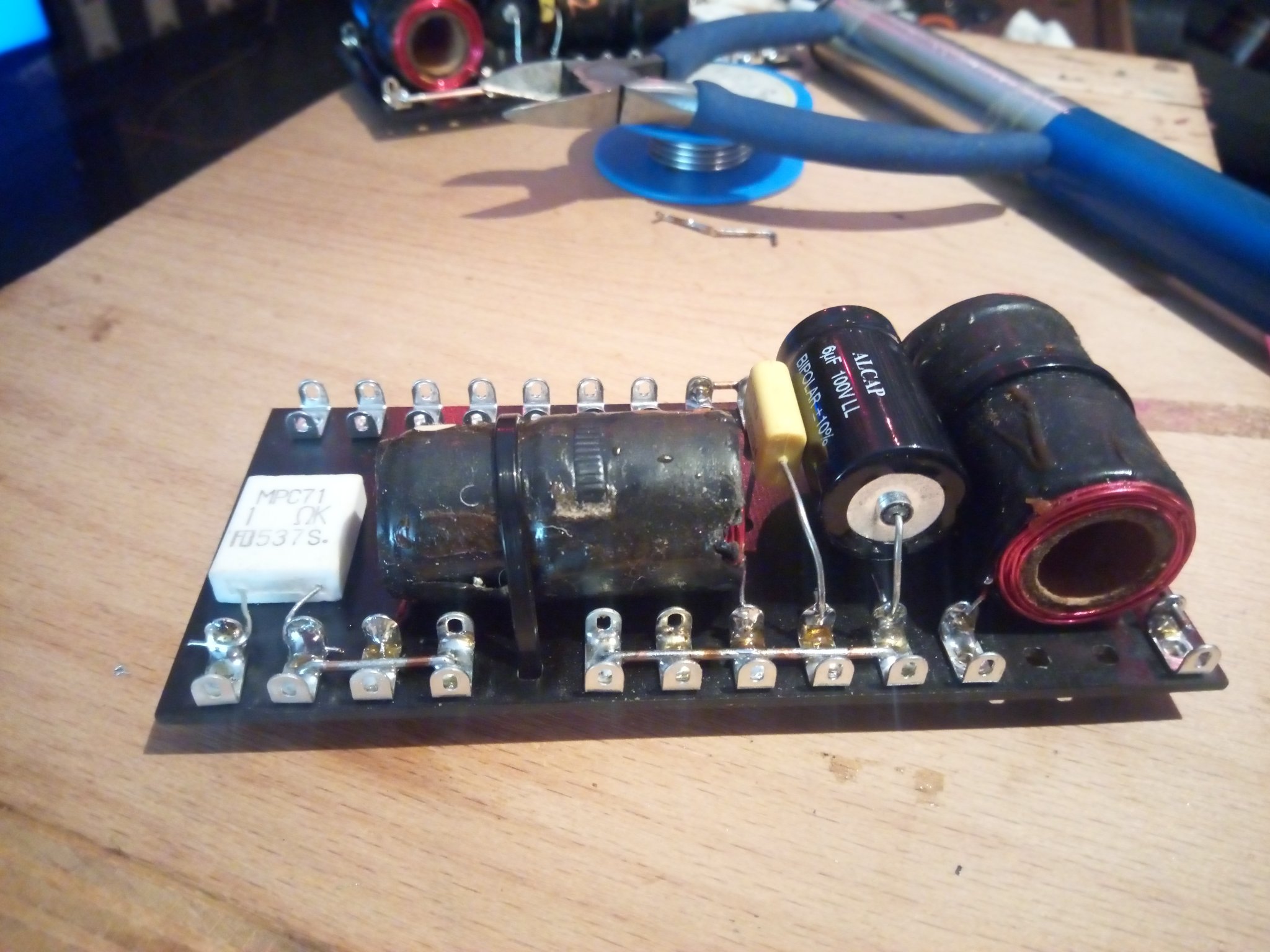

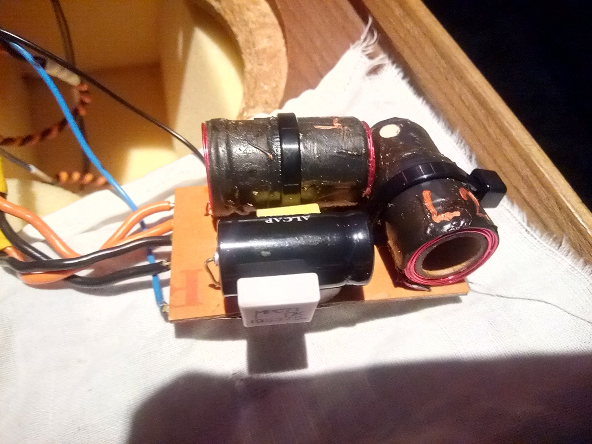

The original capacitors are a typiclal electrolytic "elcap" (C1) and a Philips "chicklet" Type 341... (C2). Together they work far better, than one might guess.
Because of the age, it´s better to replace C1 - otherwise you have to listen 20 to 30 minutes untill it wakes up and the stereo image might not be very symmetrical. The little Philips is usally not on the end of its lifetime. The crossover is glued to the damping foam, wich is a big mess, if you want to clean it for soldering. After the repair it´s better to fix it on the bottom of the speaker ( you will need longer wires then ).
If you aim to an "next to original restauration", the english company Falcon Acoustics sells Replacements, that seem to have a little lower ESR and you might want to use a 1 ohm resistor to balance that.
It may look like this then:
But it´s not recommended to use the original circuit bord, because it is very weak and the conductors loosen from the pertinax board. I rather use something solid like that:
Now I´m hungry ... the thread will continue very soon ;)

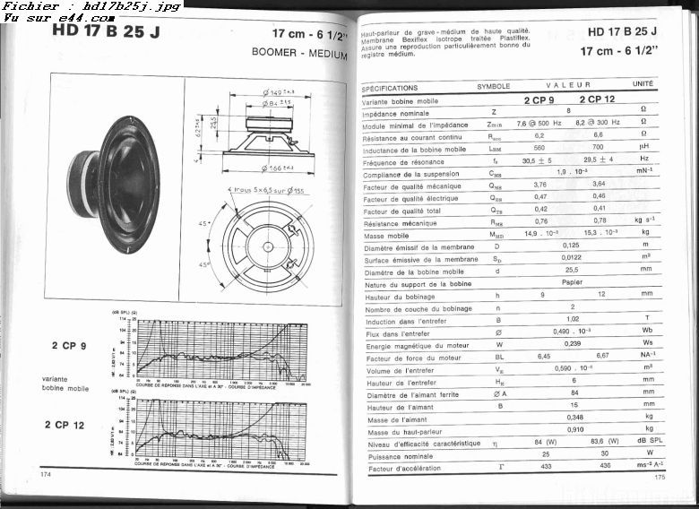

That brings back memeories, Audax HD17 has at least a bit of a coating.
I just happen to have a single sitting in the original box, they are a bit fragile — they ar efor a set of wall mont Divas which math them with an Audax tweeter.
Later, in their RS models, Tangent use dthe KEF T27 with HD20 in a similar arrnagent.
You can se ethe damping foam in the vent — does it have any depth or just a hole in the baffle? — will push the box towards aperiodic.

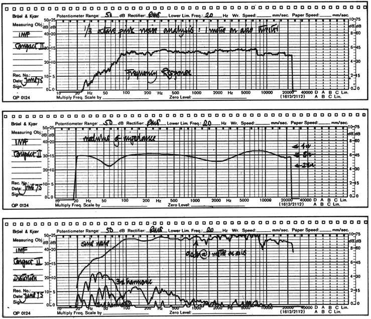

The second problem is: The T27 is a bit too loud. The speaker ist designed to be used with a front cover, but even when you put it on, it plays 2 to 3 dB too loud. If you listen to some audiophile electronic music like Kruder & Dorfmeister or some triphop stuff, the sound is perfect - but when you listen to a screaming guitar, it is too much and your ears are bleeding.
I don´t know, why it is that way. The original measurements did not show that:
Maybe they did a little cosmetic for the catalogue ;)
I made some own measurements, but the diagrams died with the harddisc of my last computer.

Her is some data and information from IMF:
IMF Compact II​
This is the smallest IMF speaker, 2 ways.
Drivers reference : Tweeter : unknown; Bass : unknown
https://www.imf-electronics.com/hom...gories/the-compacts/compact-ii#h.dyld7uvwfdvm
Description​
The original IMF Compact Loudspeakers were a great success. Despite opinions to the contrary, the Compact demonstrated that there is a sophisticated strata of the hi-fi buying public who do not judge the merits of a loudspeaker system on a cost versus size basis. The advantages of applying the same attention to design detail as in our IMF Monitor loudspeakers to enclosures of modest proportions are, apparently, obvious even to the novitiate. This demands a loudspeaker that necessarily needs to be made at a price, rather than to a price.
The IMF Compact Il employs a bextrene unit of specified piston area and excursion such as to provide homogenous niid-range and low frequency performance. This is complemented by a dome tweeter and the whole unit integrated by low loss crossover and phase correction circuitry. Bass performance is maintained via a critically tuned and optimumly damped reflex enclosure (see illustration). Indeed, had dimensions of the enclosure or drivers in the Compact Il been greater, it would not have been possible to achieve such smooth and extended response without resort to an additional separate mid-range unit and associate complex electronics such as apply to the IMF Super Compact. In all, the Compact Il sounds larger than its size, providing wide dispersion and remarkable low frequency extension, and represents superb value for space.
With the Super- Compact, enclosure size is sufficient to accommodate the use of a bass unit with a free ai resonance around 25Hz. The drawing illustrates the resistive loading conditions which, whilst not impairing the exceptional bass response, damps the system against 'cone weave' from unwanted subsonic signals The mid-range is isolated in its own short transmission line and this unit along with the tweeter is similar to those we used in our Studio TLS 50 and ALS 4 loudspeakers.
The decision was also made to adopt the same complex and expensive crossover and mirror image configuration as in these larger models. This results in two important advantages. The in-line crossover network has been developed as a no compromise optimum filter for the drive units employed and as such, provides the minimum of colouration and thus the maximum sense of acoustic transparency. Secondly, it ensures that the phase and dispersion characteristics of the SuperCompact are substantially identical to those of the TLS 50 and ALS 40. Thus all three models are compatible for four-channel applications. Research demonstrates that dissimilar loudspeakers cannot be used for four channels any more than unmatched speakers are acceptable for stereo. Even choosing all loudspeakers from the same manufacturer is no guarantee of compatibility unless the speakers have the same phase relationship throughout the range and a substantially similar integrated performance. With an eye to the future, IMF in their Super-Compact have ensured this compatibility and anticipate that many of these speakers will compliment IMF Studio or ALS 40 loudspeakers for rear channel information. Meanwhile the prospective customer can purchase now without .fear of pending obsolescence.
We have said very little about the sound of Compacts, which in a way is a good thing for both have little of the obvious 'hi-fi' qualities about them. Low frequencies are remarkably extended for their enclosures sizes, but are smooth and free from the exaggerations of 'one note bass'. The middle and top has a sense of 'sheen' and continuity - rather than the sound of multiple speakers working in a box. Although of moderate efficiency, such is the freedom from distortion and colouration, that listening at low levels as well as high, gives a sense of balance that reveals all that is worthwhile over a wide variety of programmed sources. The speakers are worthy of the best amplifiers and indeed the finest ancilliary equipment. We invite you to audition the IMF Compact 11 and Super Compact loudspeakers against others beyond their size category.
https://www.imf-electronics.com/hom...gories/the-compacts/compact-ii#h.840195s0b5d0
NOMINAL SPECIFICATIONS​
COMPACT II
Dimensions
5" x 9" x 9-1/2" wide; 38 cm x 23 cm x 24 cm
Drive Units
6.5" 16.5 cm bextrene mid-range bass unit with domed tweeter
Crossover
Electrical two way at 4kHz
Frequency Range
35 Hz 20 kHz
Frequency- Response & Dîstortion Characteristics
See Graphs
Dispersion
See Polar Diagram
Matching Impedence
4 - 8 ohms (see graph)
Efficiency Measured via Pink Noise at 1 metre on axis for 40 watts
99dB
Driving Power Requirements
15 - 40 watts
Nett Weight (each)
6 kgs
Gross Weight Packed (pair)
15 kgs
Subject to alteration without notice.
IMF International, Westbourne Street, High Wycombe, Bucks. Telephone High Wycombe 35576
Reactions: 1 user

Sometimes I find vintage speakers and ask myself: What is the progress in the past 40 - 50 years in developing speakers??? If this happens, I buy 3 pairs of them. The first pair stays original, the second ist restored to a most possible close to original performance and with the third one I´m looking for the best performance with modern parts in the crossover.
This is such a speaker model and btw the tweeter is build again by Falcon Acoustics and the woofer can be restored. If I succeed in teaching the speaker a more balanced tonality, then it will be one of the better ones I've heard in my life.

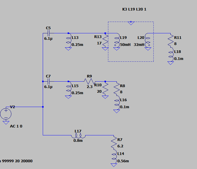

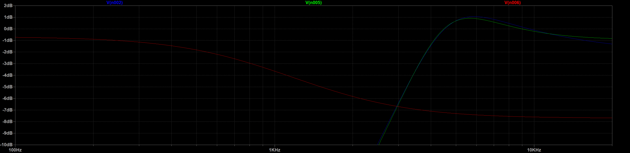

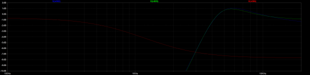

Chiming in with the LTSpice models of the crossover with 3 dB L-pad and autoformer. Might be worth measuring the response to see, if the hump at 5-6 kHz is necessary.
LTSpice
With the program installed you can open the asc file and play around with values and see what it does. Click on Simulate -> Run then you can probe around the circuit with the mouse and click on measuring points to see the voltage.
:cheers:

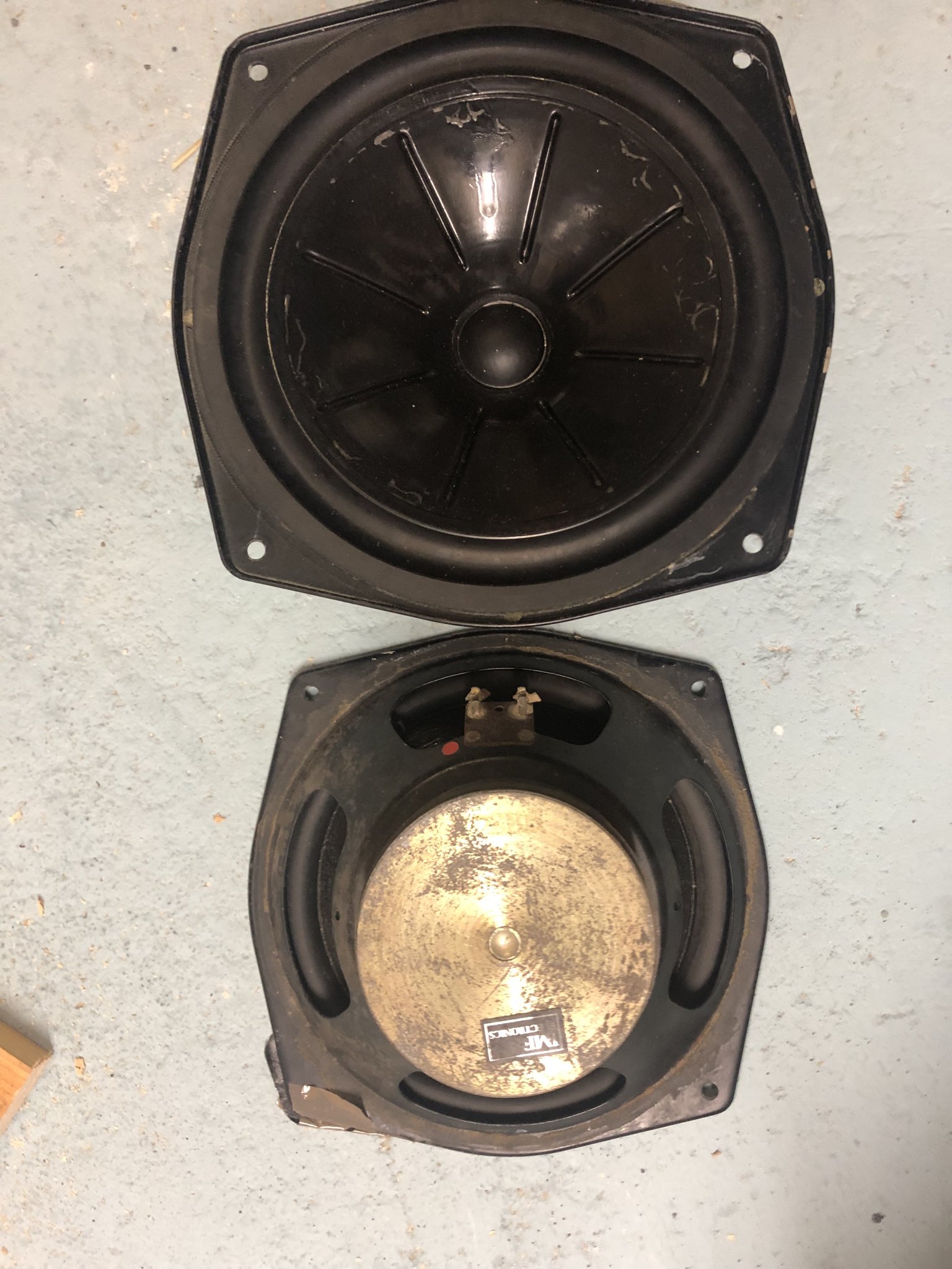

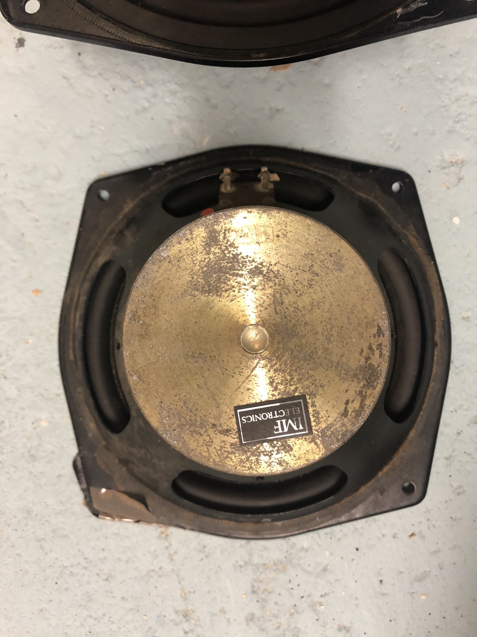

Hi I wondered if you had any knowledge of these IMF bass/mid units - I am trying to find their specification. The cone is 18cm and the outside dimension 21cm. I am pretty sure they are 8 ohm. Have had them for some time and was looking to use them in a 2 way speaker build.
