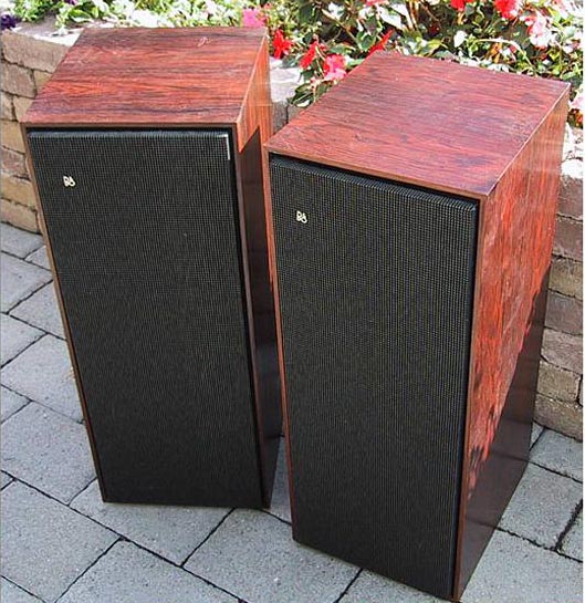

So I've only just discovered the world of DIY audio.. hope you can stand some really base questions from an audio imbecile.
So here's the first one.. I recently purchased a pair of Bang & Olufsen model 2600s at a garage sale. These things are like 30something years old, but they sound beautiful. However, one of the woofers produces a very slight buzz or rattle at the low end, pretty much at any volume level. Is it blown? What should I look for when I pull it out? I would love to fix it if it's possible.
Thanks for the help..
Are these the ones??
When you pull the driver out check for anything that could be resting on/rubbing aganst the cone, including the tinsel leads (the small wires leading to the base of the cone).
Also fire the driver up while you're holding it to check if it is just the driver or it's mount+box causing the problem.
I suspect that it is a half burnt voice coil though...

There's quite a bit more information than that on the bass driver.
f3 = 30 (in the box)
Nominal Impedance = 4ohms
Sensitivity = 90db-W-m
Frequency Range is 30Hz to 2kHz
Box volume = 25litre
Loading = Sealed
Now you need to add some information from your one good driver.
