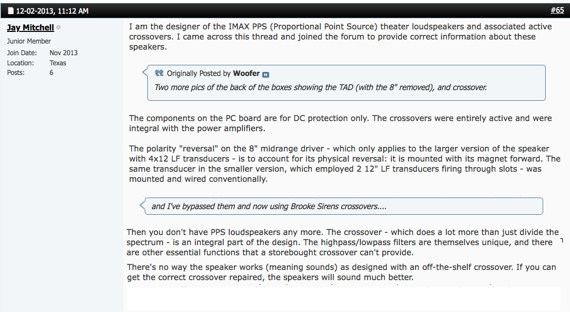

Jay Mitchell over at LHF said:I am the designer of the IMAX PPS (Proportional Point Source) theater loudspeakers and associated active crossovers. I came across this thread and joined the forum to provide correct information about these speakers.
Originally Posted by Woofer![]()
Two more pics of the back of the boxes showing the TAD (with the 8" removed), and crossover.
The components on the PC board are for DC protection only. The crossovers were entirely active and were integral with the power amplifiers.
The polarity "reversal" on the 8" midrange driver - which only applies to the larger version of the speaker with 4x12 LF transducers - is to account for its physical reversal: it is mounted with its magnet forward. The same transducer in the smaller version, which employed 2 12" LF transducers firing through slots - was mounted and wired conventionally.
With the exception of the TAD 2001 HF driver, the transducers in the PPS speaker were produced for Sonics on an OEM basis by Eminence. Other than the HF driver, which was TAD only, my specifications for the design included approved transducers from three manufacturers: JBL, Cetec Gauss, and Eminence. JBL discontinued the 12" drivers in the LF section and Sonics encountered some issues with the JBL 8" driver called out for the midrange. Mark IV Audio acquired the Cetec Group, moved transducer manufacturing to an EV plant in Tennessee, and immediately began using different parts to make Gauss transducers. At that point, the only manufacturer whose parts were compliant with the specification was Eminence, so Sonics went with them. To my knowledge, those components were unchanged for the production life of the design. IMAX dissolved Sonics ca. 2002 (+/- a year or two), at which time production of the PPS system ceased. At that time, sufficient inventory of those systems had been amassed to supply new theaters for the next 3-4 years.
