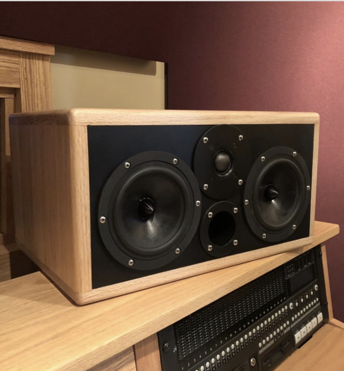

I want to design and build a nice multi way Studio Monitor for my Home Recording Studio. Possibly ending up with a 7:1. But wait....just a Stereo Pair to begin.
Anyway, I was inspired by this little "Mini Rig" (a mini version of the classic main monitors found in commercial studios) I found on Pinterest (Steven Walker; builder):
I have the list of speakers used - there are PartsExpress / Dayton Audio Paper Cone Reference speakers - 6". I could go a little larger (enclosure) - or stick with something this size. Could go Dayton, could go...Fostex! I certainly DO want this horizontal axis. And I definitely DO NOT want rear Porting. But I DO want textile / silk dome type Tweeterers. Just like my Event 2030 BAS - current monitors.

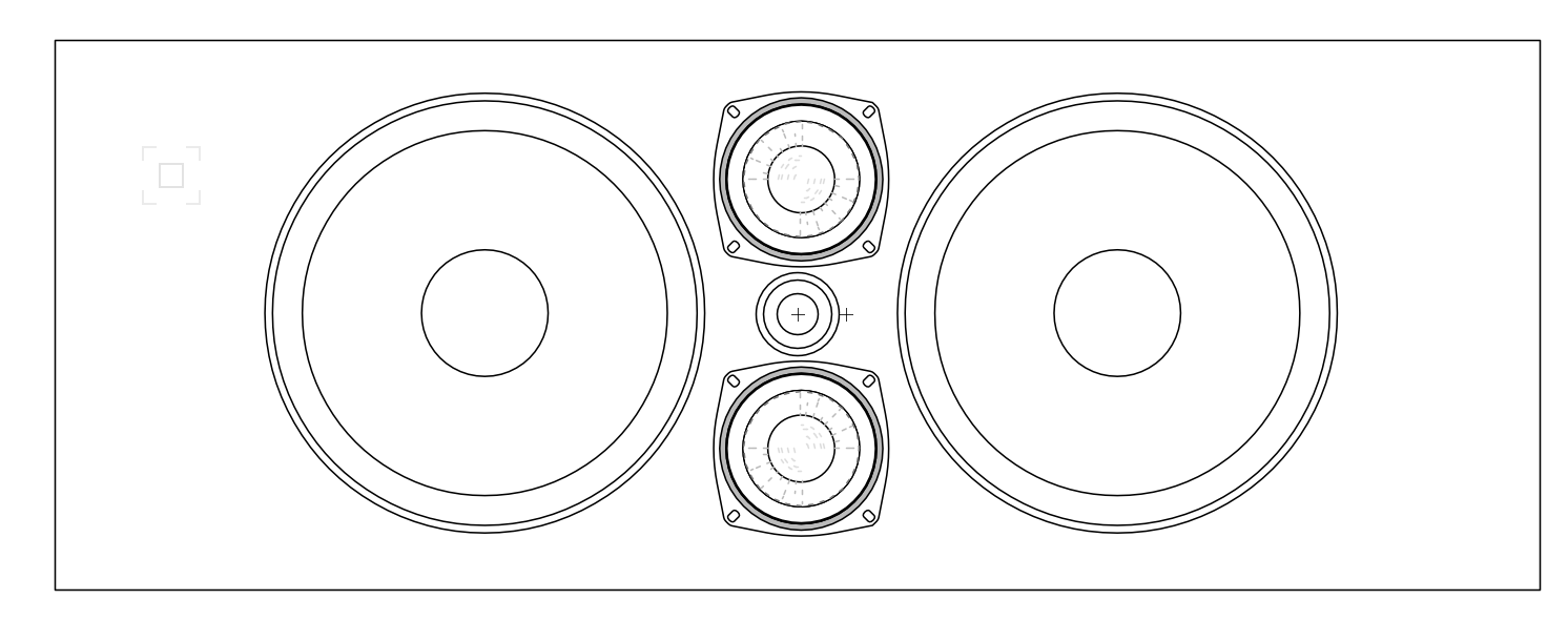

Have looked at the full size versions of these at Wilmslow-Audio: And there is an additional "Mid/Tweeter"...something to think about.

1. Thoughts?
The speaker you have linked to has some avoidable issues like diffraction from raised edges and poor radiation pattern and is perhaps best used as inspiration rather than a guide. If you want a pair of horizontal woofers rather than vertical it strengthens the case for a 3 way with tweeter and mid/s vertically mounted in order to create a reasonable radiation pattern. Counter sink the drivers to avoid the diffraction from the raised edges. Possibly consider a waveguide on the tweeter.

These are for a studio environment - and are not intended as the sole reference for mixing. I have some Vertical 2 way 8" and Silk Domes as well as some full range. The speakers will be on top of a console desk - so hardly optimal in itself - isolated to a degree, but still. The problem with upright/Vertical near fields is that the listening point is only a meter or two - and breathing in will probably change ones perception.
The Speakers are general purpose, The recording console is able to "solo" each and any of the multiple audio channels.
That said - the room will be acoustically treated and the monitors themselves will have a corrective dsp/eq running in the background.
Thank you for your comments though - I d not mean to be unappreciative, because I do appreciate.
PS: There will be a 3 way X-Over of some order going down One of the "mids" will be a Low/LowMid.
T.Xx

I'd like to suggest the opposite orientation of the speakers. I think it would work best to reduce the reflections from the console. So I would like to build a speaker maybe using Neo 8 or Neo 10 style isoplanar mids (radian have bigger ones too, but pricey!) and maybe double verically stacked Radian LT2 tweeters. Behind this mid / tweeter line would be any woofer and box you fancy.
If its really near field only you could actually EQ Neo 8 to nearly 20khz and do away with a tweeter. I've done it, it works surprisingly well near field.
P.s. I know this is not what you said you want. However, unless you must have a low visual line the fact is vertically long mid / tweeter will work better for your console mounting situation.
You might want to look at coaxial drivers if you are less than 4 feet from the speakers. A horizontal layout is not optimal for close listening. Also, if placed on a desk it will have terrible reflections off the surface, go vertical if at all possible. Sometimes old Tannoy drivers come up for auction on the bay. The 8 inch drivers are nice and have been used in many a studio. Seas makes a good coax too. Just a thought….
