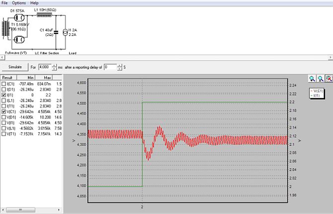

When using a choke input filter after a rectifier, some people prefer a multi-section filter, for example, L C L C: 5h-20u-5h-20U because it should reduce hum more than the same total L and C quantities used in a single section LC filter such as L C: 10H-40U.
Because the critical inductance depends on the minimum current to be drawn, it seems better for overall regulation when the minimum current is small, to use the singe section filter and put all the inductance before any capacitor filtering.
This would be for anode supply of class AB circuits having a low idling current, and in instrument-type regulated power supplies that have a wide range of load current. It should help to keep the no-load voltage from rising so much.
Parts on hand for this project are two 5H inductors and two 20uF capacitors. How to arrange them?

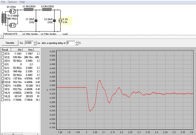

The chart shows data from PSUD for a proposed high voltage supply. The program was run using constant current loads from almost zero to 2A.
It shows that a single 10H choke followed by a 40uF capacitor gives better voltage regulation at lower currents (0.25A) than a two section filter mad of two 5H chokes and tow 20uF capacitors.
I hope this makes sense. I wish I had a 20H choke or higher that would take the current.
LCLC would give steeper slope for noise rejection than LLCC, but LLCC frequency starts lower and has a more predictable behavior.
LLCC would give lower impedance at the PSU output than LCLC, because there is more C that isn't blocked by the L. In fact I wonder if the middle C would even be much useful to the load.
So yea, it's a trade off between noise and impedance. When noise is important and high impedance is no issue, go nuts with the LC train. But for a power supply where impedance matters, stuff as big a capacitor you can at the output and make sure the impedance upstream is low enough to feed the caps without the voltage going all 120Hz wavy.
Anyway I might have missed something, what is the y axis on the graph? Voltage? How are you measuring the voltage: peak or average or?
